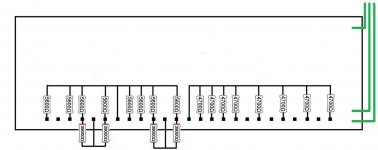

Hi,
After having the beeping red man for a year I decided to sort it out.
I have run the diagnostic software on the issue and cleared all the faults but one by cleaning the contacts. The last fault was with the OCS. I felt some lumps and bumps on the passenger seat so managed to remove the OCS using the guide from deckchair. The mat had become folded and som eof the contacts had interlaced. I flattened it out and plugged it back in, and it cleared the fault. The mat would pick a "passenger" whenever I put pressure on the mat. So I decided to glue some card to the mat in order to keep it flat. After the glue went off I checked it before I put everything back together. And there was a new fault.
32 - Passenger weight sensor - Unknown/Internal error - present - 5
Arghh I had it fixed for an hour!!!
Now the car thinks there is someone in the passenger seat no matter if there is pressure on the mat. Oddly though it says there is a passenger when the mat isn't even connected.
Has anyone had this problem? Is the fault still in the mat or is it somewhere else now?
