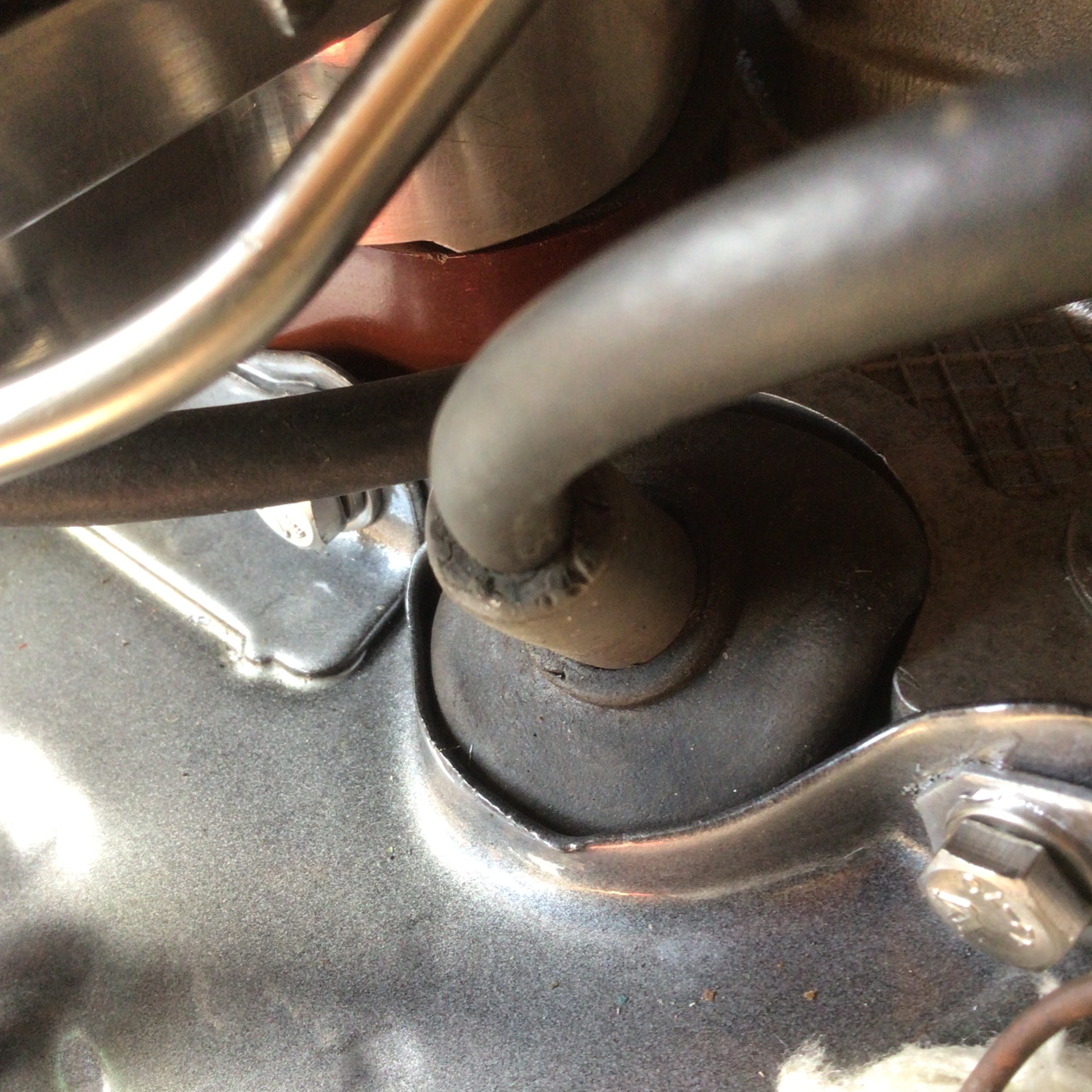

@Toshi 975 ok, I've ordered some. Which way up do they fit?
When you fit the plug-lead covers/grommets onto the ignition lead you will notice that one side is lower than the other---the low side tucks under the shrouding and the high side tucks under the edge of the cylinder head.
Hi @Toshi 975 - my rubber grommets have arrived but I can't see how they fit, because there are sheaths on the spark plug leads which are way too big to fit through the holes in the grommets, and if the grommets are pushed down on the plugs it pulls the grommets through to below the shroud... Could you post a pic or w of what they look like when fitted?

Simon, I think you need a pair of the original plug extenders. You remove the threaded nipple from the plug and these things screw on in place of them, extending to slightly above the hole in the shroud. Then the rubber cover fits neatly over the top and finally, the plug leads fit on the top of the extenders.

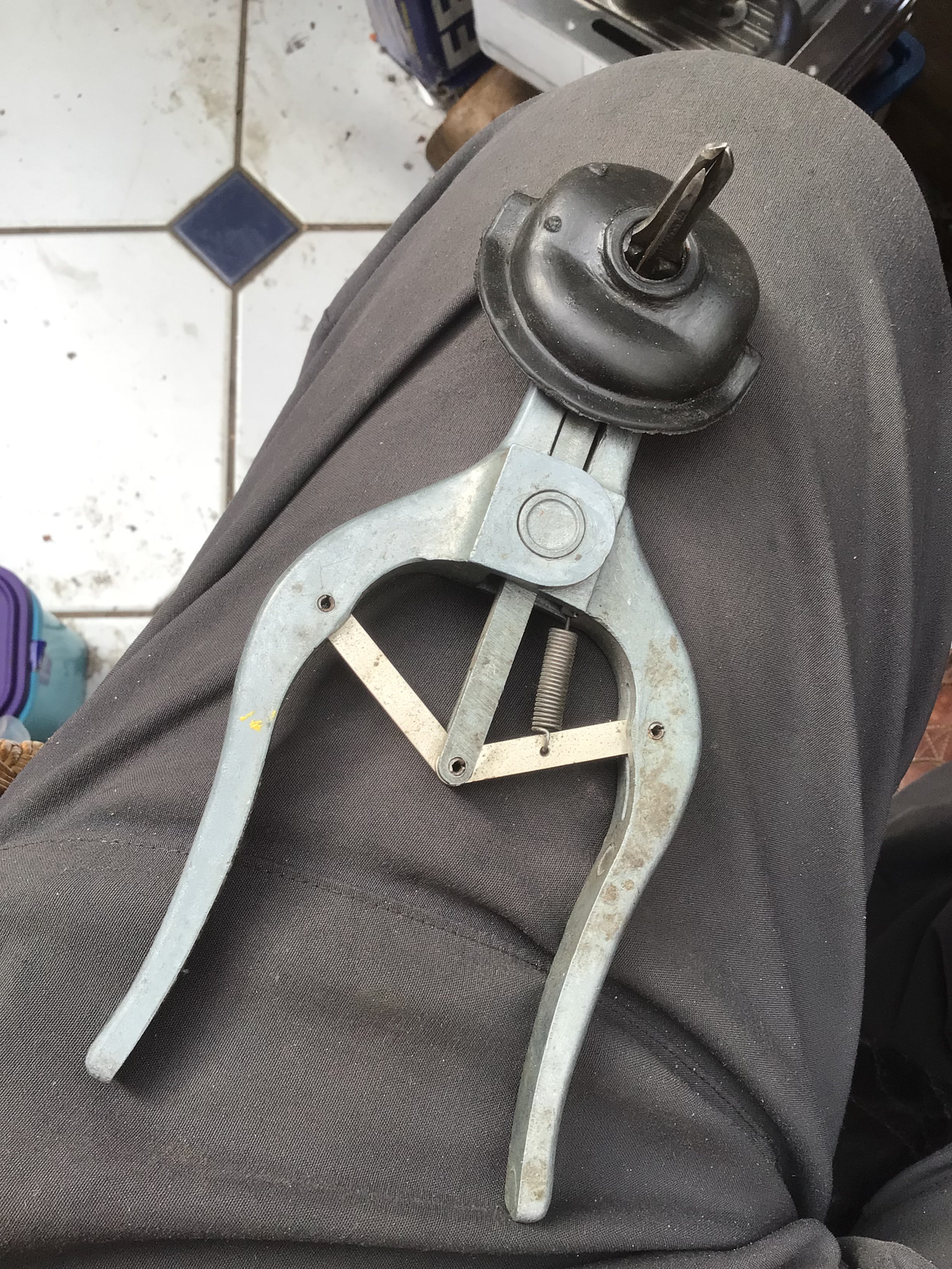

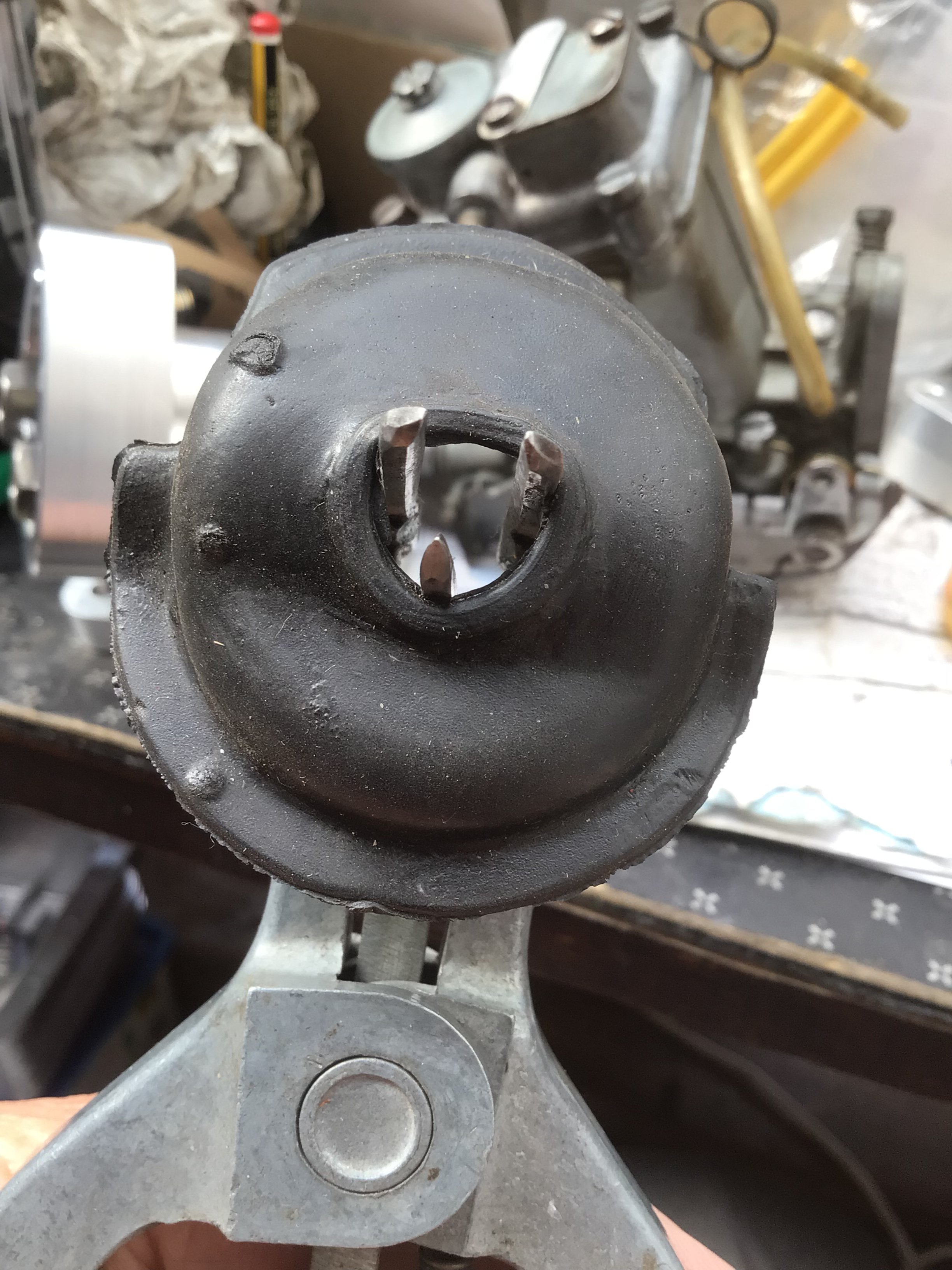

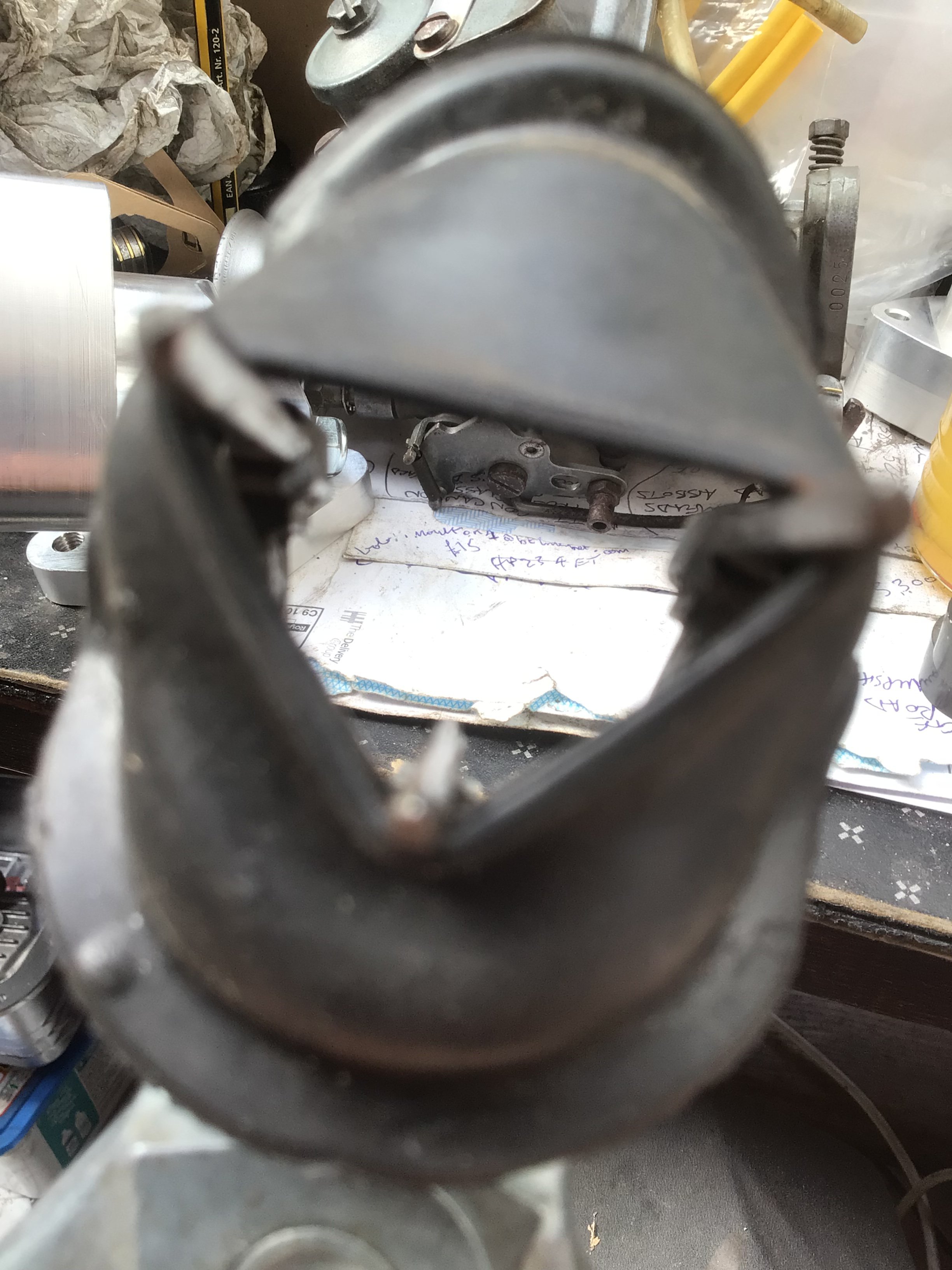

When working with HT leads and associated rubber boots etc a little squirt of WD40 really helps the parts slide. I also have a special tool that helps as well.

Job done - rather than trying to stretch the covers over the HT lead rubbers, I made the holes in the covers bigger by putting them over the end of a piece of metal tubing of suitable size and bashing with a hammer to make a nice neat hole. Now they just slip over the HT ends with a slight grip, so ideal!
