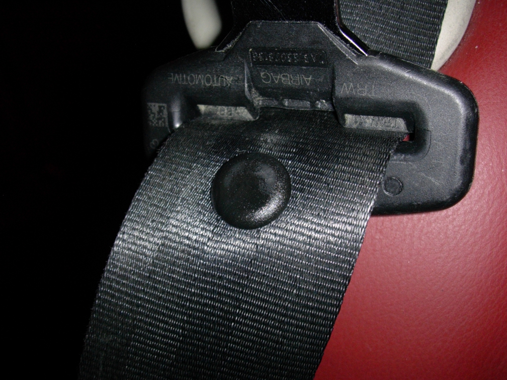

Hi been reading through this forum since I bought it last year but first time I've posted. No real complaints really but since this is the first car I've had in years ( stopped driving years ago...old car was an n reg fiesta diesel...) I never got a manual with my 2015 500 s, so have had to Google pretty much any query I've had! One issue I have is I struggle to fish my seatbelt out from the side of the seat and I'm hardly hanging over the seats size wise! And also the fact that my indicators tend to not work occasionally they ping off and I have to repeat til they stay on lol I've spent over £1500 on repairs on it but it's the car I've wanted to get for years and finally scraped enough cash together to buy one. Anyway sorry for ranting in a long winded way of saying hello and thanks for the help!

Seatbelt fishing? Is it retracting properly?

It is but for some reason the clip part is always down the bottom lol I'm just unlucky I suppose, I tried 4 times sitting at traffic lights keeping my indicators on to turn right gave up in the end, mind you most people in my area don't know what indicators do anyway lol 😂
Is it possible you've lost the 'button' that prevents the clip sliding right down the belt when retracted?

Yes it is. It's a 30 second job. The things can be bought in packs of 10 on ebay for a couple of quid. They come in two parts, push one part through the hole in the belt where the original was and push the other one on the other side. Compress with a pair of pliers to squeeze together, job done.

Ordered some thanks very much I feel a right idiot since it's something so easy lol
