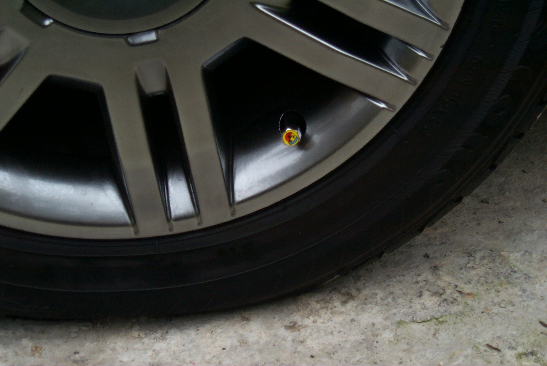

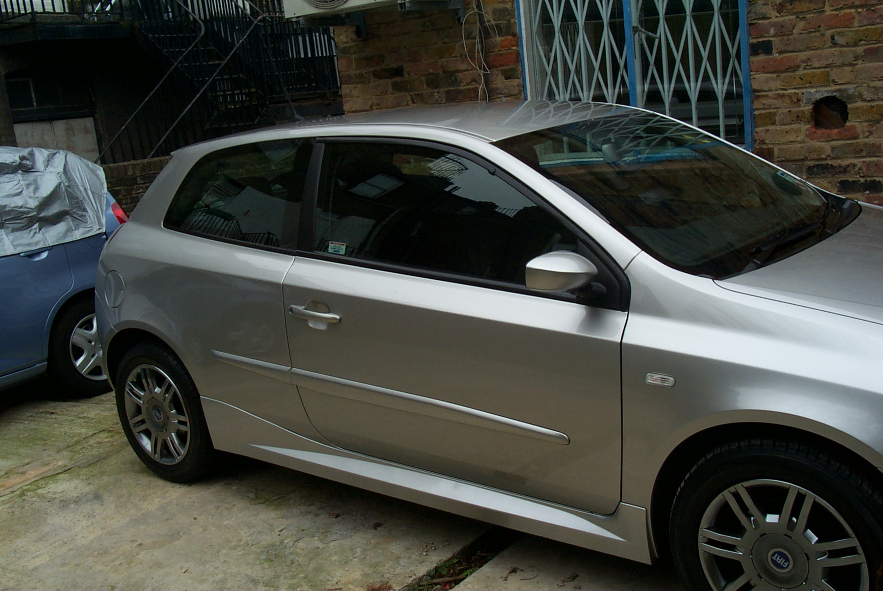

P.S found some nice valve caps to finish of my wheels, check out the jpegs.
