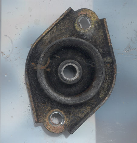

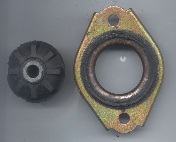

Could be a [edit: rear] suspension upper mountain has ripped through like mine (attached) replaced with a temp one from scrap yard till new part comes in (£8.88 + VAT from FIAT). All the ones in the scrap yard had all started to go so looks common?
Regards,
Louie Bee.

The situation from the pictures above shows some real Fiat ****. These are prone to selfdestruct. I remember feeling a "thump" AFTER every speed bump.
Morten.
Strangely enough I have just cured the same problem myself today (the mountings shown above) and this was the third different Uno in a couple of months!
I recommend that everyone open their tailgate, pull off the black plastic shock top mounting covers, and try to 'waggle' the top of the shock spindle by hand. Then bounce twice on the rear ledge and watch for movement. A centimetre or so, up and down, is normal (the rubber is soft). But jerky movement, perhaps with squeaking noises, or side-to-side, is self-explanatory.
Usually I find the rubber breaks in a ring around the central boss, rather than completely separating from the steel as shown!
I'm impressed with the new price quoted... I only ever tend to use second-hand bits...
And make sure the nuts holding the mounting on are tight - I have had the mountings to the body work loose before.

The temp replacement mountain seems to have fixed the loud knocking (about 30 speed bumps to get to work and back). Now I’m back to just rattling exhaust and heat shield (not so bad) along with a new little squeak. The squeak I presume is the replacement mountain which starting to go. The small tare is underneath can only be seen after removing the part.
I posted in a bit of a rush, and without thinking it through liked my low front-end problem to the possibility of having turbo shocks (to stay on original subject). Maybe the car has been lowered in the past, or has accident damaged, or perhaps just because it’s a MK2?
The above price is for one mountain, but still only just over £20 for the pair. Better than £70 + VAT for a new pair of FIAT shocks (which I assumed was the problem but didn’t order).
The temp one was under £1 as I went “bit picking” at the yard. For £5 I also got a central switch bank, an oil filler cap (old one too loose), brake and clutch reservoir caps and air filter box rubber “feet”. New switch bank (no crack) lights up, and I refitted the fag lighter’s bulb (found rattling around inside dash).
