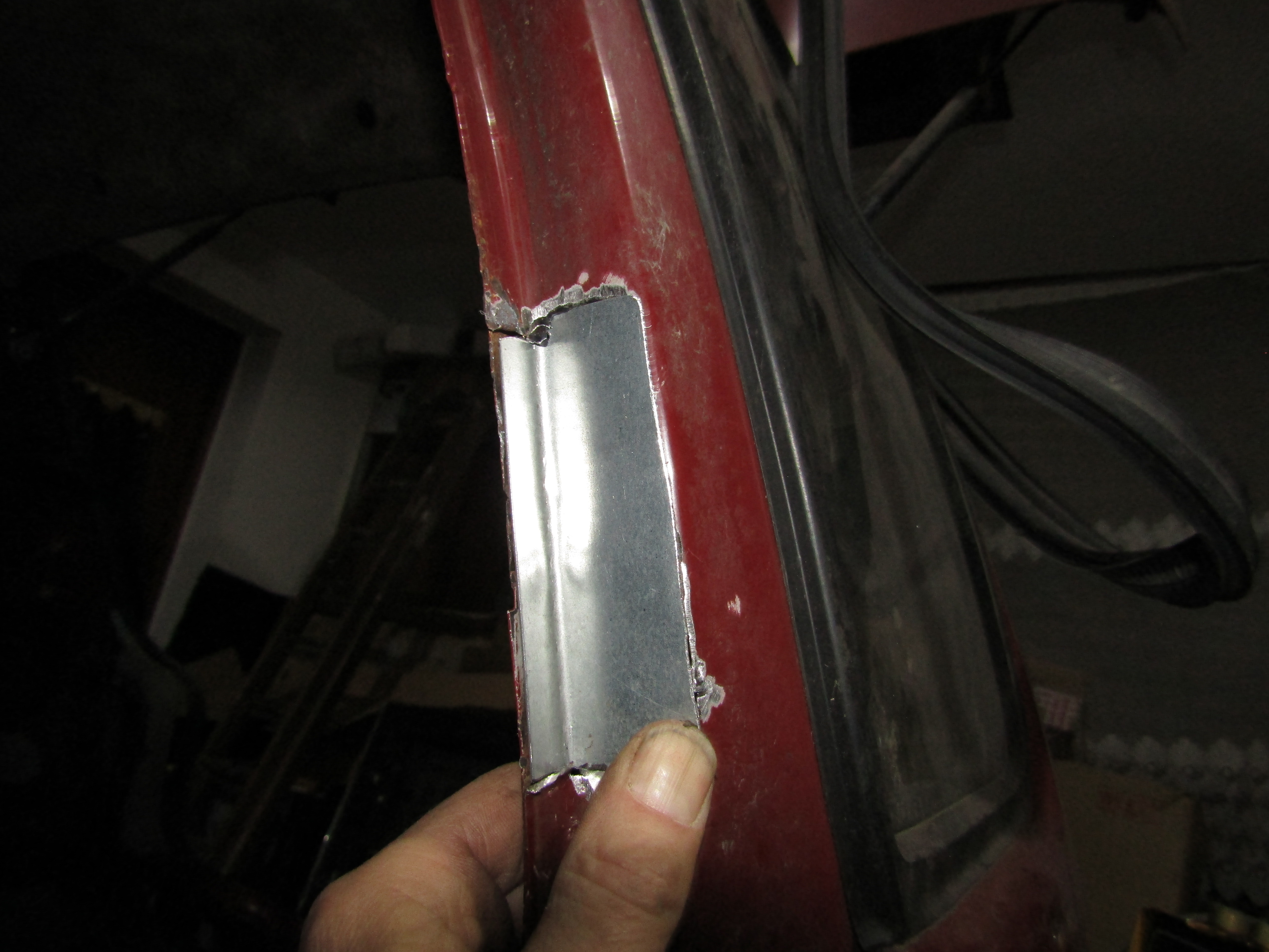

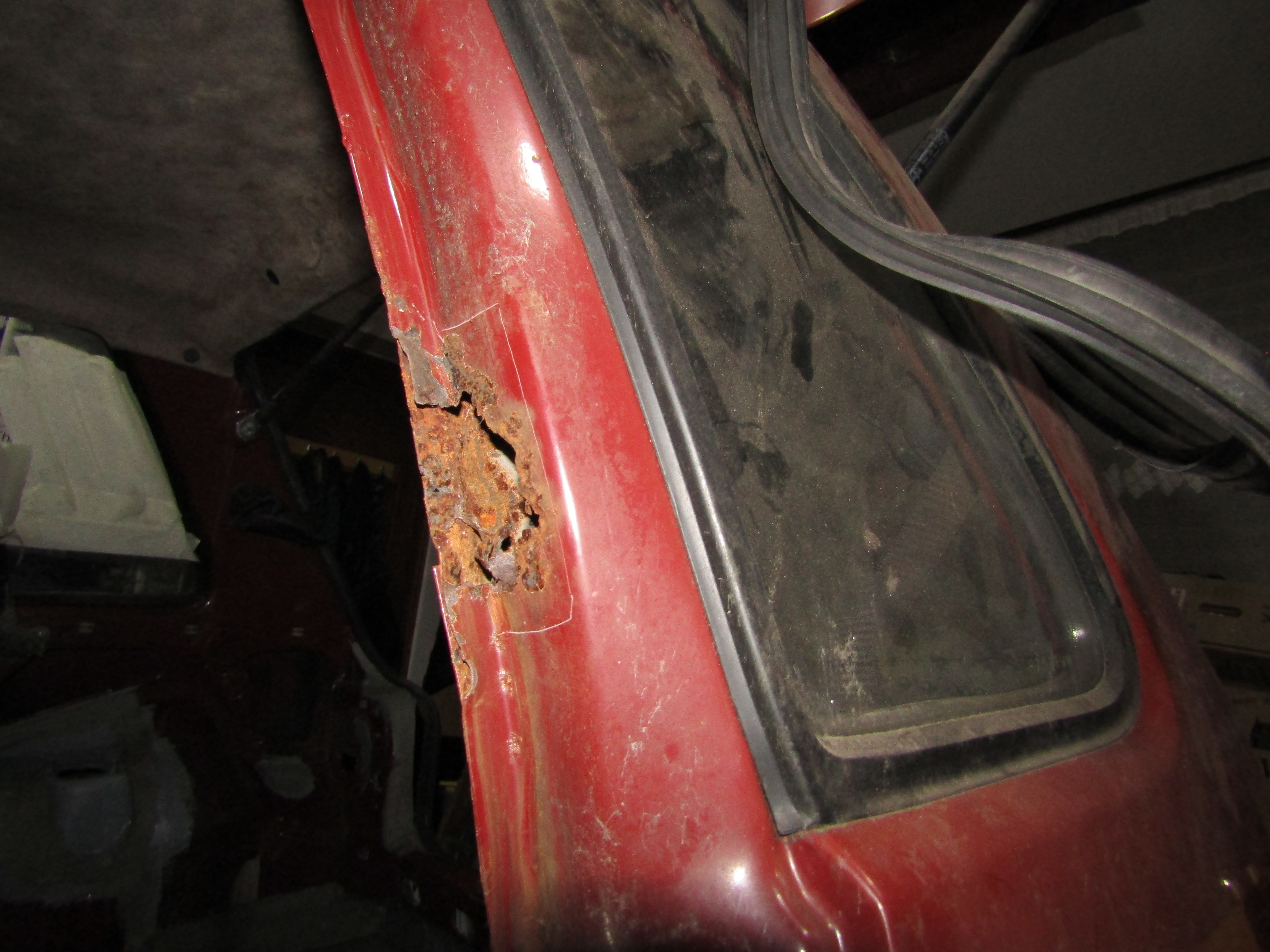

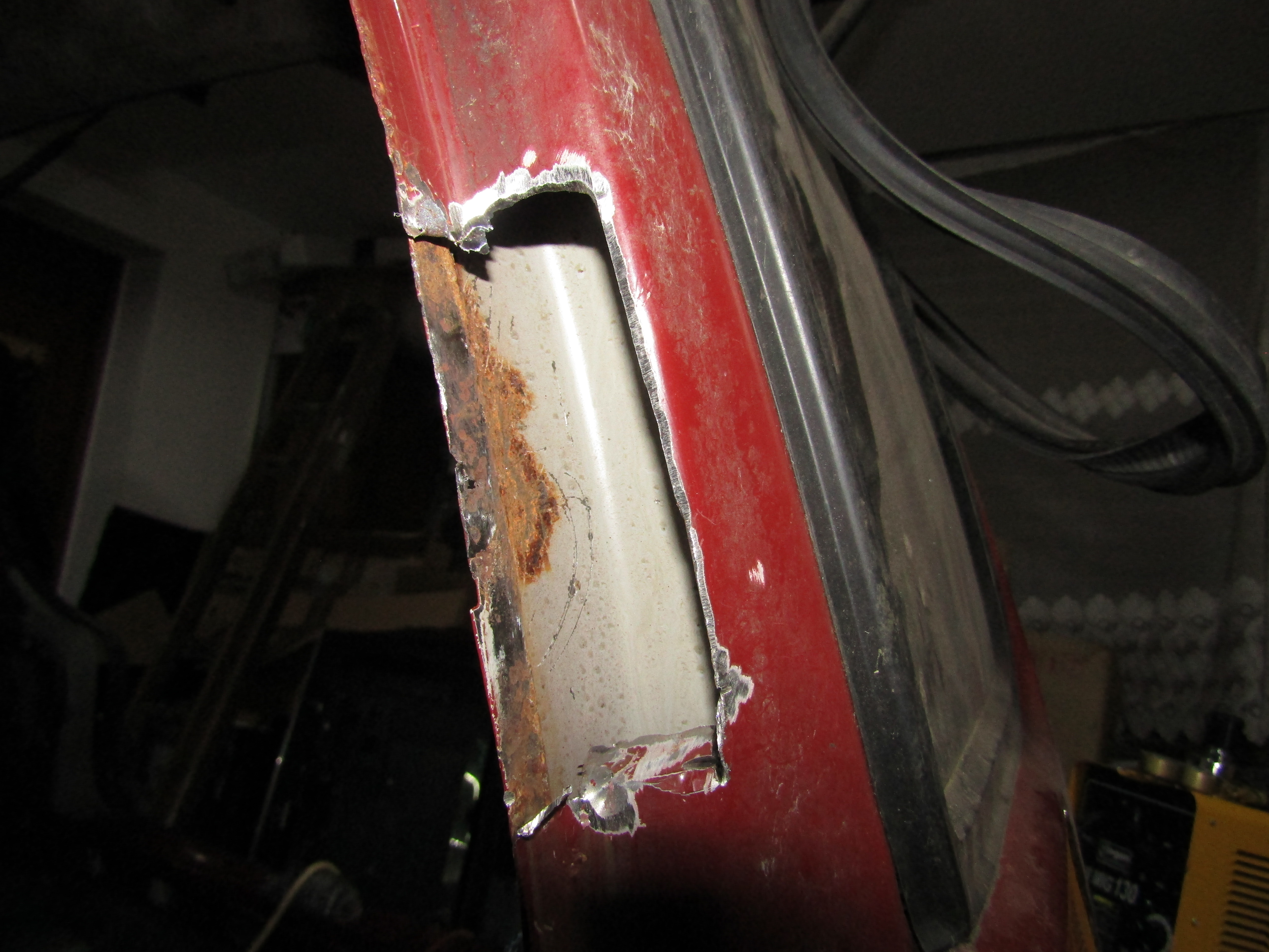

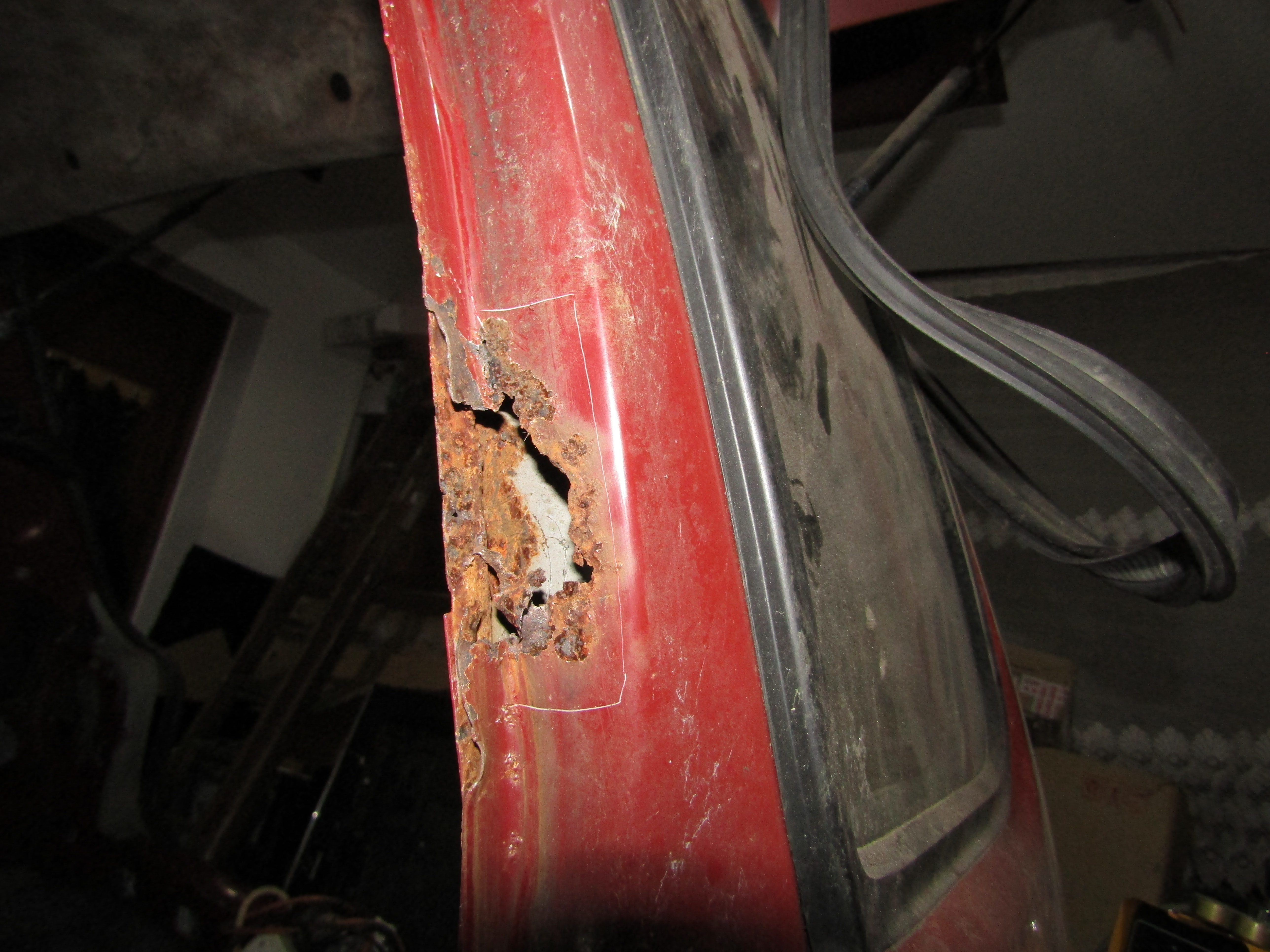

Managed to get the back door open that was seized closed and found a bit more rust, no surprise there then !

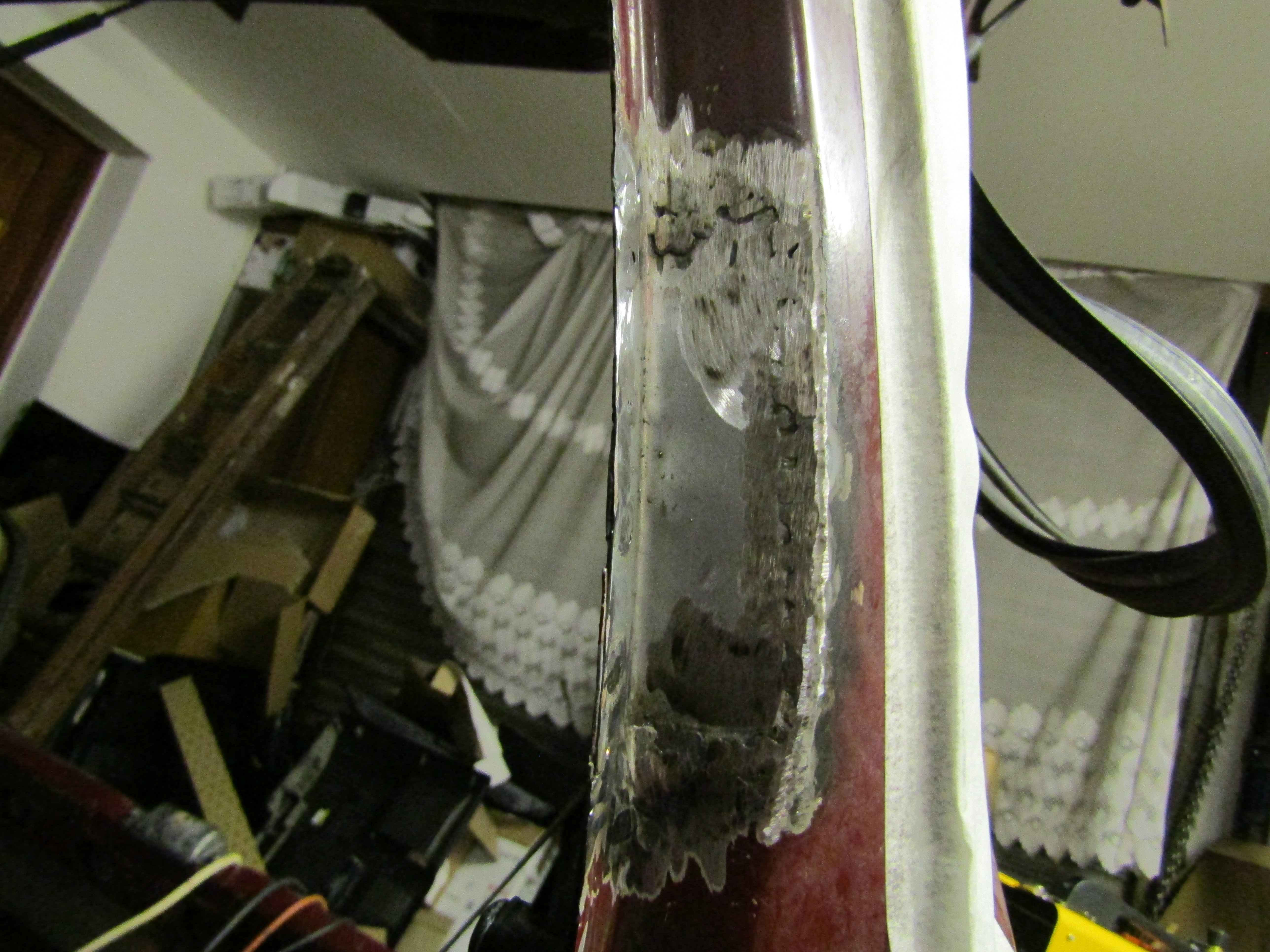

welded a piece in , a quick skim if filler and the repair will be invisible as I a used a joggler to put a lip into the panel and welded it inside slightly lower than the surface to allow for a skim of filler.
Found some more rust near the roof as well.

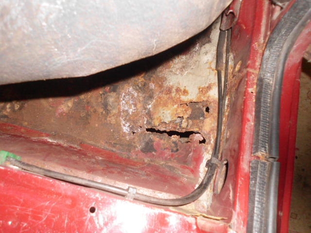

Still plodding along !

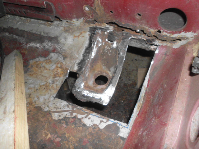

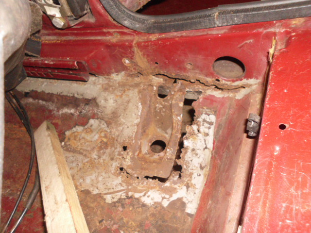

had a look underneath and the drivers side rear jacking point looked a bit worse for wear, lifted up the rear carpet and found a bit more rust, soon had it cut out,ground back to clean metal ready for welding.
