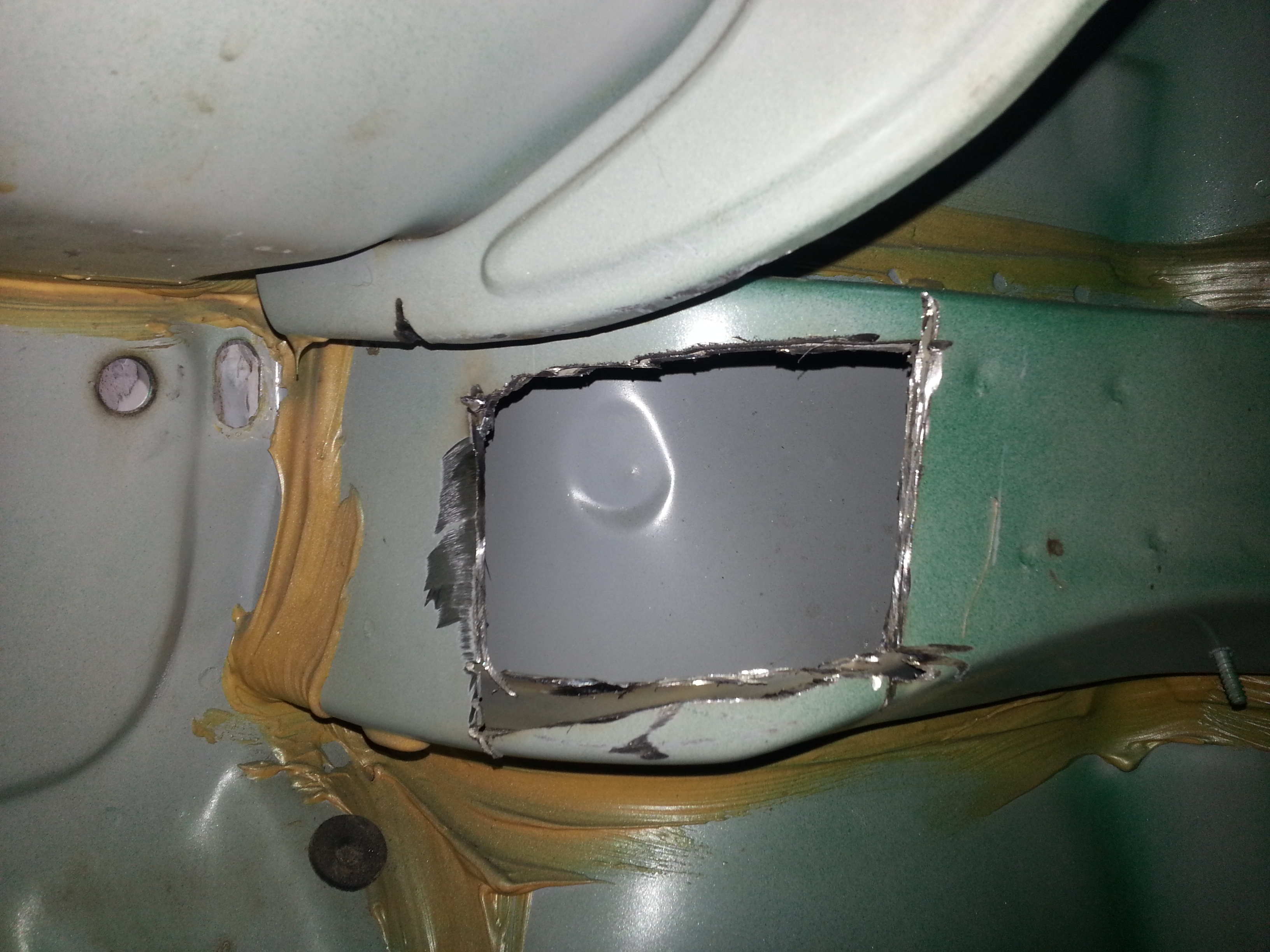

the green beast is looking more open to access now :eek:. update on the engine to frame im saving for it to be done professionally only 500 ish they do alsorts plus its just down the road :slayer: my mate at work said he could gas weld it but im not going to trust that to much

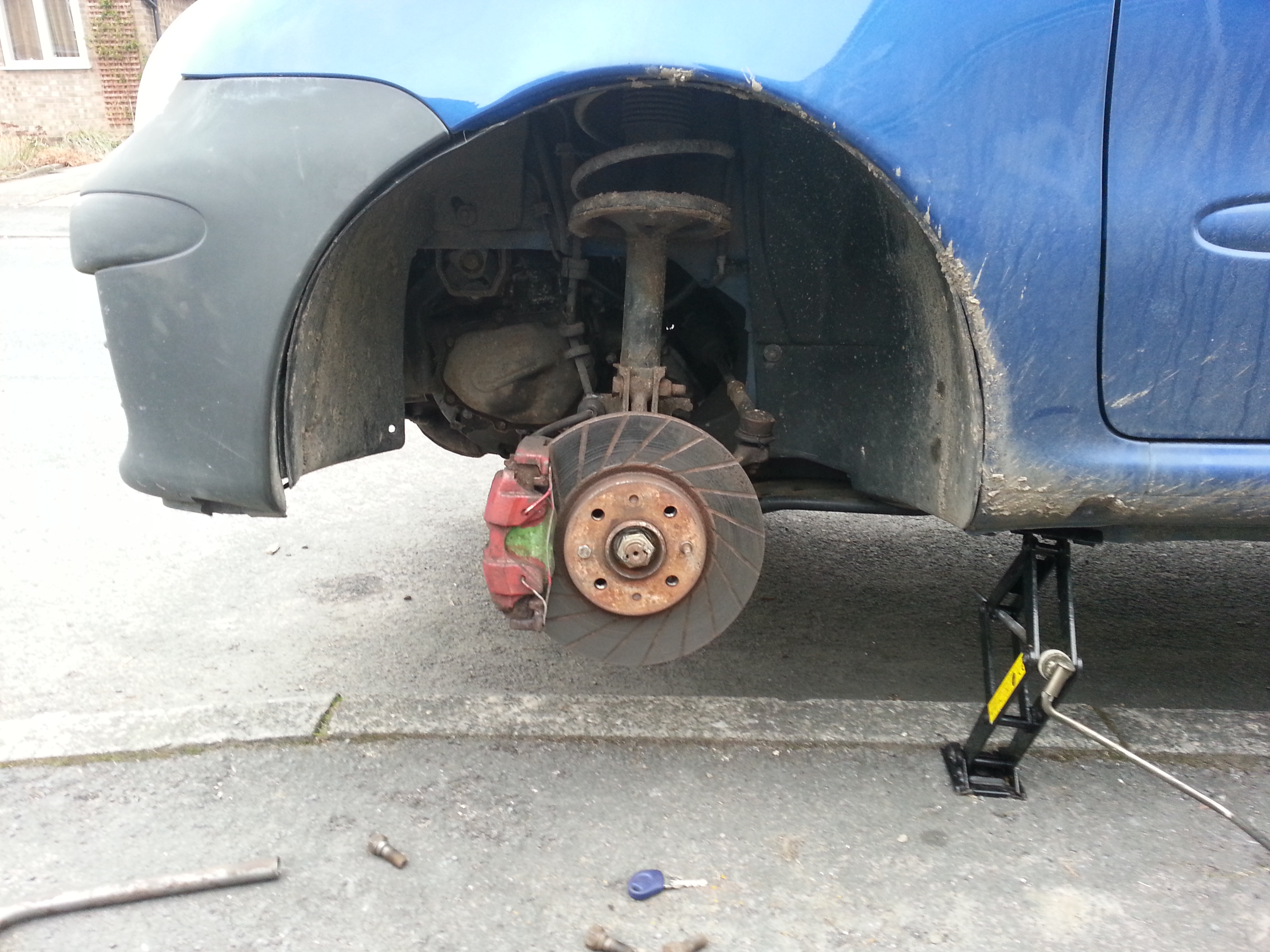

hear they are on the clean as hell sei :p
the arb rubs slightly when jacked up on full lock the tie rod end skims of the inner wheel weights ( replaces with adhesive ones ) so a 20 mm spacer wouldent go a miss but other than that its all good (y)
oh and i know about the jack leaning the wheel is under the rear wheel chocking it
surely the UnoT calipers can be found on something else, not something i ever looked into tbh but it would be so random if it was a single car application really.
If we are honest though, 13" wheels on this car will just be silly, i know you want to to look stock and stuff but i'd be considering stilo 15" steelies even with that engine in there.

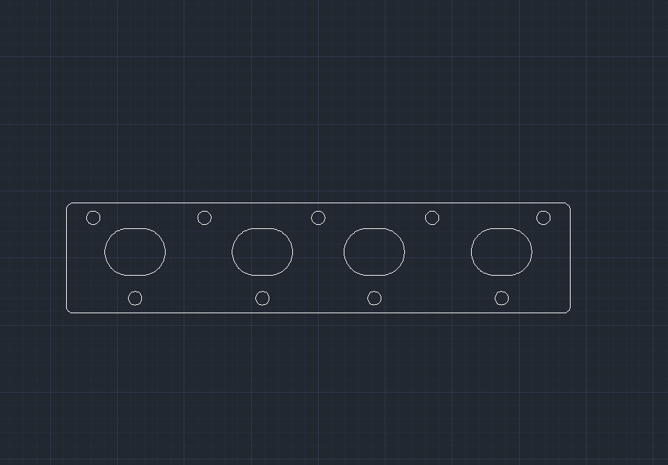

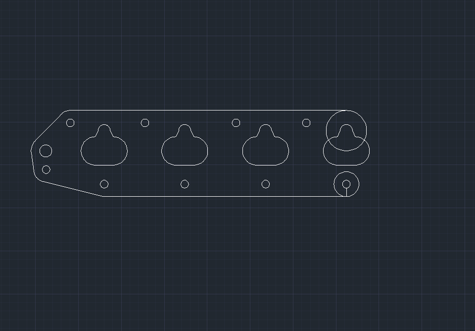

so on free time i thought i would create a CAD file for the new intake flange for itb mounting so it was dark in garage (takes a while for bulbs to get warm) and grabbed a 3 layer gasket made a cad model of that with slightly thicker edges happy days. turns out that was exhaust manifold gasket :eek: oh well so the gasket from the intake is broken up so the hole massive intake came inside :eek: anyway after making half the model tonight (takes time not one equal distance between points :mad: but got both manifold flanges in a auto cad file (y)
hear is the exhaust one

and the unfinished intake

got a friend of a friend coming one weekend supposed to be amazing with a mig welder :worship: plus i have spare steel for plating and bracing from that rs4 subframe (y)

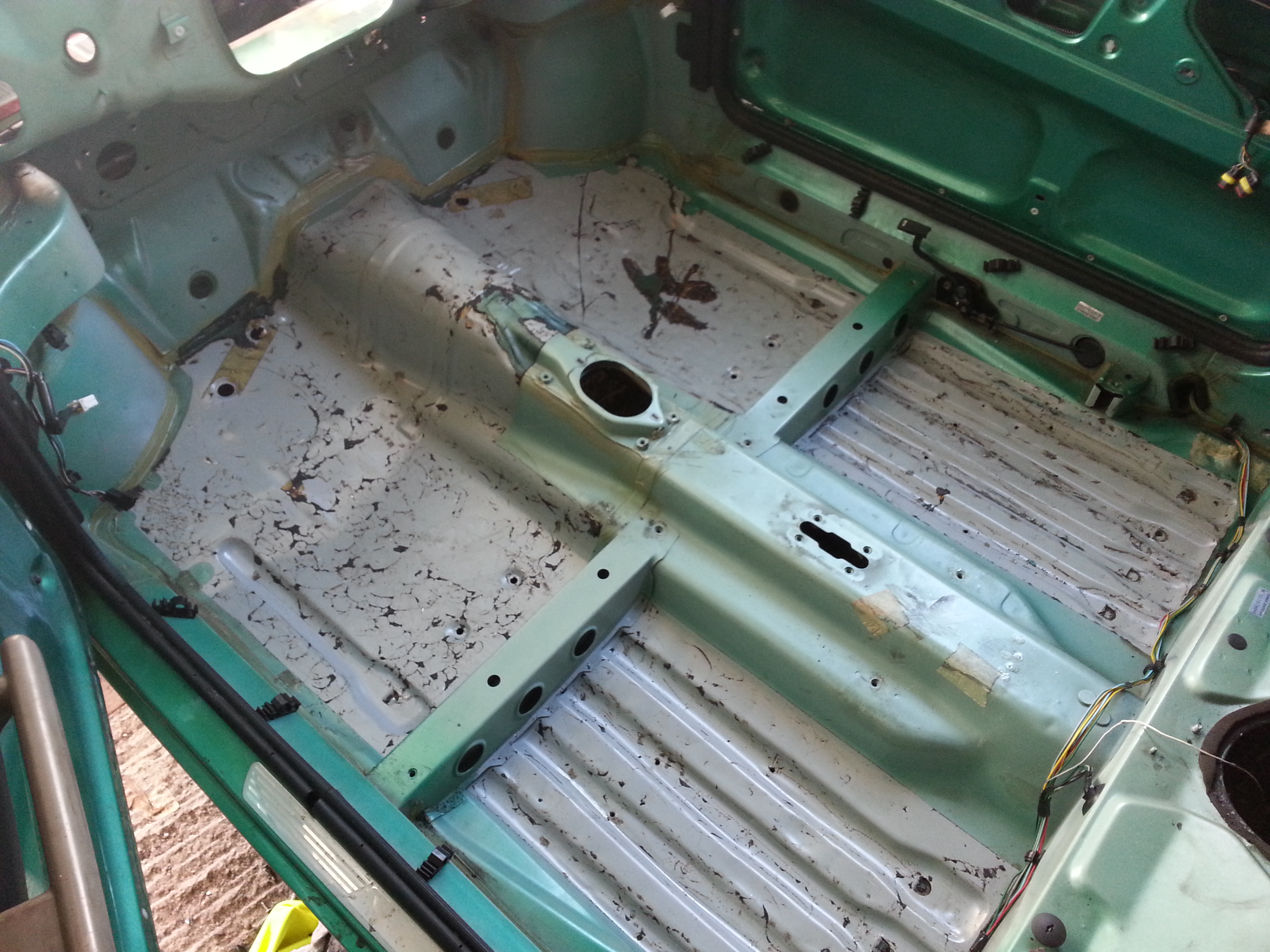

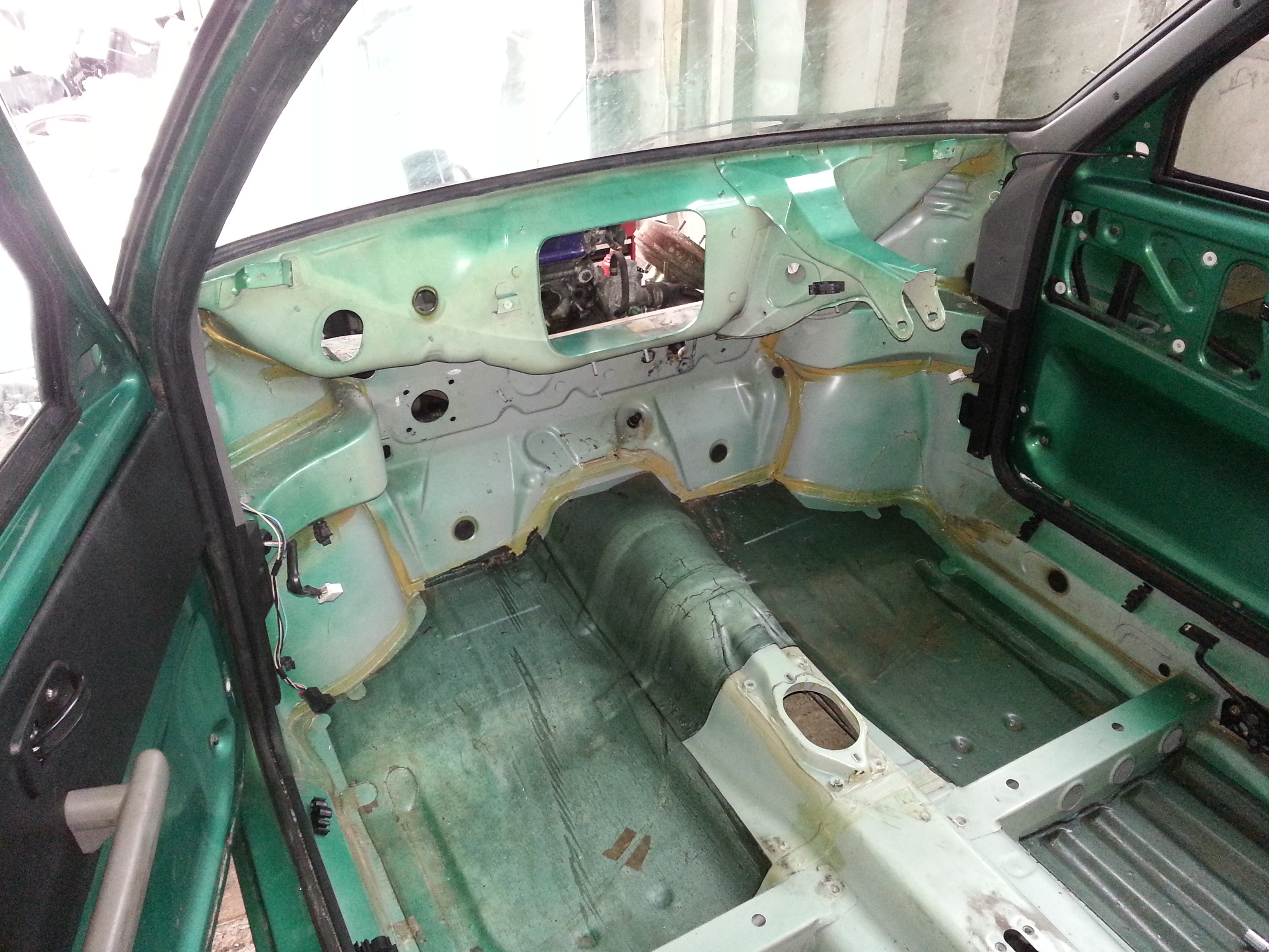

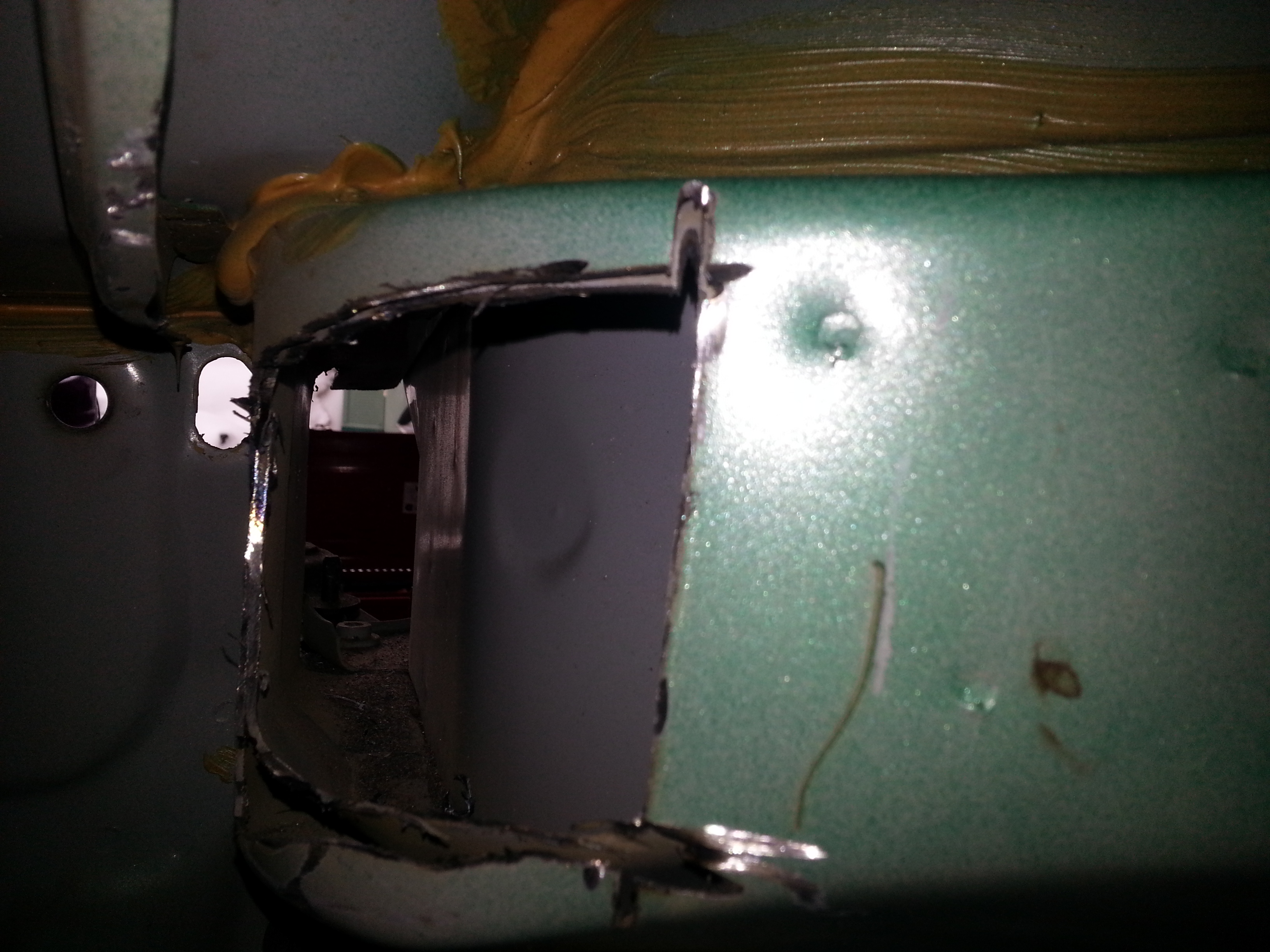

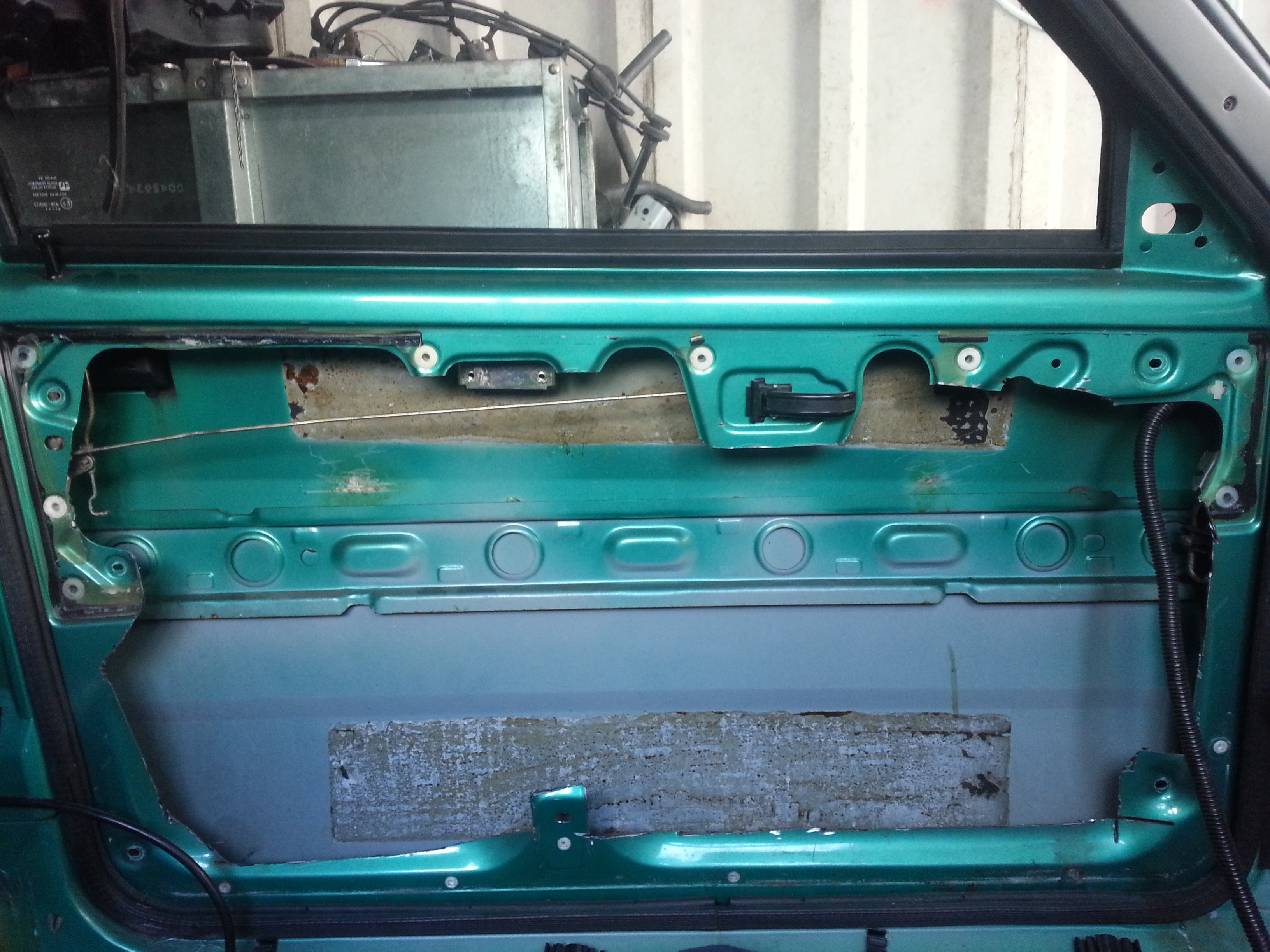

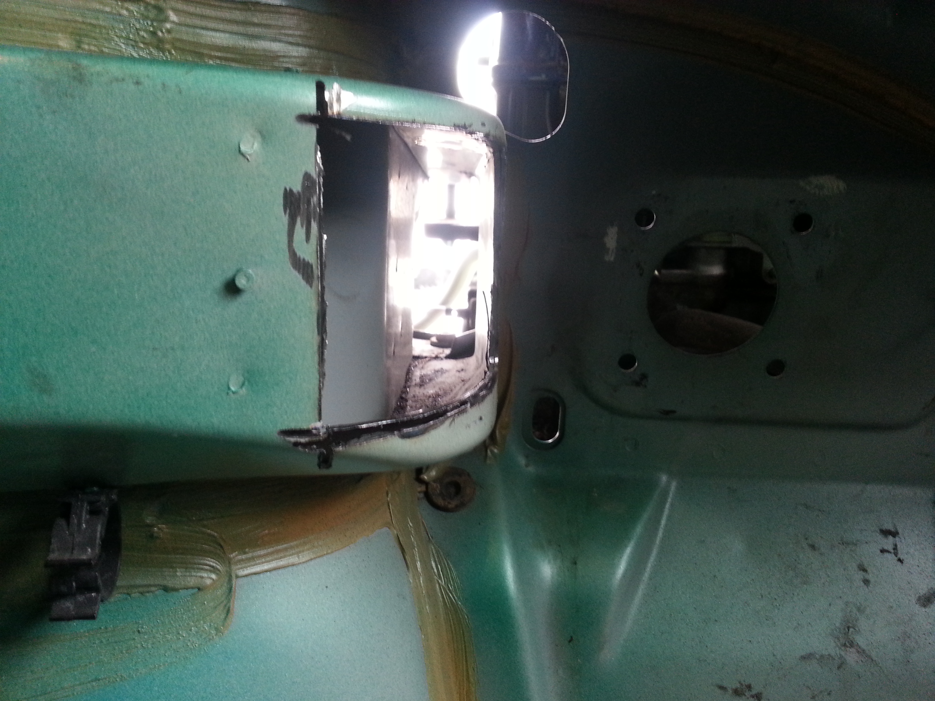

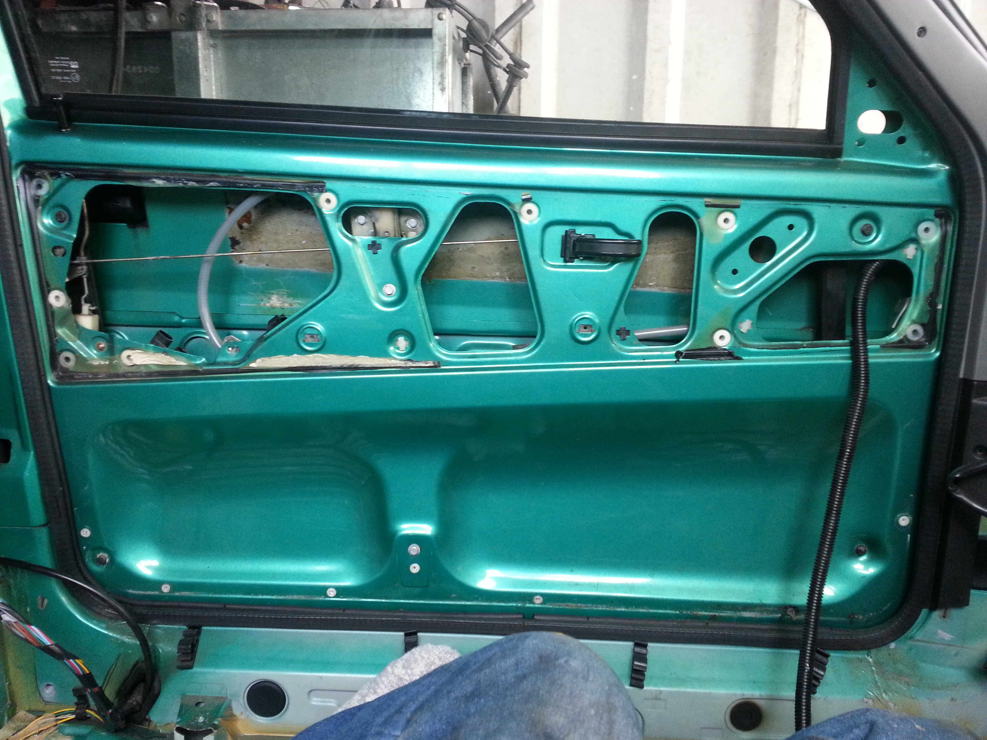

so hear is the video of the removal :)
total weight loss 3.9 kg
oh and bit more waight loss :eek: removed winders from the sei to put in this and the electric actuator from this is in the blue sei all wired up and working well may i add (y)
the entire door will have either a thin sheet of alloy or carbon fiber installed (y)
