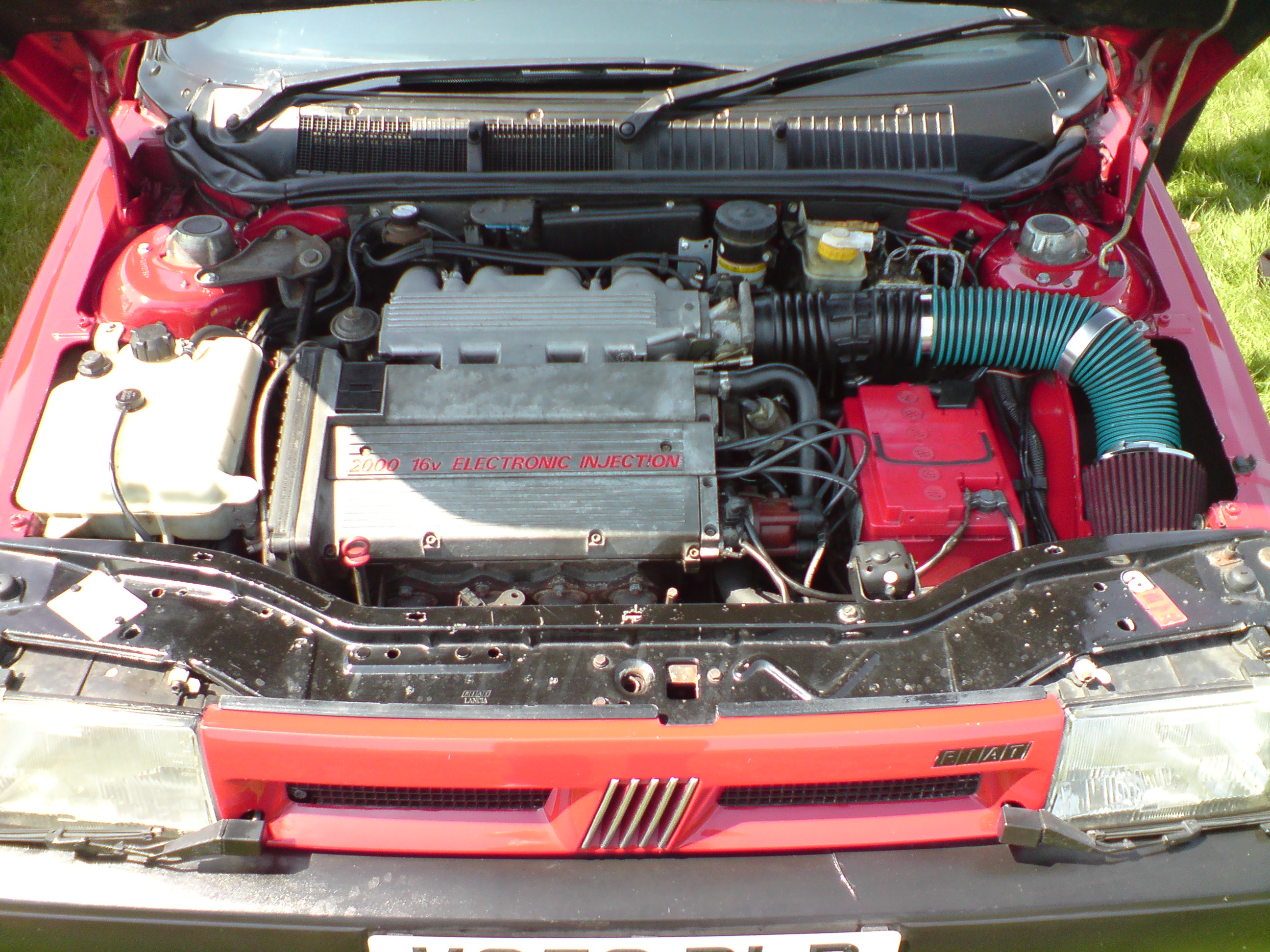

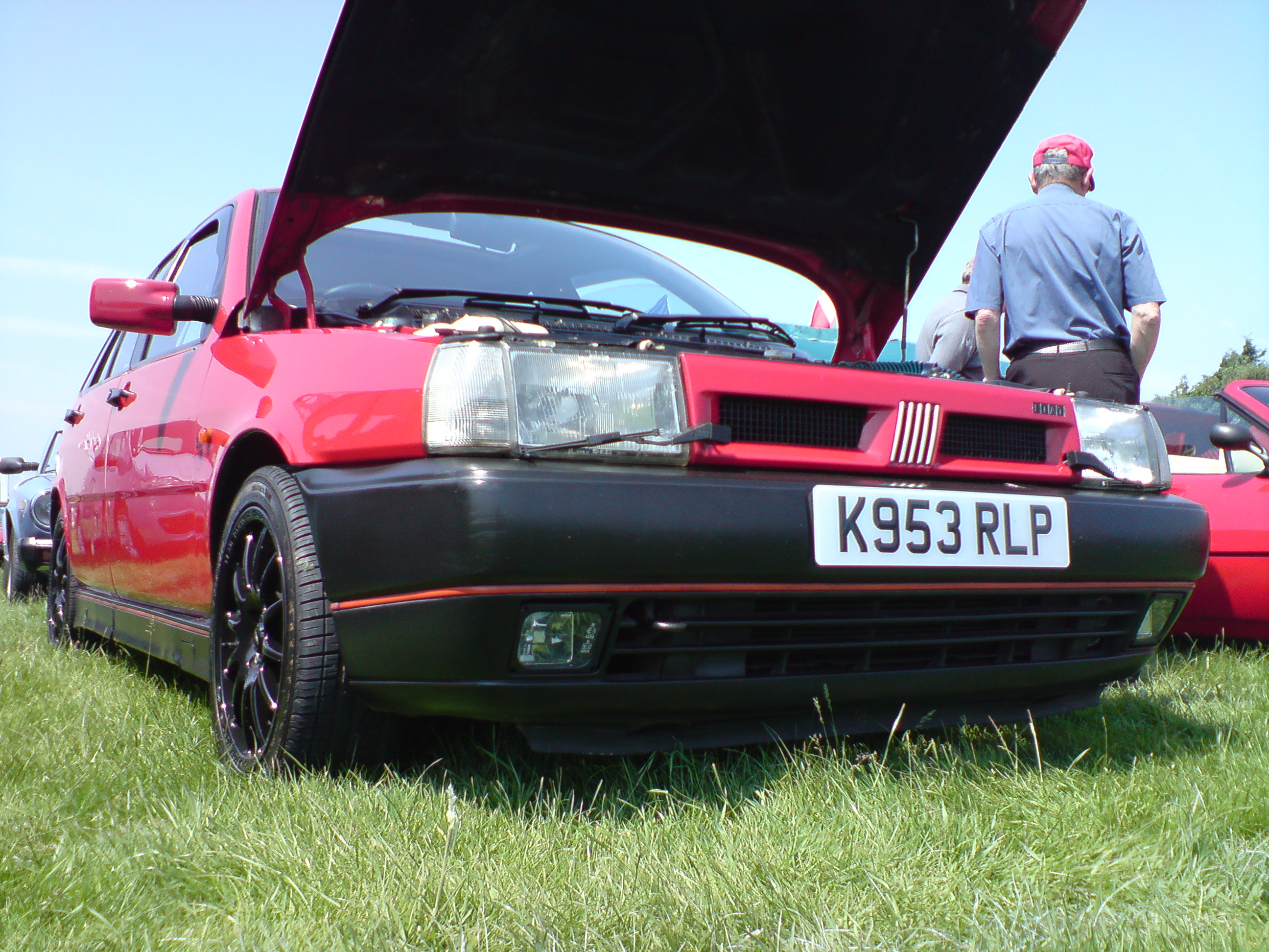

My 1993 2.0 16v tipo had it a year and omly done 63K genuine miles. Its got a de-cat pipe and sports backbox and soon to be lowered and chipped with a re map
looks nice.. the alloys really suit it
tho get the induction kit sorted that hose and position wont be doing nowt but zapping power when you get some heat under ur hood!
Its true Rich. Induction hosing should have smooth internals, which this one doesnt seem to have, plus hot air rises so this will get warm air at some point. I used to have a similar set up on my Bravo thinking that it would be fine as it was down the wing. But slapped a gsr kit on ( sits bottom of engine and smooth hosing ) and it gave me 17bhp more. Just goes to show what a good induction set up can achieve.
