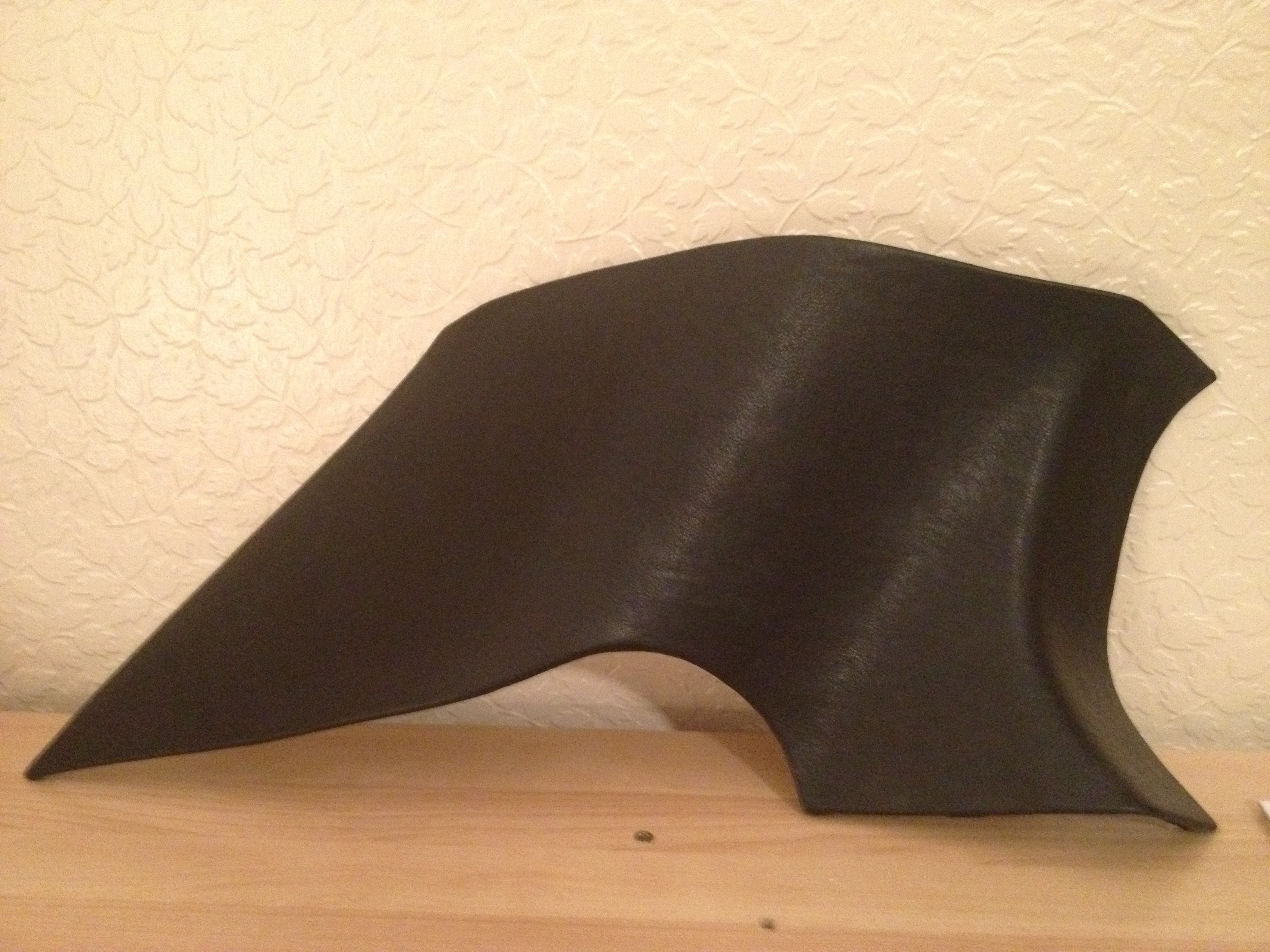

Started to do the c pillars tonight, decided to split the main panel from the part where the seatbelt goes in. Makes it so much easier to wrap and then just going to stick them back together when ive done.
That looks lovely! what you mean you split them? (going to have a look tomorrow see if i can find out what you mean :p )
is this the same as the B pillars just pull and pray lol?

Thanks I'm going to have a look tomorrow! I move house tuesday so wont get anything like this done till the following week i think!
No worries mate, also you don't have to split the panel like i did, just wanted to get a nice edge and the side that they meet.
