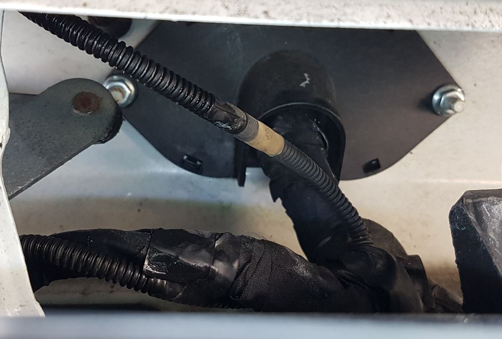

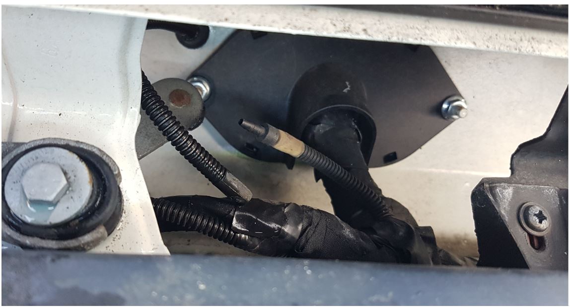

Hi Everbody,
Recently had this problem on my 63 Panda just early spring.
I think this is what happens.
When you get a deep freeze outside, the hose that connects to the back of the car freezes. When you try to spray the rear window the back pressure forces off the joint.
The symptom is that your front washers work but the back ones don't.
The actual fix takes less than 10 seconds. To push the hose back on to the connecting spigot. As usual in modern cars there is some dismantling to get there first - takes around 20 mins to disassemble and 20 to assemble.
Don't forget the most important tool - patience!
Anyway here are some before and after pictures.

Is that inside the tailgate?
Sorry,
I meant to add additional information on how to dismantle the vehicle but it sounded confusing.
This is at the front of the vehicle and access is by removing the wipers and lifting up the plastic cover. The pipework is in the well underneath.
To get at the wipers you need to remove the plastic covers. These have a tab on the left, so pull gently on the right where the fixing stud is.
The wiper nut has a black plastic cover on it - gently prise this off.
You then need to remove 3 plastic studs. There are two more of a different type. The two with flat slots in the top have middles that pull up and then they pop out of the hole.
The internal rubber seal needs to come off. Keep this oriented so you can put it back on without getting mixed up.
Removing the plastic shroud is a pain and requires gentle handling.
You will see the pipework in the pictures.
As the tradition of the well known car manuals - reverse the process to re-assemble!
Hi.
You don't need to fully remove the cover over the Plenum chamber or the wipers. It will lift enough to get your hands in and reconnect the pipe. Just remove the plastic securing pins on each side and the middle one and seal, it then lifts enough. 5 minutes tops.
