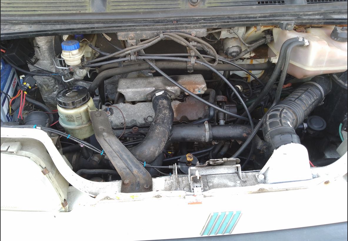

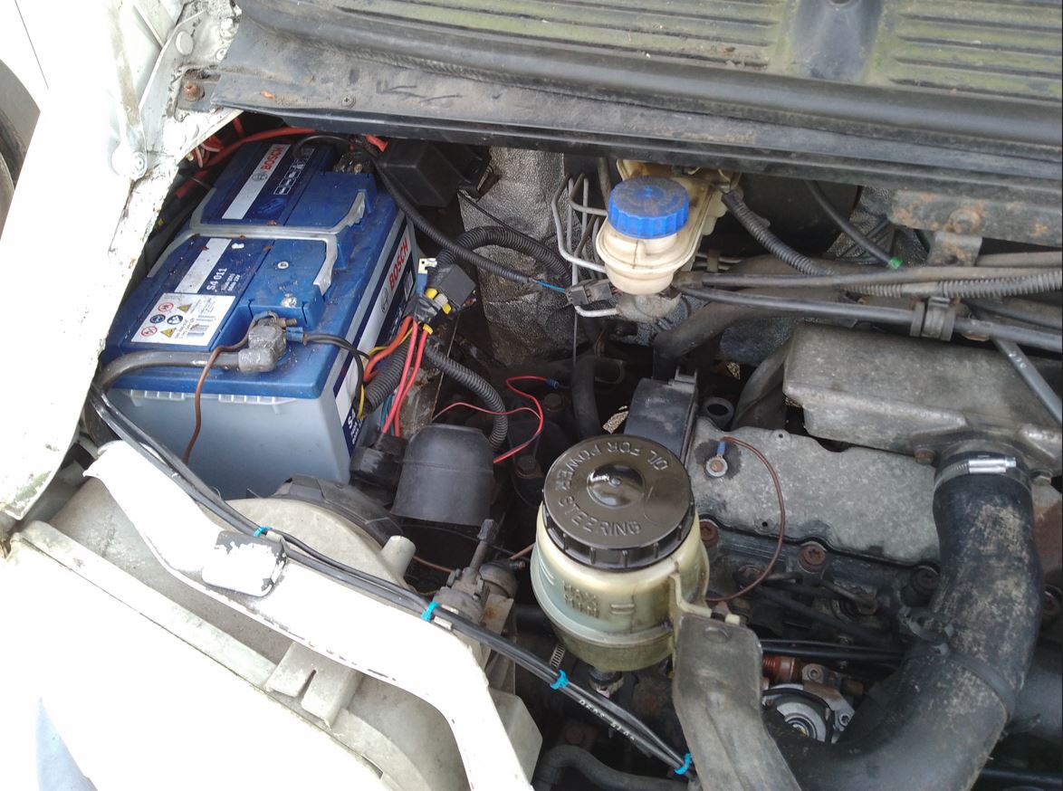

Hello Everyone... Helping...

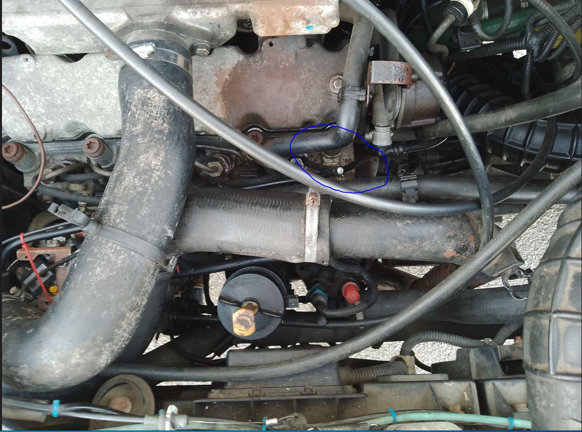

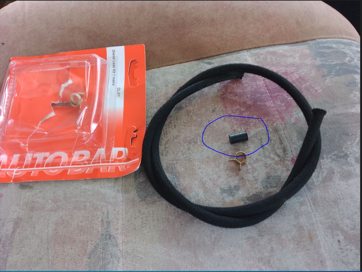

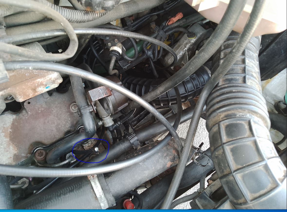

I have taken some pics to show you what I see under bonnet... the "Blue Ring" is my temp repair to 4th injector Bung.. which a new one still leaked..
and so dumped it and connected a piece of new 1mm pipe 4" long onto fitting and then "Spring Clamp" with stainless screw screwed in it tight...
has done the job until I get a 1mm Brass "T" piece so as to cut into 3rd injector to 4th which will do the same job and be stronger...
Lyn...

That is the Peugeot xud9 engine- excellent engine.
Not usually fitted with a lift pump , the injector pump has to pull the fuel all the way from the tank . The smallest pin holes or weak joint in the fuel line between the pump and tank makes for long cranking because the suction on the fuel line pulls air into the fuel. Any problems in the fuel line allows the fuel to drain back to the tank.
Make sure the feed and return pipes are connected the correct way round at the tank!

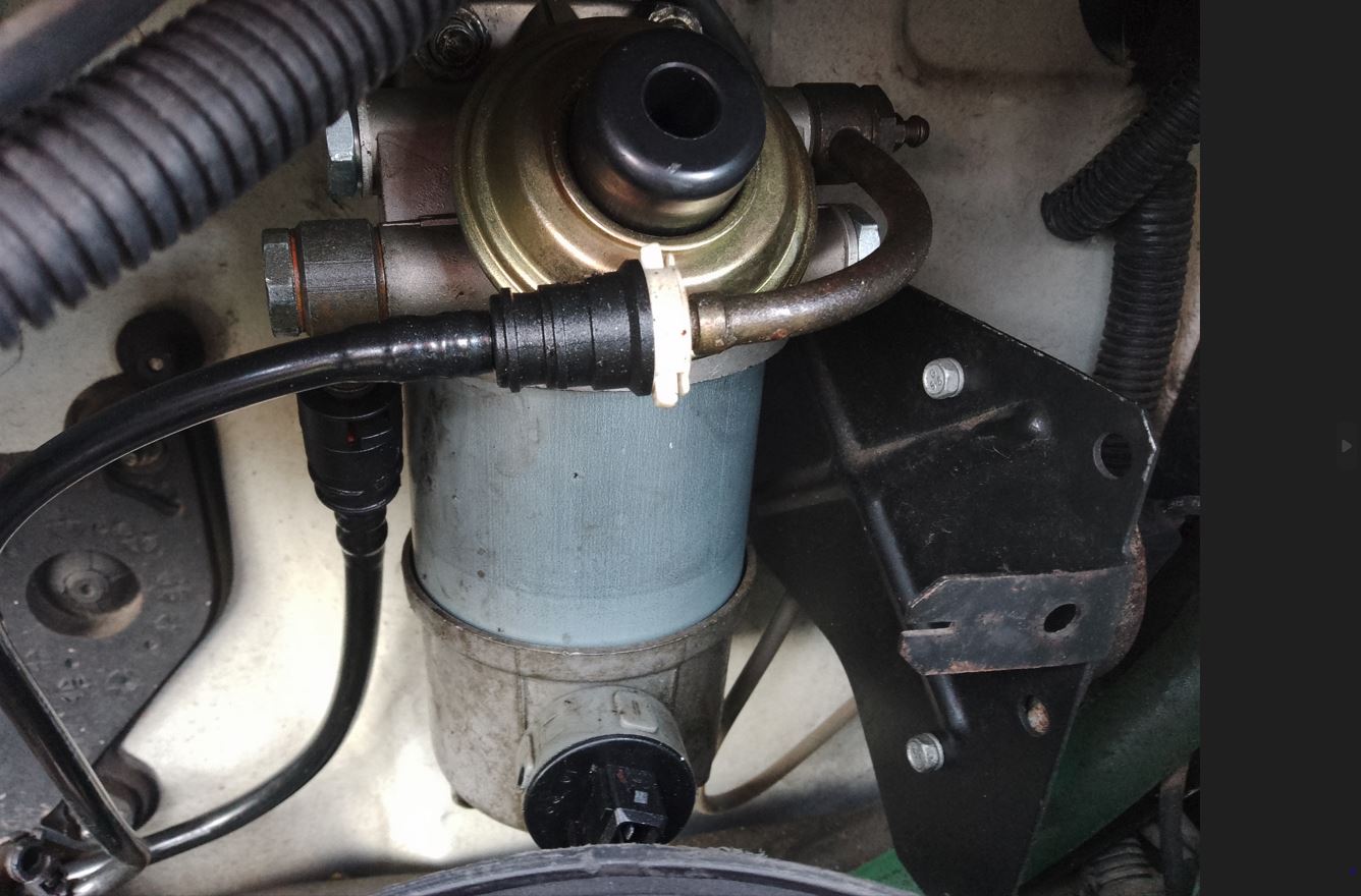

I couldn't see the diesel filter in photos or primer bulb(If it has one). Weak primer bulb joints, filter joints can allow air in fuel.
Try and find fuel filter and primer bulb and post photos
Check each glow plug gets power when glow plug dash light is on.
Check each glow plug not open circuit(disconnect glow plug wire and use tester to measure resistance between glow terminal and engine block )
Xud9 is an older type of diesel engine so will take longer to start than a common rail diesel engine but a dozen cranks does sound excessive.

Hello Everyone..
I have now taken pics of the diesel fuel pump and clearly shows the type it is... It has primer on top as a button... give it a 5 good pushes this morning... temp here today as I am on the sea front... is 3 degrees... and sunny... and give it a start and sure enough within 5 turns just started...
But fuel line was not primed I would say filter was 3/4 full of diesel.... before I primed it...
Lyn...
