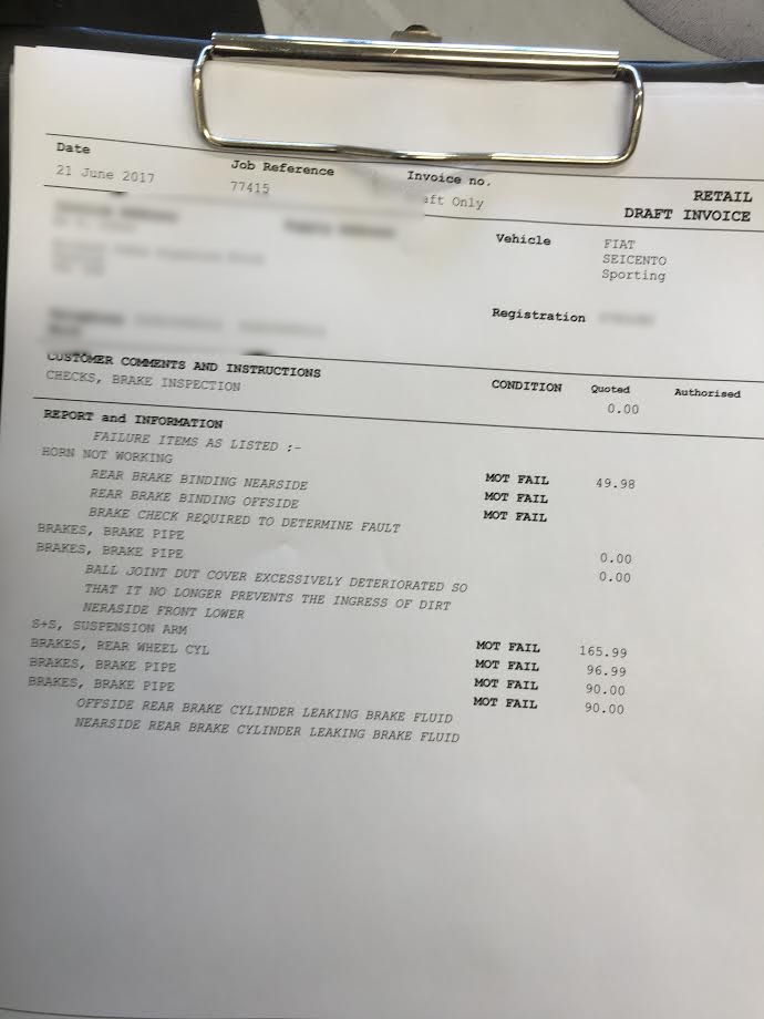

Hi Guys.
So, our beloved little seic sporting failed it's little test..
Got a quote from the garage to do the work, and I feel it to be extremely steep - am I missing something?
1. Ball joint dust cover deteriorated - Quote new item "S+S Suspension Arm" @ £166
2. Rear brake cylinders leaking brake fluid £97
3. Brake pipe x2 @ £90 each - £180
£443 total.
As I managed to replace a clutch cable following the advice of some wonderful ppl on here, thought I would run it by you all to see if this is something that can be acheived by a novice who can follow instructions for a lot less money, or if it is reasonable to get the garage to do it at their price...
Thanks in advance.

Yes you can and will be able to do all of that yourself.
That quote is steep!
The only thing that I don't understand is what s + s suspension arm means?
If you wish pm your reg to me or post it on here and I will look up MOT failure sheet on line and see if any further details.
Is that £49 for horn not working ?
Were you charged for that inspection? If so how much?
Yep. Although, when I press the horn, a loud 'Beep' noise seems to come from my car... so, not sure what they are on about with that TBH...

Ok had a lot look
Fail items only things to do first.
Horn not working , well yes it is - fixed.
Lower ball joint Rubber cover, yes you can get one and fit it with guidance.
Rear brakes dragging - yes you can be guided to fix that too.
Over all you are a winner.
Good work fixing clutch cable and car under 40,000 it's nearly new!
Ah yes depends on the manager , looks like your branch has a new manager.
Never mind think of it this way you are saving even more £££s doing it yourself.

The wheel cylinders are a great price .
Doesn't need brake pipe yet , it was slight corrosion advisory .
Once MOTed recommendation as to what to do will follow.
There is quite a difference between the MOT and what on the list pictured . Bit Naughty in my opinion but we have seen it all before.
Nothing on MOT about any leaks so owner sensible to look for themselves before ordering parts.

The bill you have been quoted probably has £200-£250 labour charges. Where I live in the north east of England, labour charges at a small independent workshop/mot station are £40 an hour. If you don't want to do the work yourself - try a smaller mot station/workshop.
But, as others have pointed out, you're more than capable of doing the work yourself. If you get stuck you have the forum to fall back on. When you've done the jobs you can always advise others ..
They are having you on...a new original birth wishbone (good quality part from shop4parts) is only a £50 part
Brake pipes will cost you £15 tops if you get someone to make them up for you...
Wheel cylinders are ten a penny... litterally about 4 or £5
Rear brake binding will probably be a seized handbrake actuator ( i sell these brand new if you need them for cheaper than the cheap ones on ebay)
They said that because they were so rusty, they would probably break anyway when they do the cylinders, so added them to the quote as well as something that would need doing...
