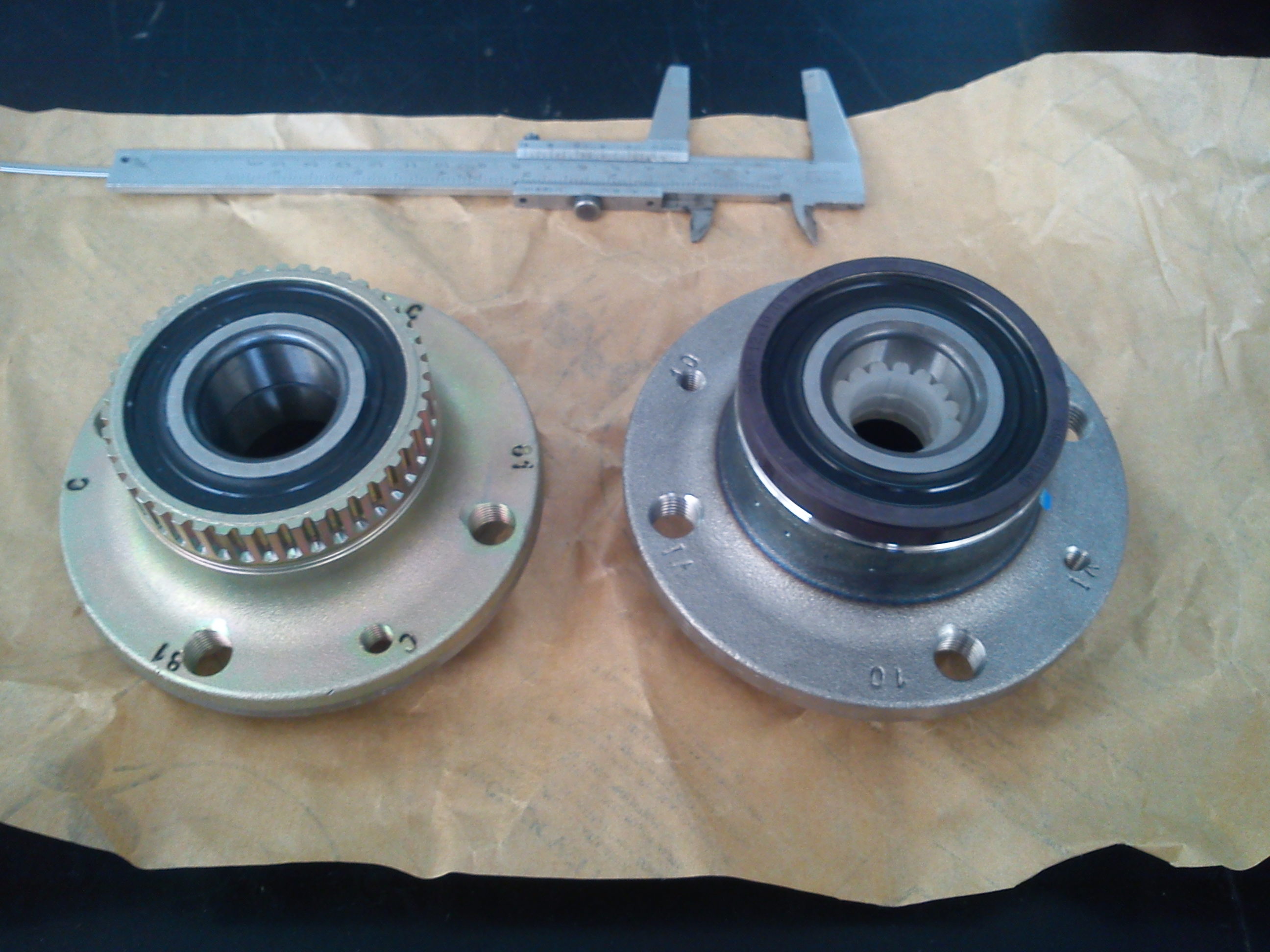

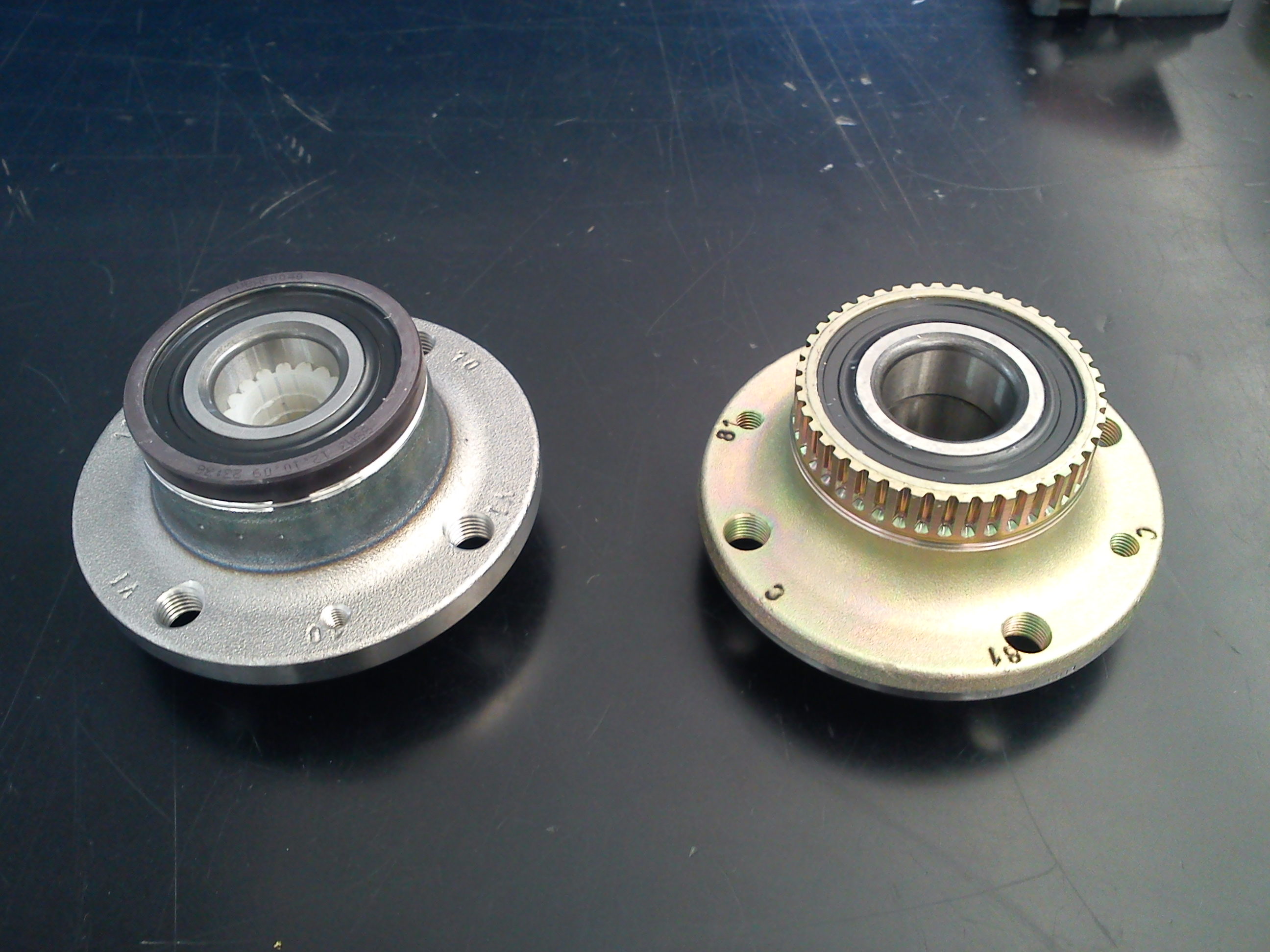

We compared the hub/bearing of that of the B to that of a Grand punto.
They are very simmilar in dimensions and i believe the punto hub would fit a barchetta rear axle , enabaling the 4x100 pitch upgrade but the only difference was the way the ABS sensor works.
The B's hub has a toothed ring which somehow controls the ABS sensor and the Grand punto's is purely round but most probally works magneticly.
Heres some pics for comparison.
Does anyone know if it is it posible to remove the toothed rimmed ring as on some vehicles you can.

Talking with Mike my nephew mechanic, he told me that some model cars the cog toothed ring for the ABS senser can be removed. I,m not sure if this is the case with the Barchetta,
I,ll have to have a look, but i,m not close to the B and Mike only gets to have some spare time when he can in his busy schedule to work on her.
The Idea Pete mentioned about remilling the original 4x98 pitch sounds good but i,m not sure if thats possible due to having to use thicker wheel bolts to compensate.
Id imagine i would have to have 4 complete new holes drilled into the existing hub then 4x100 is viable aloowing the ABS sensor to work as it should and then allowing an upgrade to any larger disc size and caliper.

Seems that there are two wheel hub bearing listed for the Barchetta,
one with a toothed ring bearing for ABS as is mine and another with the same look as the new Grand Punto listed as fitted with new ASB bearing and is also listed for many other models.

The ones without the toothed rings have magnetised parts which are picked up by different types of sensor:

Ive discovered that the new Grand Punto rear hubs use the new style ASB bearings which are also found and used on newer model Barchetta's, the only difference is the pitch.
Its to do with the ABS systems, the new ones are accurate down to 0mph wereas the old style toothed hubs may not be so accurate in reading sensing the wheels speed.
NOW! heres my thinking.!
If your Barchetta is already equiped with the new style magnetic bearings then you must be using the new style ABS system and could easily upgrade your hubs to the new 4x100 Grand Punto. They should fit perfectly !! :) and may even give you a few milimeters extra width track.. No more wobblys and a perfect fit for your Grand Punto wheels.
