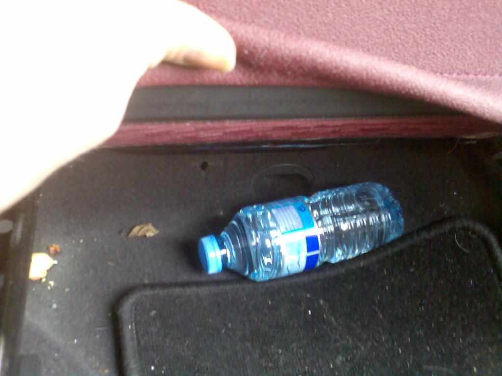

1. remove seat cover
At the end of the back of the seat over there is 2 black strips of plastic hooked into each other.Unhook them.
This is a better view of the strips with the seat cover inside out.
The seat cover is fairlt tight and velcro`d at places but should lift up handy enough(y)
