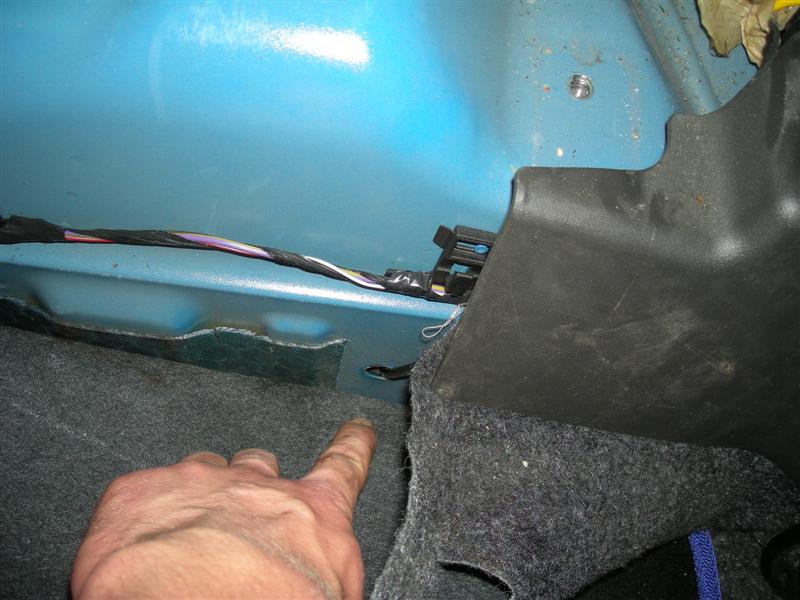

ABS models – push the two bungs out of the floorpan out of the hole they are in. The left one goes at the bottom of the rear seat, the right one goes just underneath the rear seat backs, easier to see from the boot.

Unclip both ABS sensors at the white joints sitting under the seat bottoms. They will pull out from each other with a bit of effort.

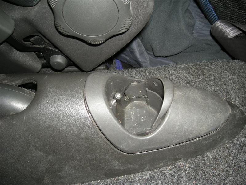

Now, undo the handbrake cables. You need to remove the rear ashtray and take out the 3mm caphead screw:

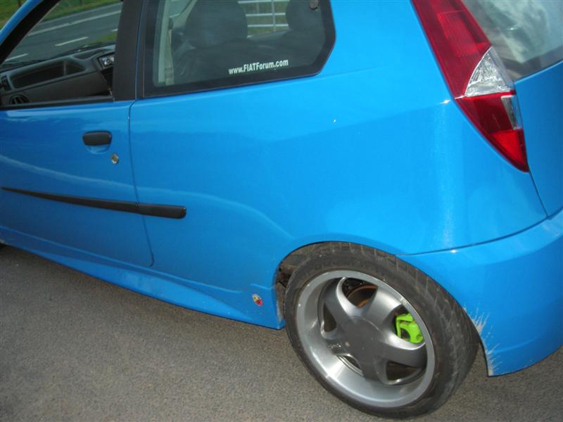

Finished product:
