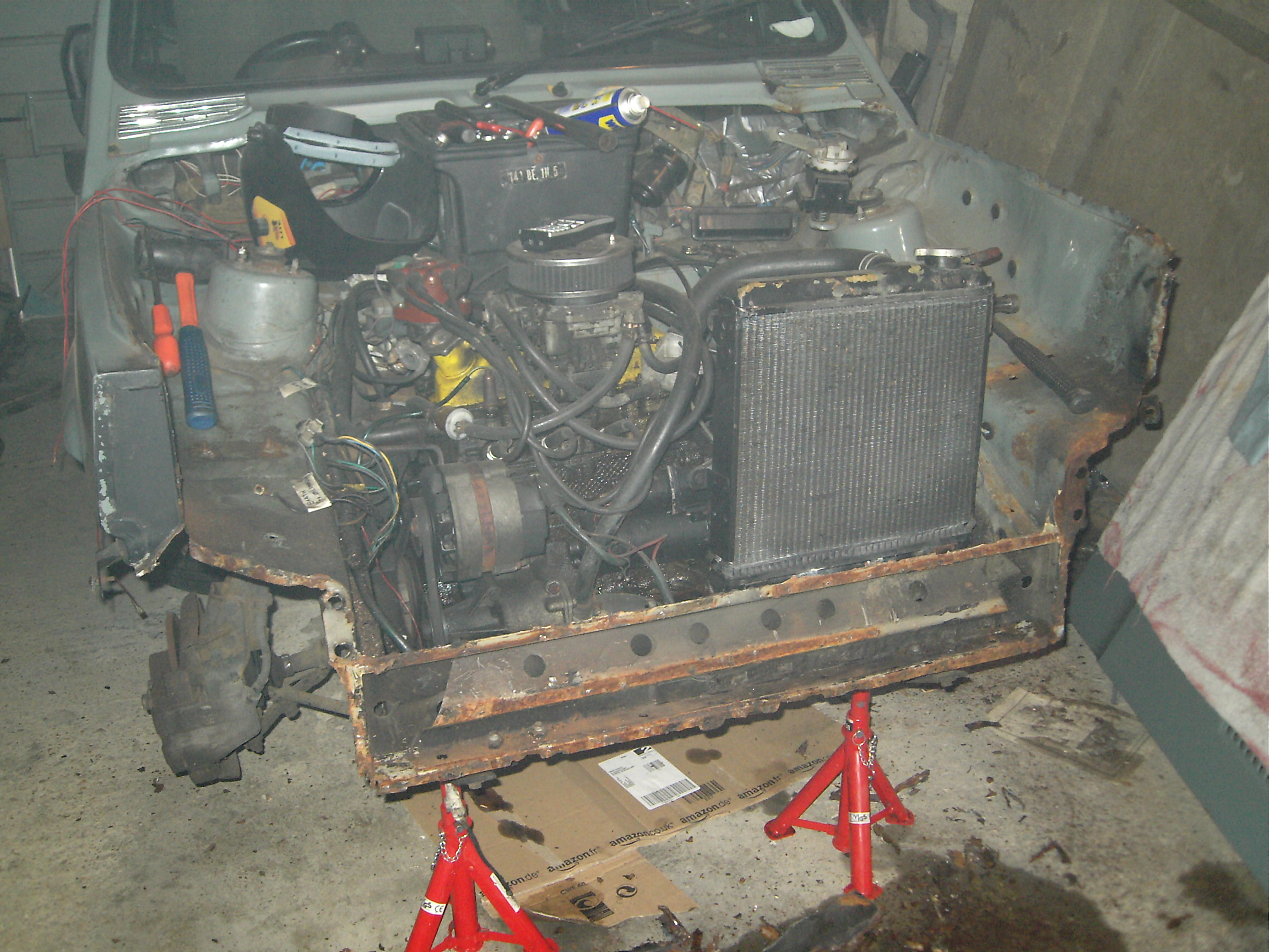

I think I have gone one step too far this time, 10 mins and a screwdriver had it off :eek:. It had very poor welding when she was repaired after the accident 3 years ago (about 3 good tacks and a load of sealant was all that was holding the front panel on!!). The buggers who put the front panel on left the old rusting front panel on underneath too!! Made all the panel gaps even worse than a standard panda!!
To be honest, I didnt know whether to laugh or cry. I have no idea how I ended up doing it either!! I only intended to start tidying up all wiring at first. :eek:

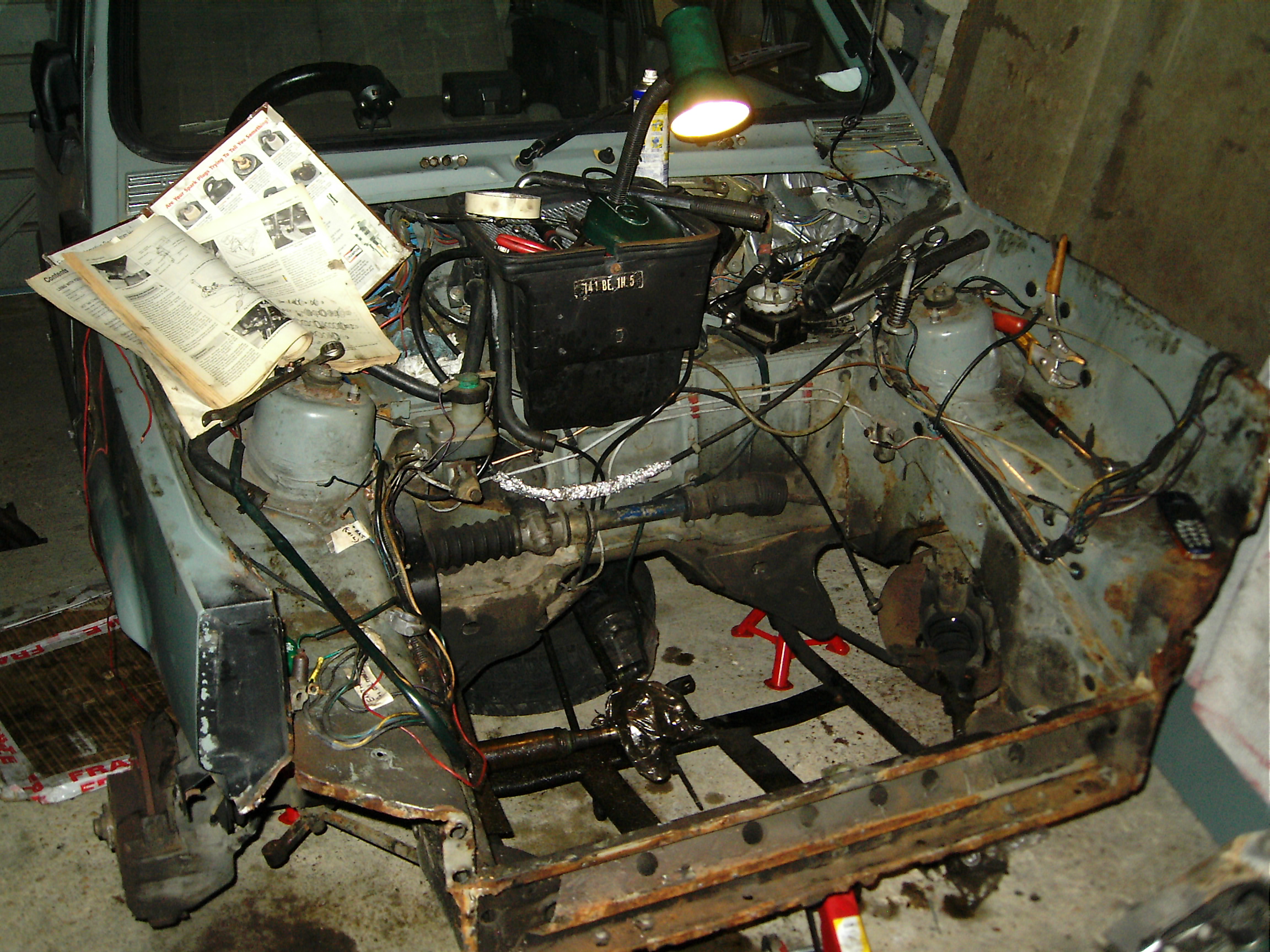

Yeah, the engine will just roll out now :D
The engine looks very dirty to be honest :D its not the new one yet. its going to look tidy pies when I'm finished and with all this exposed I am going to town on the front end. Some juicy suspension is being concidered. New everything suspensiony i think. After driving the other 4x4 I have realised how floppy the car has gotten over time :eek:
Todays work, slowly disconnecting bits and peices from the engine. Going to try to lift the whole engine/gbox out in one go. Just for the hell of it! :devil:
More updates to come, bare engine bay pics :D UNSENSORED!!

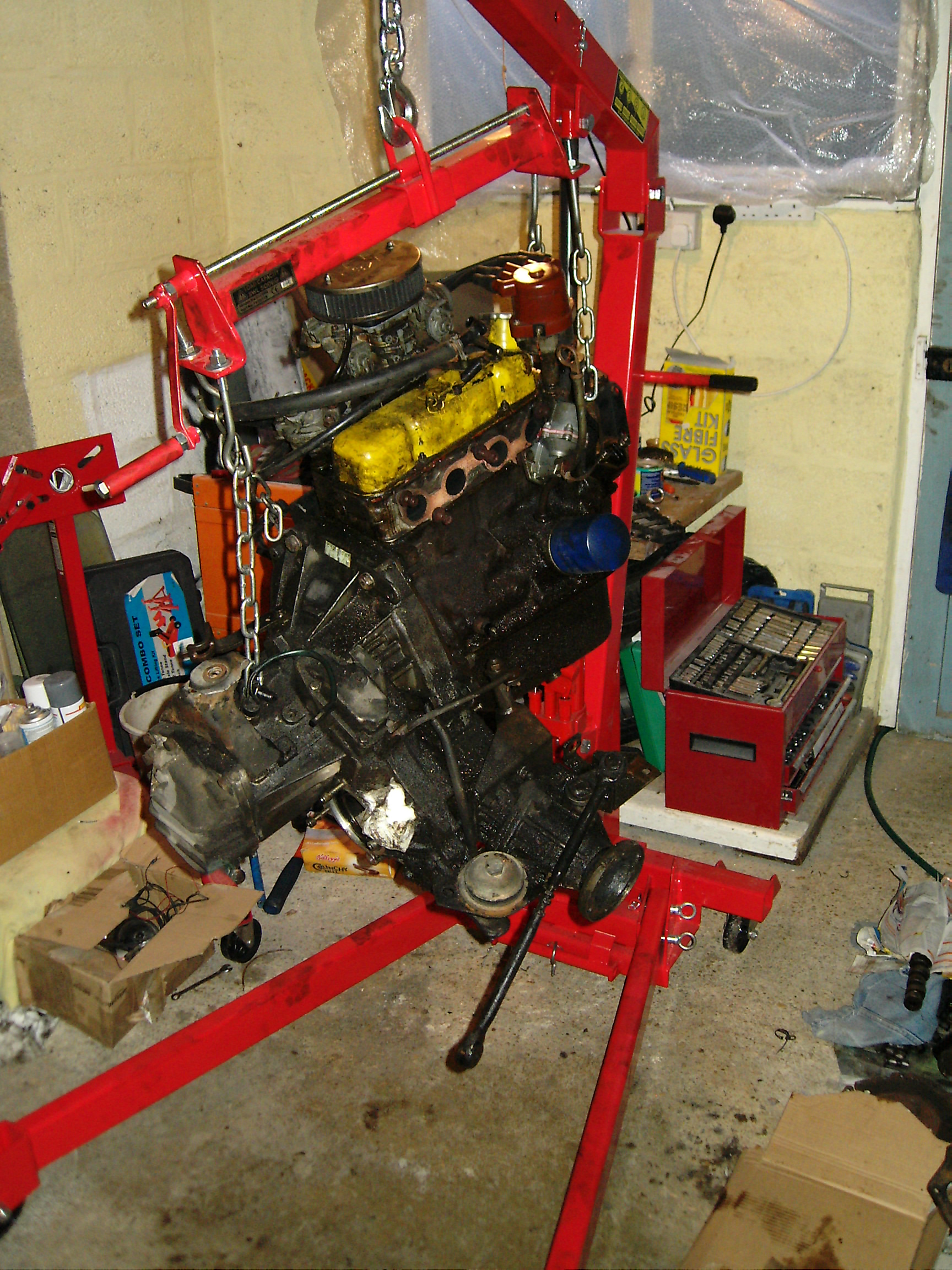

Well, after some wrestling I managed to take out the engine and gearbox with pretty much everything left on. I only had to remove the gearbox side engine mount :slayer:
I'll do a post of "how to" in the Panda section soon. Although not sure how relevant is will be as the front panel was missing!! haha. Lots to do this weekend now! :eek:

But yes, usually I would drop the sump guard and lower it out the bottom. I kinda wanted to see if it was possible to take it up now that the front was missing. And success. It didnt take longer either, just getting the usual bits and peices disconnected that takes up the time really.
I can see what is wrong with the clutch mechanism tomorrow anyway, fingers crossed nothing serious, but the clutch is unusually stiff. Will check the pedal box too as that is suposedly a common fault.

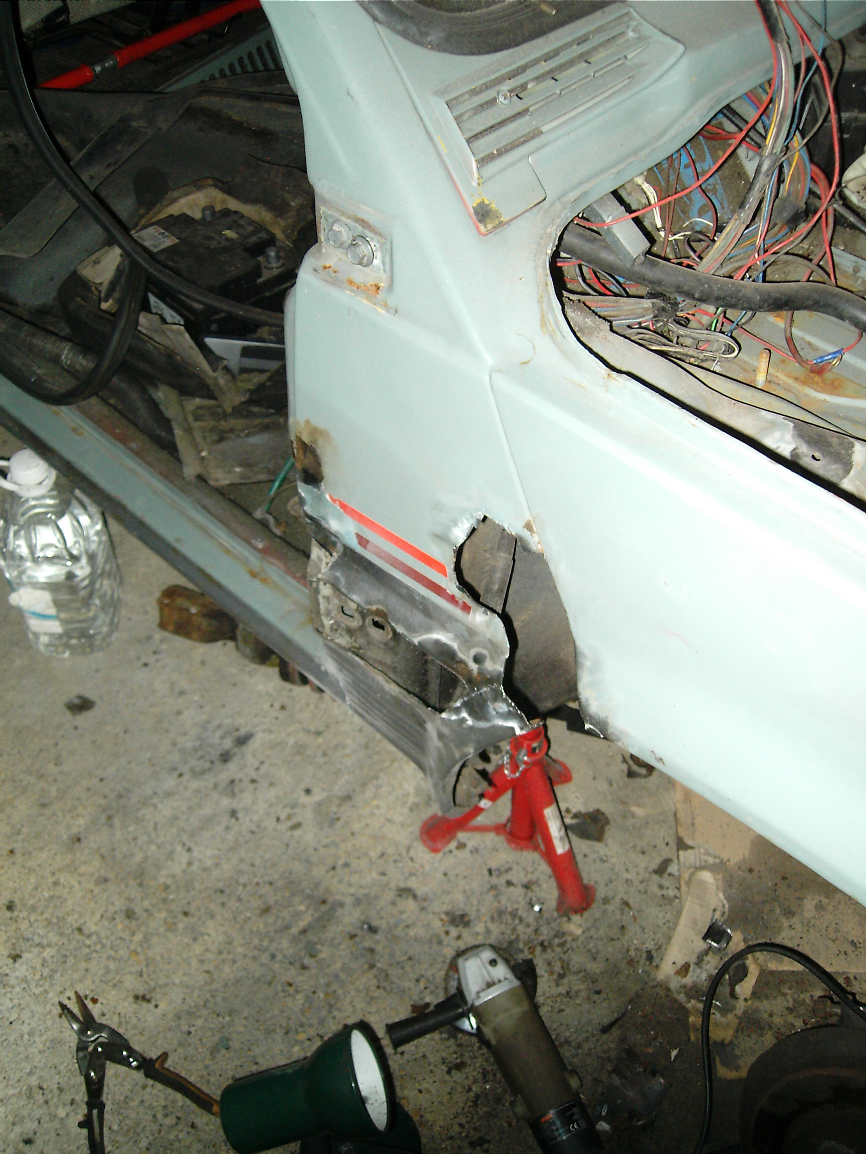

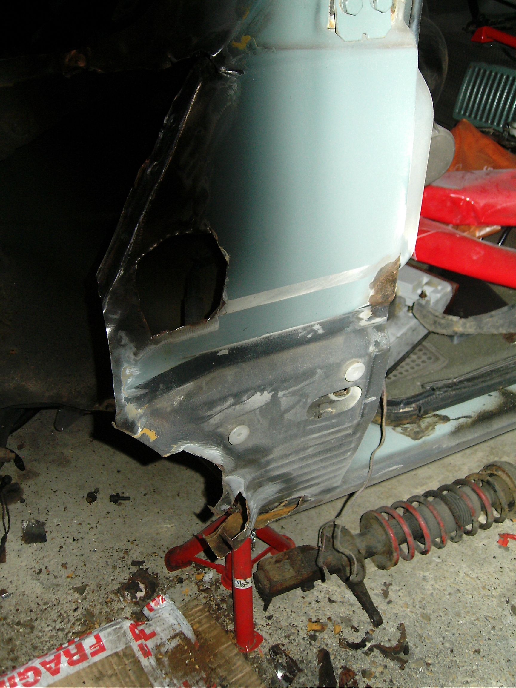

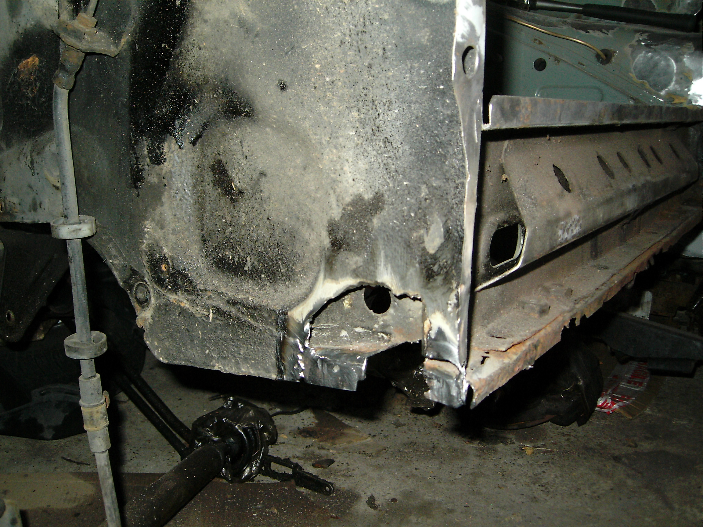

Well as ever I have been busy trying to remove rust from my beloved panda!! I feel I have cut away a lot of metal but I am hoping as usual it feels terrible at first then gets a lot better as everything goes back together. I hope my welding skills are up to the task as look what I have gone and bally done:
Oh gosh, I have murdered my car. :eek:

:ROFLMAO:
We'll let you off with manslaughter if it goes wrong as your intentions are good (y) :p
But surely being premeditated doesnt help my case. and the variety of Saw (the movie) like impliments used.
I supose I am not as bad as Saw though, as I didnt make my panda use them on herself to prove she respects life.
Anyway, more rust grinding then its time to start making bits to plug the holes! More photo's soon I expect.

One sugestion if I may,try to make holes and plug edges straight as much as you can,a lot easyer to weld and prepare for paint.
Sorry on my bad english.
Hi there, thanks for the advice, no need to apologise for your english, it is good. I will hopefully do some welding this weekend. I am quite excited as its been a long time coming, but there allways seems to be something else to do around the house!!

What metod of welding are you using?(mig,tig...)If you are new in that job I can send you links with step by step how to.
