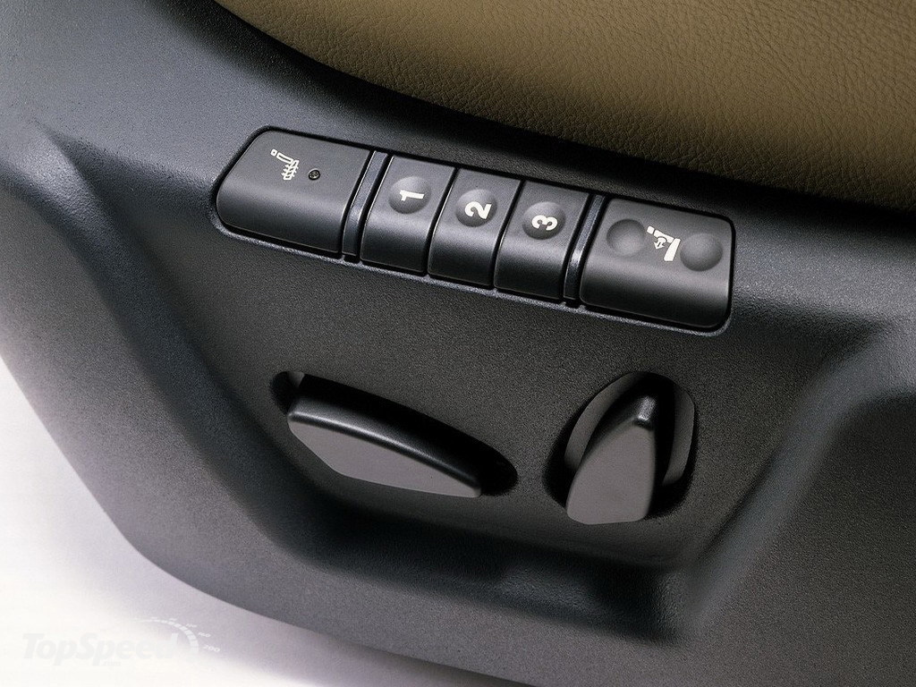

Mirrors with the memory setting were only fitted to cars with electrically adjustable and heated seats. 3 buttons on the side of the driver's seat would adjust the seat and mirrors for 3 different drivers. It would also dip the passenger side mirror to the kerb when reverse gear was selected.
Memory mirrors are about 3 times the price of normal mirrors, so they probably contain additional electronic components. Therefore the connectors will probably be different.
