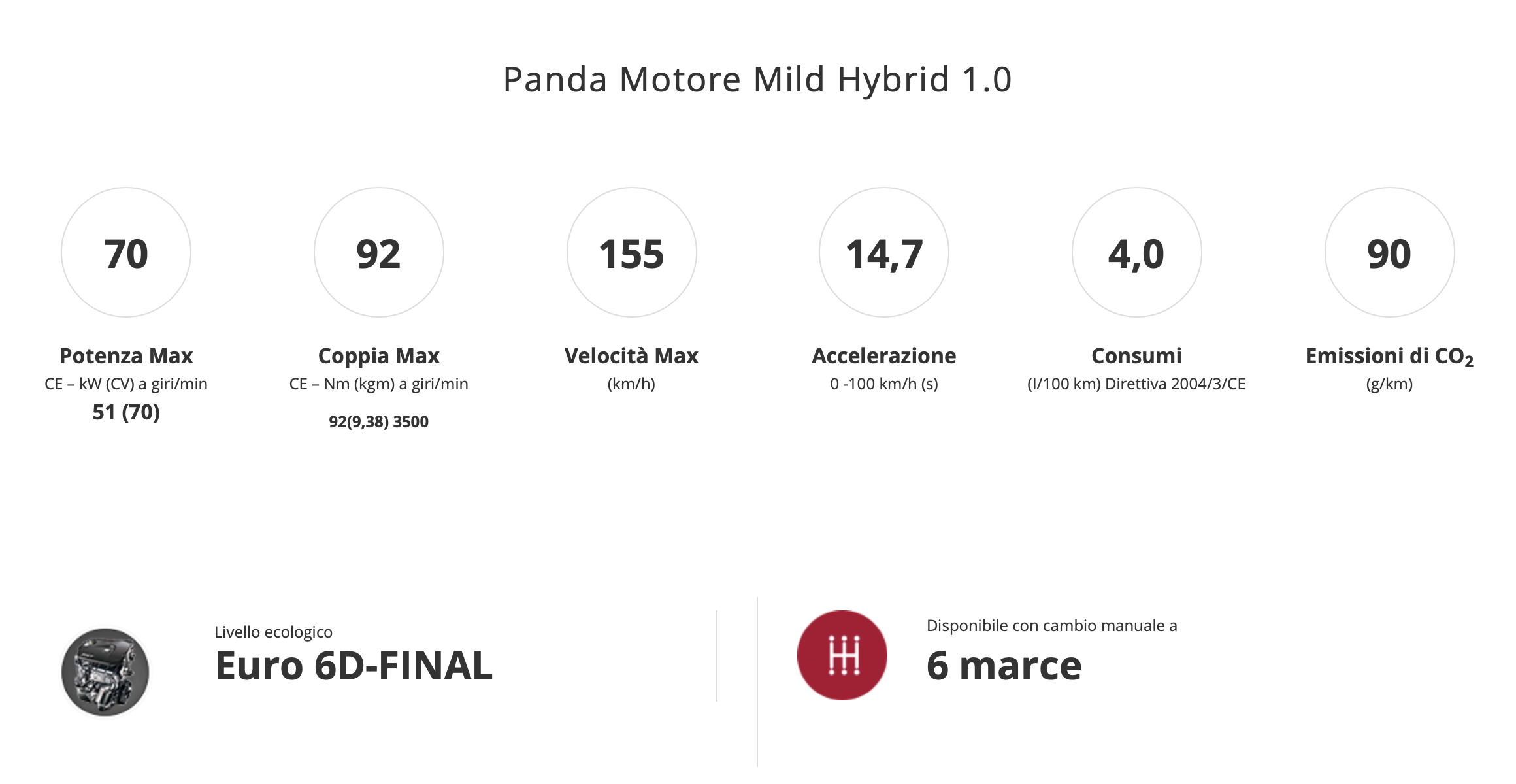

Reading the articles on this am I mistaken or do they say this car will have a 12v electric motor helping it along?
So... the car doesn’t use a normal starter motor it has a 3.6KW 12V electric motor that spins the engine up to speed using the aux drive belt. When running the motor becomes a generator, charging a (tiny) 11Ah lithium battery. To put into context how tiny this is 11Ah is the same as 3 individual cells from a tesla battery, when a normal tesla battery is 7000 individual cells...
This gives enough power to turn the motor for a couple of minutes max and the energy used by the motor is about the same as the aircon compressor would take to run.
When you are coasting at speeds below 18mph the car can turn the engine off and use the motor to stop start the engine while still moving. This can save a little bit of fuel. The motor and battery combo however does not have enough power to give any significant boost to the engine, Fiat say it will help with acceleration but in essence all it would do is take the load of the aircon compressor at most it’s less than 5hp from the motor.
So it’s really complicated, heavy and expensive compared to normal cars....
Yes, it is mounted instead of a old-fashion Alternator.
