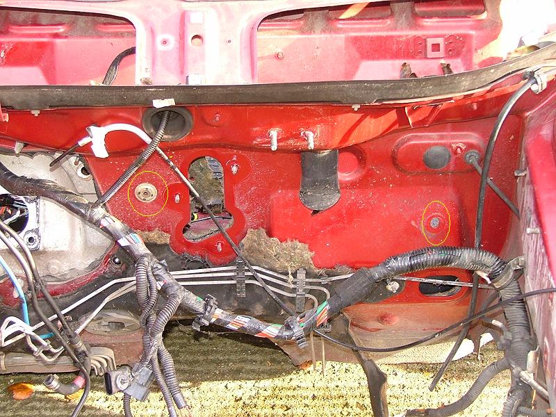

ita a pain in the bum job you will need alan/hex sockets and normal sockets, once dash is out you need to remove heater box some nuts are inside behind dash 2 are under bonnet hiden behind plastik circle things that hold soundproffing stuff on, pics below if engine side of box shows bolts and other pic shows where they are under bonnet, soundproffing removed for pics only you dont remove yours.

oh man i could have done with those pics few months ago when i tried to change mine :D could i hell find those bolts hidden under the plastic covers :eek: had the dash off aswell and had to put it all back together again..................anyway barsleak did the trick (y)
