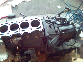

I've centred the clutch plate by eye on the flywheel and the female spline looks pretty much dead central. But the bell housing just does won't go that last inch to snug up against my new engine. I've turned the flywheel slightly to try and give the splines a hand to match up but to no avail. Complicating matters is the additional spline on the driveshaft that goes in at the same time.
Is this a tricky job or am I feeble? If you have any experience can you give me any hints and tips?

Have a look to make sure there isn't a dowel still in the engine block and also one in the gearbox? if thats ok then try turning the drive shaft as your sliding the box in, one more thing did you slide the clutch plate onto the spiget shaft before you fitted the clutch to make sure it fits the splines?

I'll check these out to be sure. G/box didn't want to come off the old engine so I spose was going to be a fight getting it back on. Thinking whether putting g/box and engine on hoist at same time would be easier. Hav briefed girlfriend to look out for oil cooler parcel on Monday, she say ok, woteva... :rolleyes:

The answer is.......Gravity...but what a workout getting the engine on it's side (but on blocks to clear tensioners etc) then gearbox roped up to come down level on top, then drop big heavy thing back to floor right way up ! :cry:
