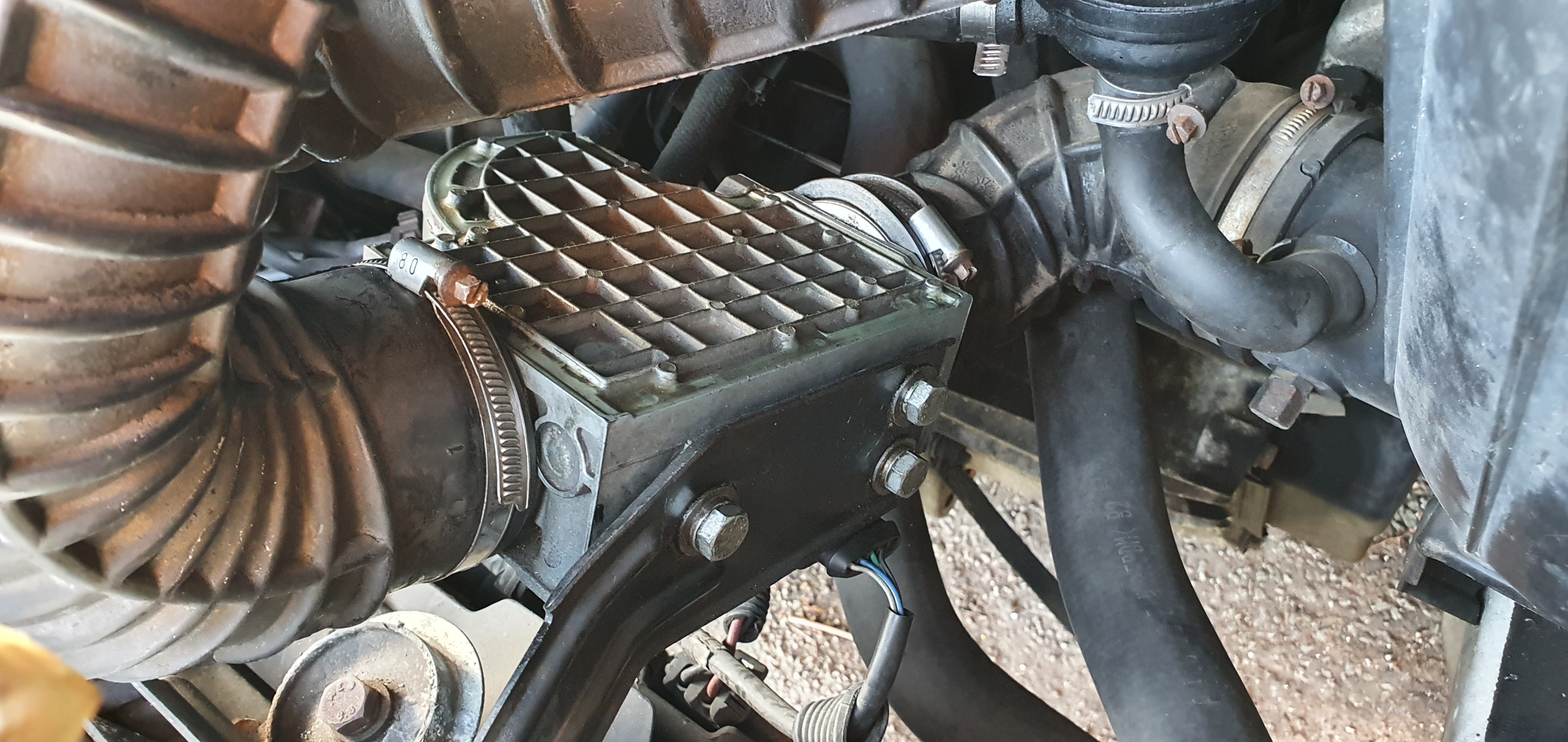

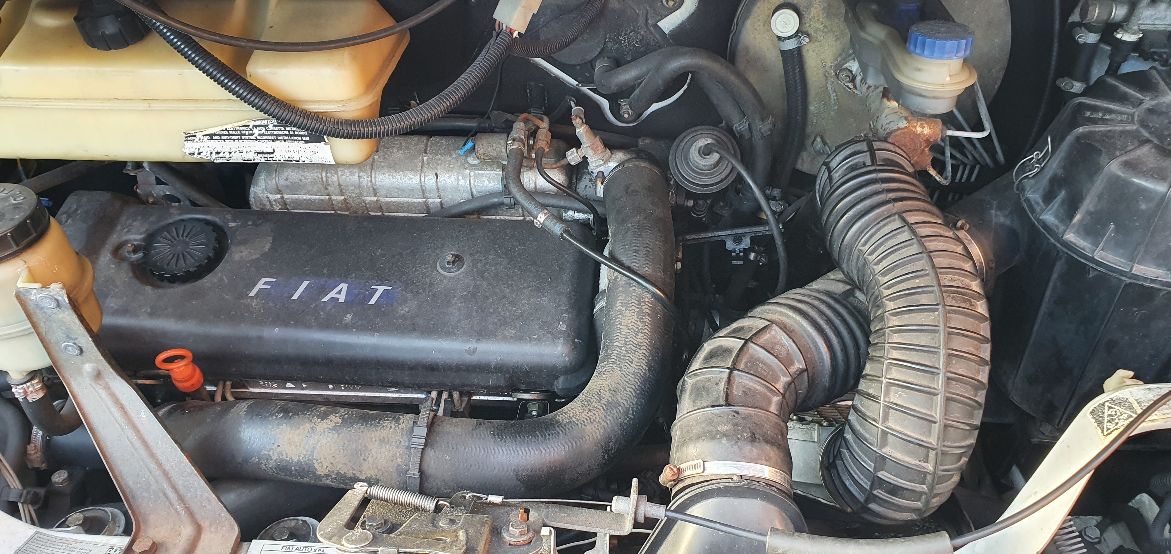

Hi, first time in the forum & looking for some help. I assume this to be correct, so please let me know if I've got this wrong. Sometimes my Hymer loses power(turbo) and I've traced it to what I think is the MAF cast aluminium box with a flap & air flow sensor inside. When I take it out & clean it power returns. My question is, is the an aftermarket replacement part for this box part? I can't seem to find it but there are lots of plastic inline pipe types available. Please can someone advise? Thank you Si.

Please post some photos of engine with any covers removed and pictures of part you refer to
Here are the images & part number Bosch 0281002087. Cheers Si

Only replace with an identical moving flap type air flow meter with exactly the same Bosch part number.
The plastic tube type only pop up as a cross reference on chinese web sites and I am sure they are wrong.
Google the bosch number and some used parts appear available within Europe.
