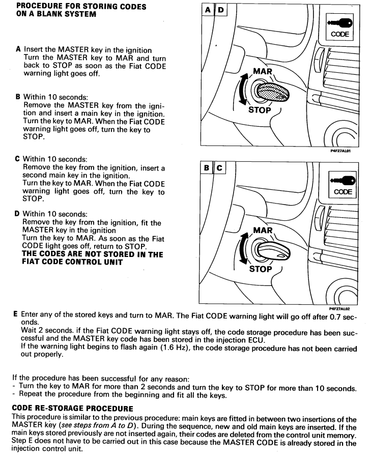

Hi and welcome
If it has a MASTER key ( brown) it is also unlikely to have an OBD port under the dashboard
That is the early key security system..

For ignition, for remote you would need the number.
Mine lost sync on the remote after one winter so I got aftermarket set with flip key and moved the ignition transponders to the new keys.

Red one has transponder molded in, no remote control in it.
No real way to get the code.
I just bought 25€ remote kit and 7€ fiat blanks for it. It installs under the rear seats as the control unit is there.
