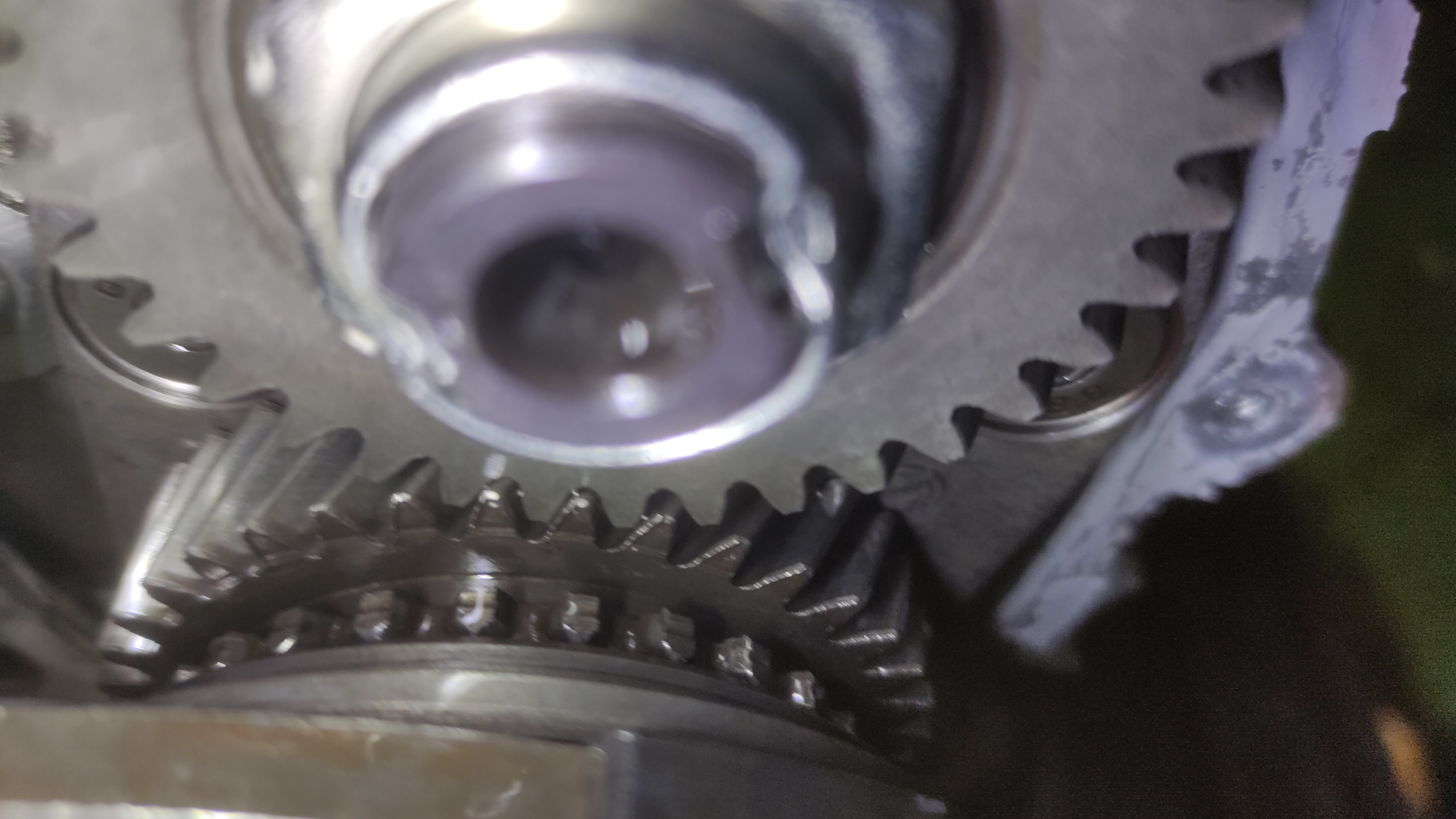

Hey,
1.2l 8v manual punto grande 2012.
My gear main shaft bearing was faulty so i replace it with a new one.
After assembly and cable linkage adjustment (upper cable=selector, is There a cable adjustment for the lower cable that isnt mentioned on elearn? ) 5th gear is slipping out to neutral. Doesn't happen immediately and i can see the shifter knob slowly going toward the neutral position.
When it does moving toward neutral i can remove my foot from the throttle and it sets back to 5th gear.
It's as if nothing is locking the gear in position.
I added photo of the 5th gear assembly and although its not brand new it looks ok.
Needless to say that Before the gear dismentaling the 5th gear worked perfectly.
I used elearn for the whole procedure.
Any suggestions What could have caused this problems/What have i done wrong?
