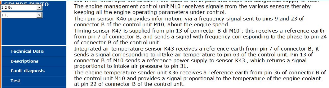

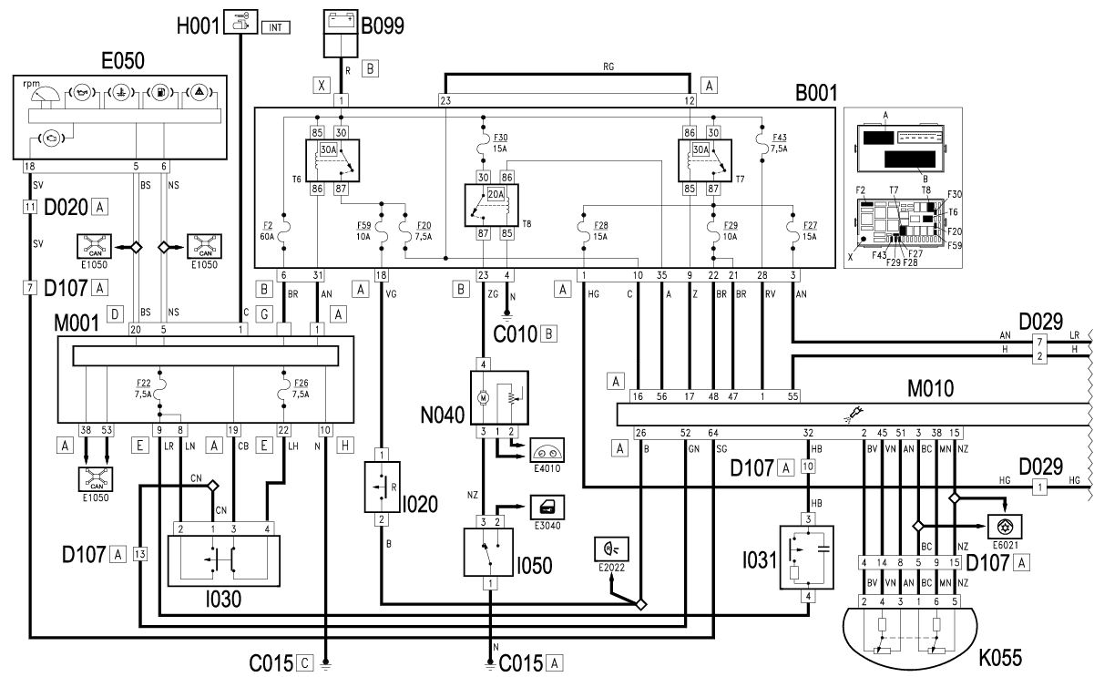

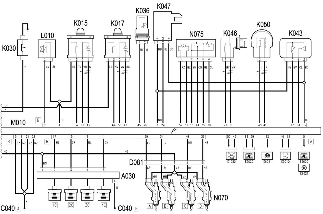

Hi ! here is some info about what you're looking for. (K43)

I don't think there is a MAF on any of the small petrols (don't know about the latest models) My 2010 1.2 Panda certainly doesn't have one that I've found yet. MAP? yes - single screw holds it to the side of the throttle body.
From the text in Berni's post, it seems to tie in with the text about a pressure reading (about 2/3 of the way down the text) -ref voltage being sent from pin 13, modulated by K43, that will be the MAP? and this output arrives at ECU pin 31 so allowing the ECU to ascertain air pressure in the inlet manifold/throttle body? Simples!
There is only a Map sensor which is separate from the air intake system, what kind of cold air intake are you putting on? You may actually lose power over the standard air box by dragging in warm air if it isn't right, the stock air box actually has a decent cold air feed on the GP and gets sufficient air as stock for the engine.
