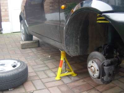

Prepare The Car
You need to park your Cento on a flat even surface. Failing that, any driveway will do as long as it isn't really steep (use your own judgment). You then need to get the car up on axel stands with the handbrake on and with something blocking the back wheels (as pictured, a rock will do). Remove the front wheels and place them nearby (they are quite handy to sit on whilst working later).

Now you just need to put the wheels back on, lower the car off of the axel stands and de chock (de rock in some cases) the back wheels! In that order, lowering the car without the wheels on isn't a good idea.

Prepare The Car
