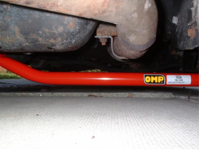

It's not a good idea, on mine sitting on 13"s with a 55mm drop the front brace was under an inch from the floor. They're a stupid-arsed design, how the hell OMP got it that wrong I don't know. The damn thing doesn't need to drop down anything like that, there's acres of space between it and anything under the car.
Biggest problem, as pointed out by Rallycinq, is that they bolt to the front chassis legs. Bat anything solid with it and you'll bend the car.
I didn't even fit one, just held it in place to see what it looked like then put it back in the bag and flogged it.

wow cant believe how much space there is between it and the car!! :eek:
