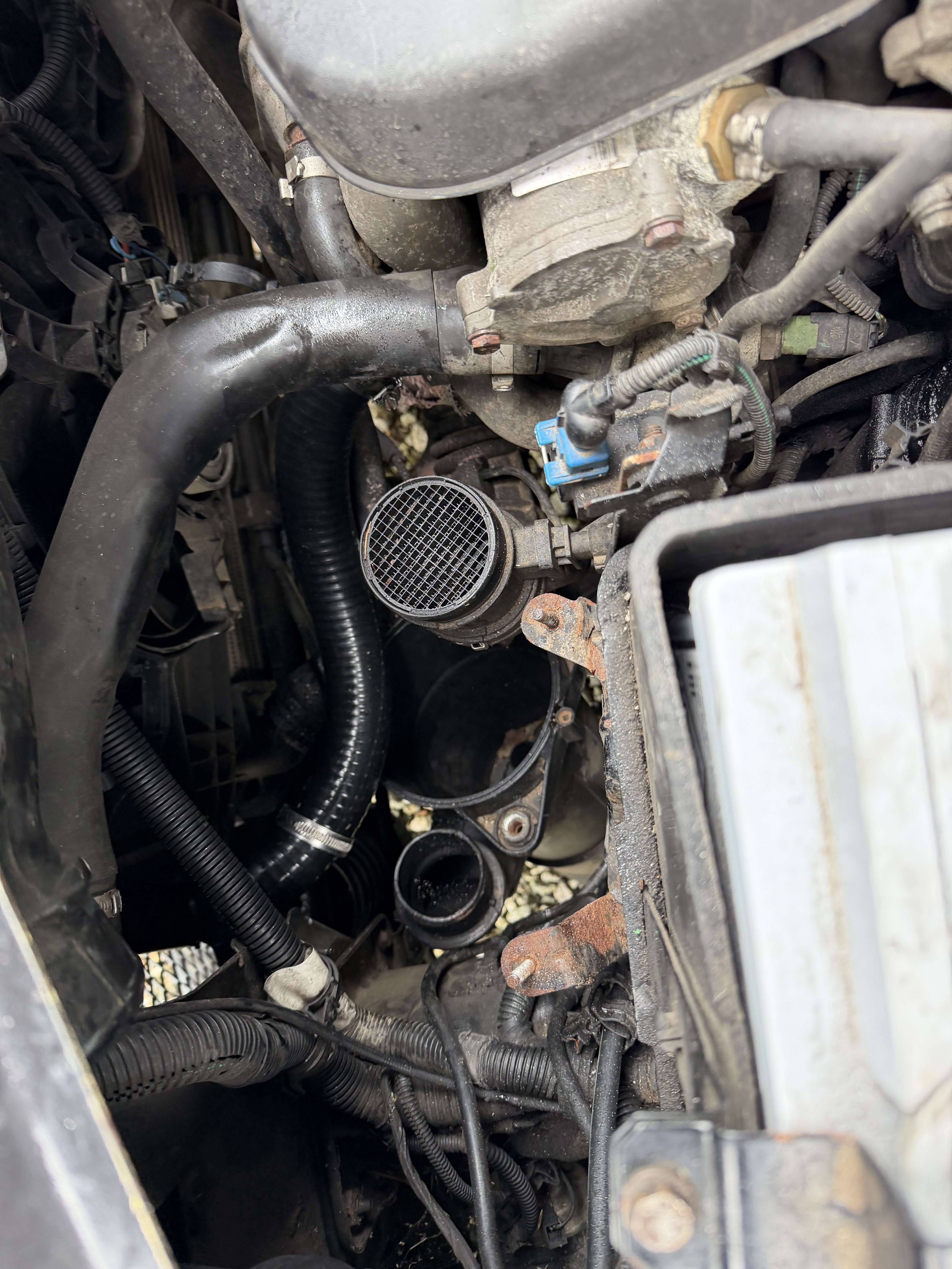

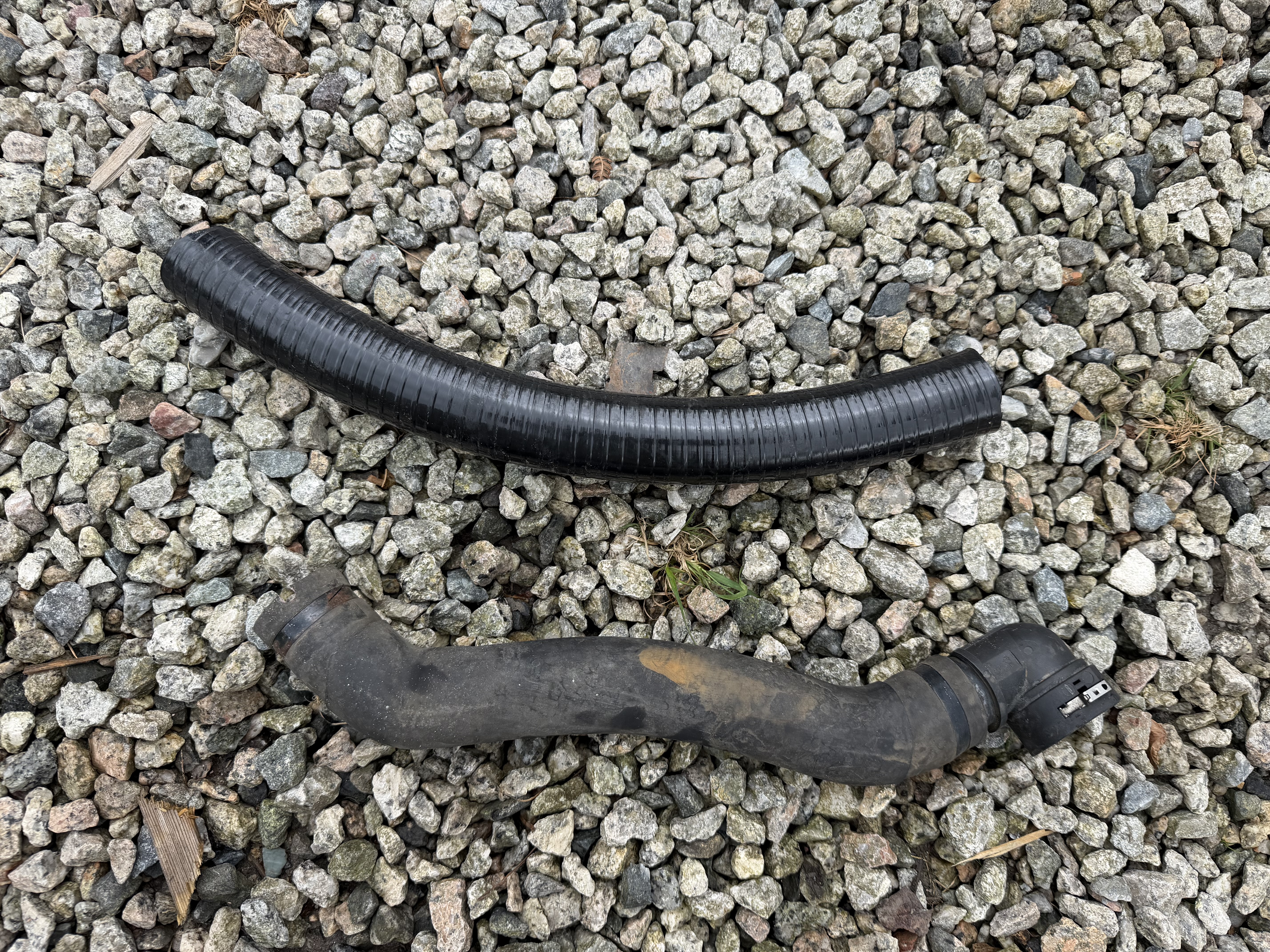

So get to a friends house on Friday to discover coolant leaking from the lower radiator hose connector. Can’t get replacement part due to bank holiday weekend. Manage to temp fix with a hot tub hose and jubilee clips and keep the doblo on the road till the proper hose arrives.

So get to a friends house on Friday to discover coolant leaking from the lower radiator hose connector. Can’t get replacement part due to bank holiday weekend. Manage to temp fix with a hot tub hose and jubilee clips and keep the doblo on the road till the proper hose arrives. View attachment 486843View attachment 486844
The refitting and sealing of those plastic clip on ends was the problem with my 2010 Doblo 1.6MJ due to an oil cooler leaking into the the coolant system causing the rubber O rings to swell making them un usable.:(
