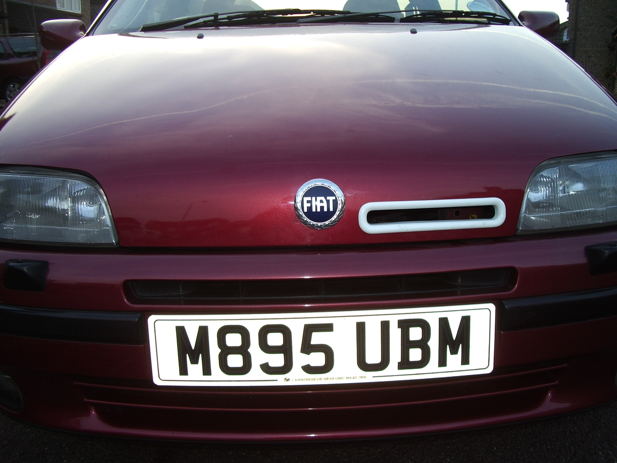

Fitted my letterbox vent today so i thought i would post some pics up for you all. It needs spraying yet and the Fiat badge needs removing as it looks too crowded but thats a job for another day :cool:
What ya reckon?
I think it will look good when it is colour coded and the badge is removed anyway. I never had a cold air feed to the filter before this vent and now i feel such a difference :slayer:

nice but dont most people have them a tad higher up? only 1-2cm higher though?
Theres always one isn't there :bang:
They say it should be 30mm in and 30mm up and thats what it is.

I can't wait to get rid of that badge and get it colour coded, just having a bit of a go on photoshop to see how its gonna look. BINNY off puntosports fitted it for me,he fitted his one today aswell but his vent came in black to match his car, doh! :(

Oh don't say that! I really try and make my car mods as subtle as possible but i had to do this as its the best way to get cold air to the filter.:eek:

Thanks, i was thinking about spraying it black to match the lines on the bumper but my mate reckons definately colour code it, maybe i should start a poll :rolleyes: The badge is definately getting removed and im going to flush the vent into the bonnet (y)
I made a template of the vent out of cardboard then taped it where i wanted it, then i drilled loads of small holes to make the hole, popped it in then glued it with some araldite, jobs a goodun!

is that lots of little holes as in one of them really skinny drill bits?
getting my vent soon, dont wanna fcuk it up :eek:
