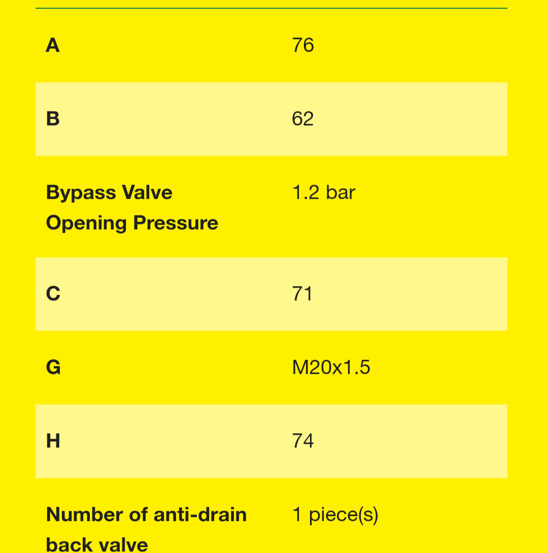

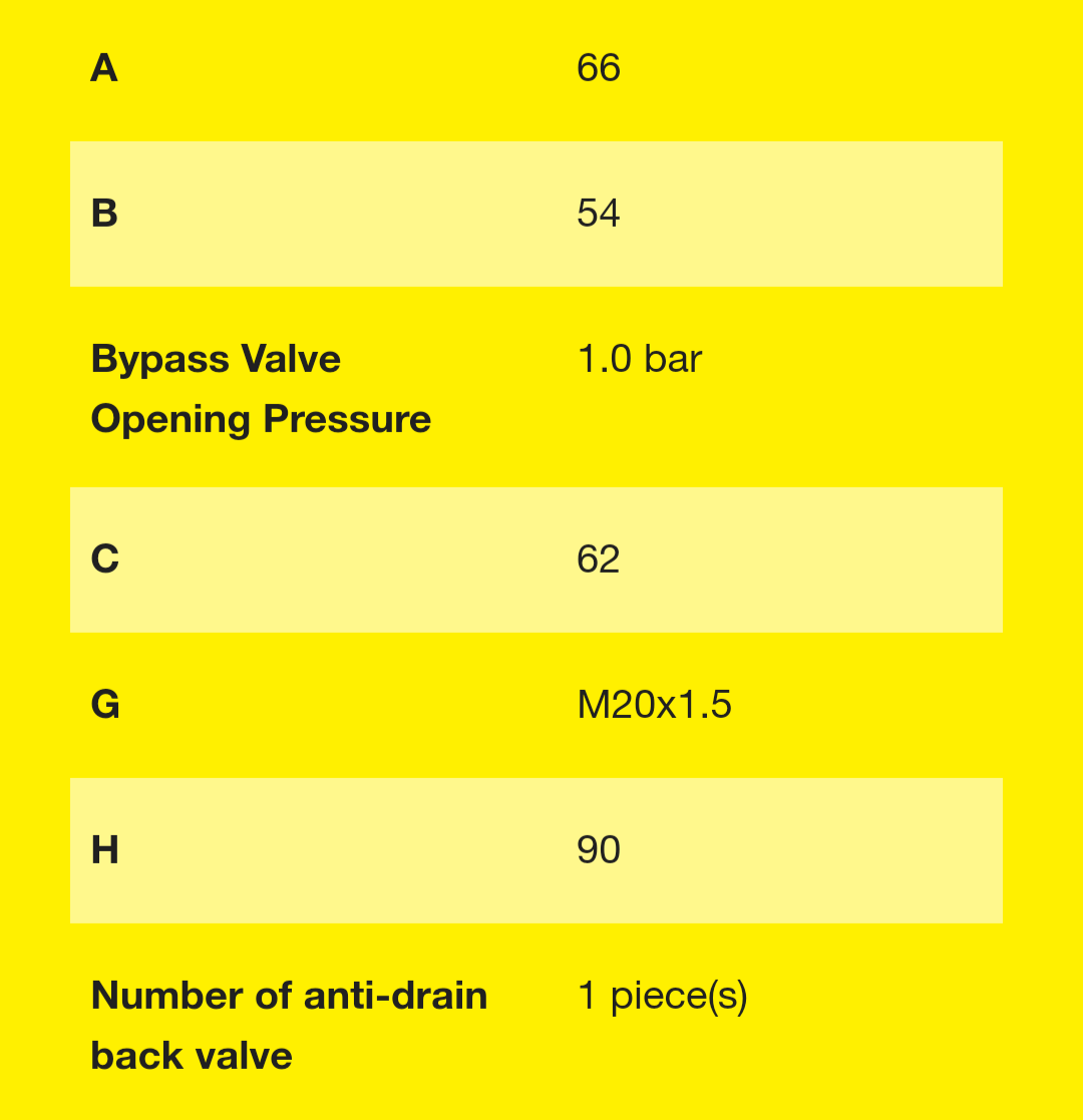

Oil filters
1.2
There's two types notice the engine number of the swap over
The early ones are longer,
A it the diameter
H is the length
C is the outer diameter of the sealing ring
Also notice the bypass pressure is also different (2.9 PSI)*
Counter intuitive the shorter filter has more volume
V ≈ 307.91 long
V ≈ 335.7 short
That because the radius is X3.14 so it has a larger effect than you think
That's not to say it holds more oil it depends how the space inside is filled
Also notice the bypass pressure has altered
I don't know why the filter was changed, proximity to the exhaust, just a stupid guess, But I don't see it as a down grade
