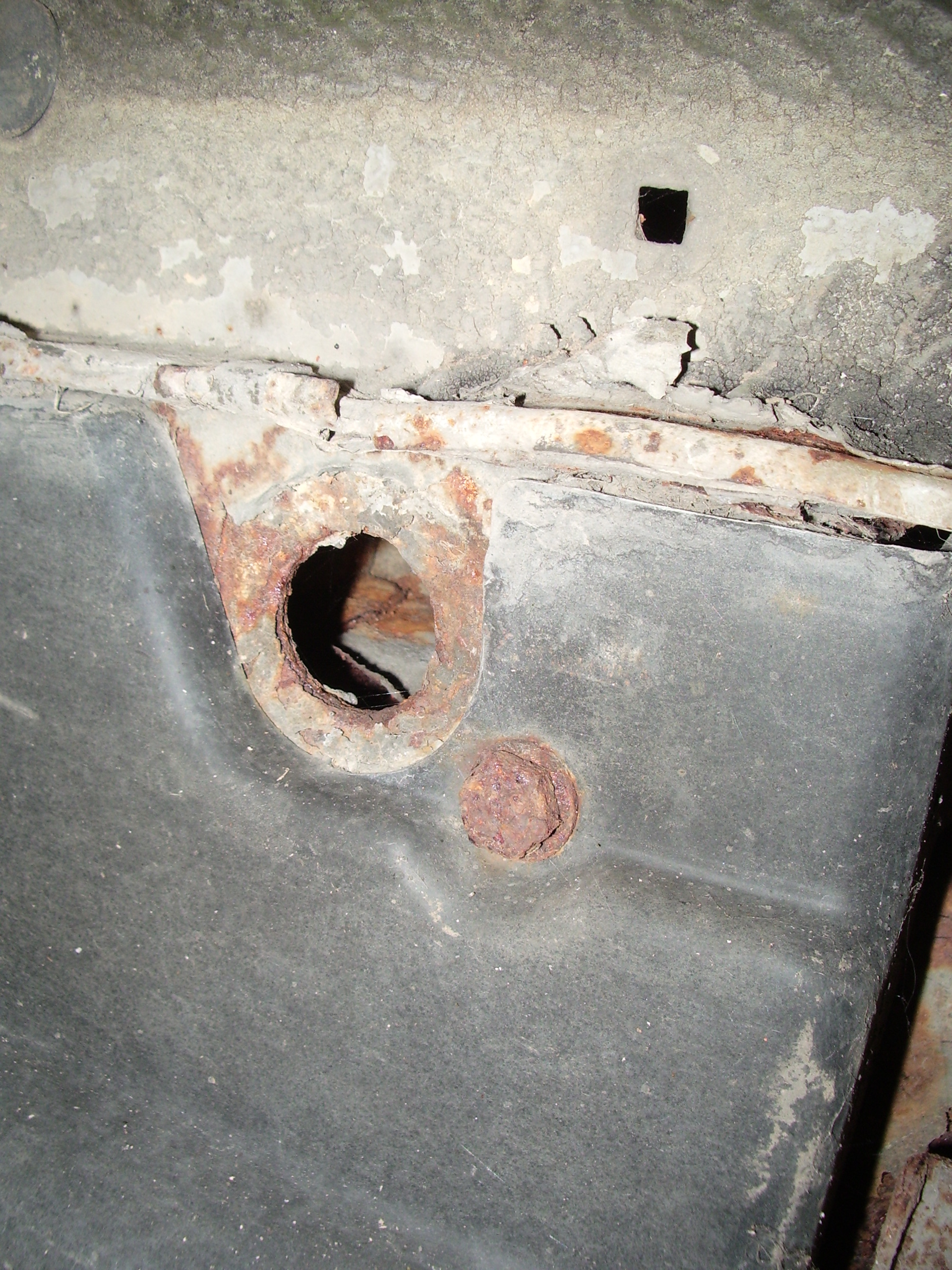

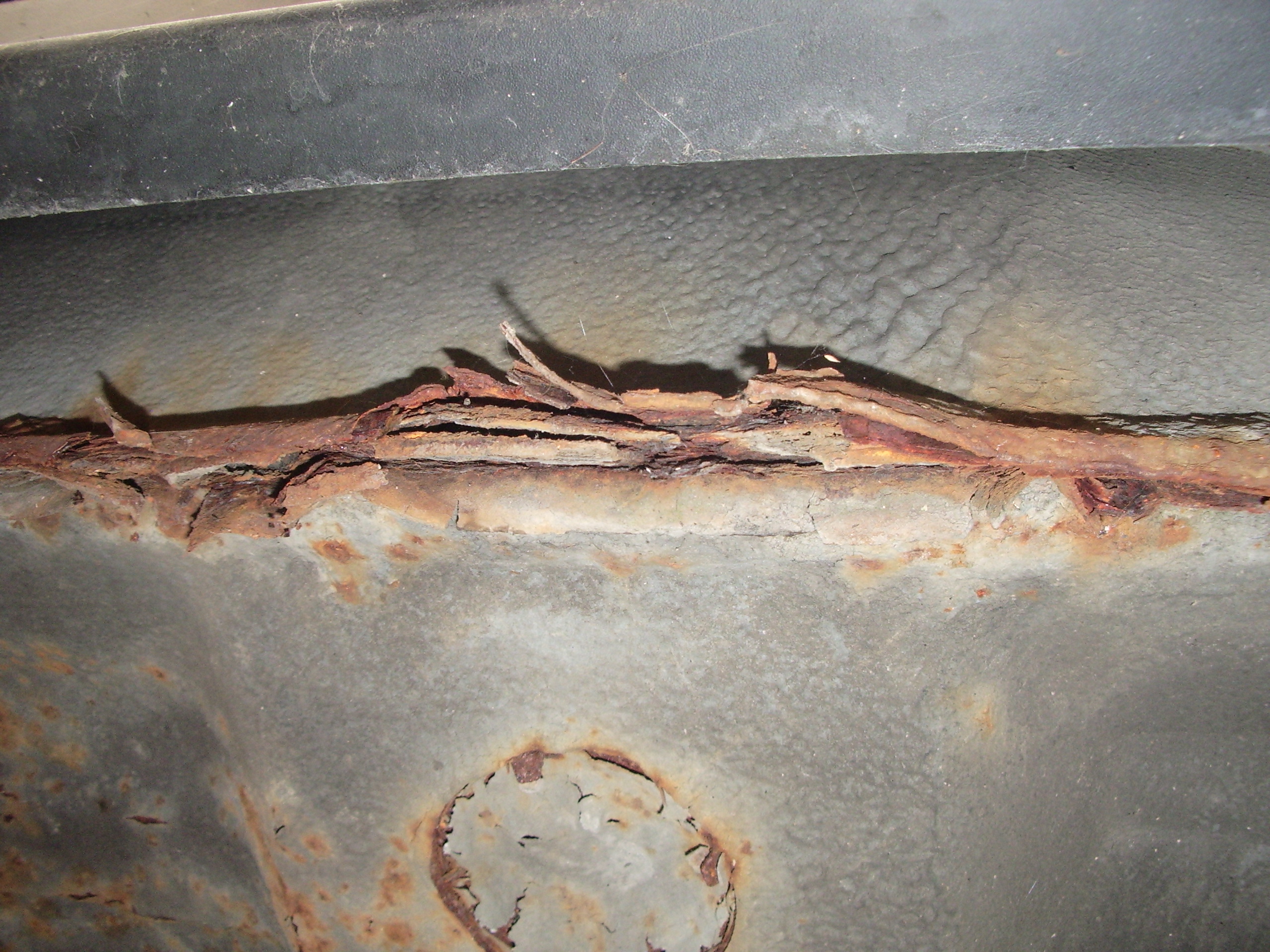

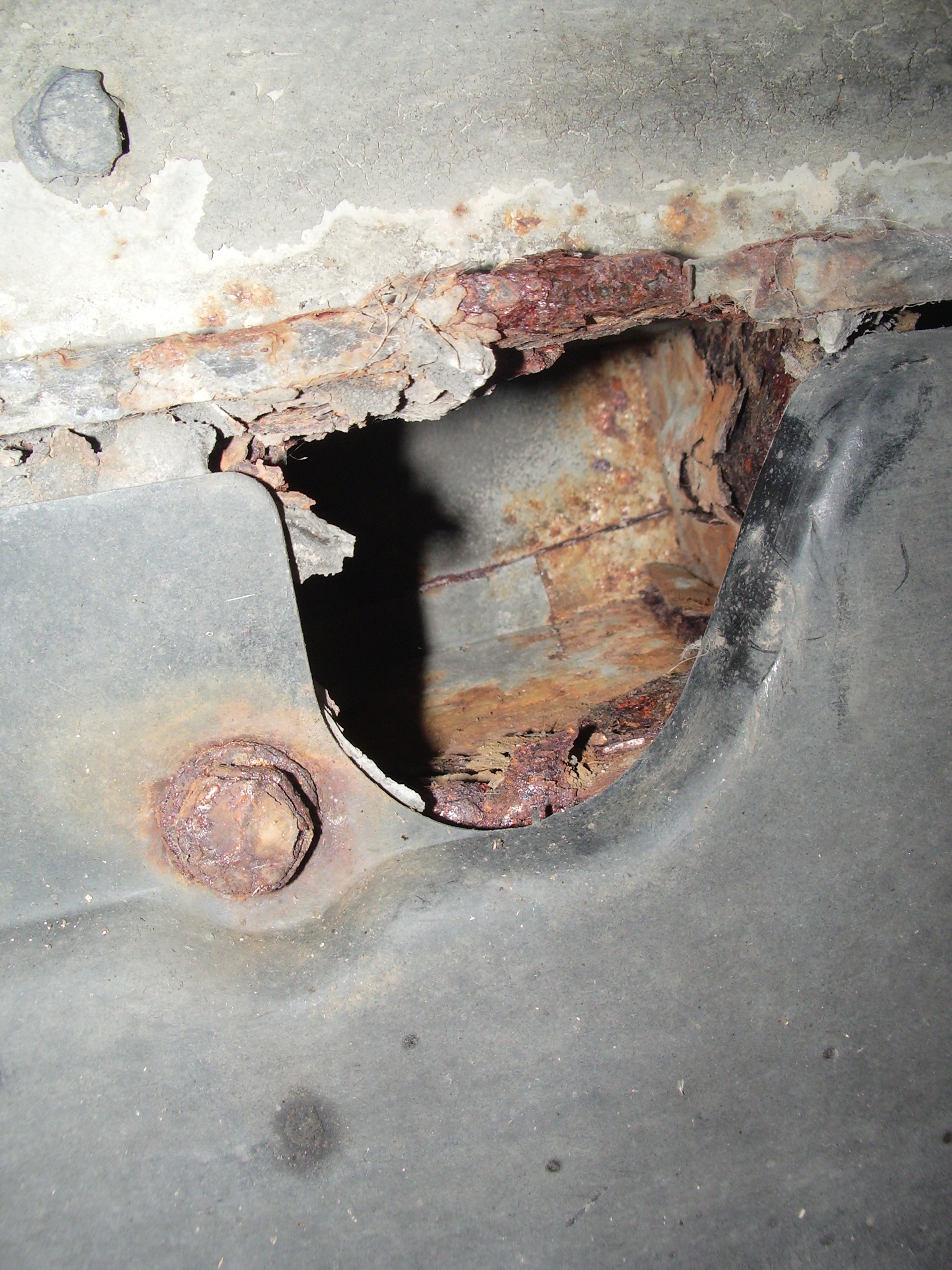

Well after closer examination I found the jacking points, and it seems a recurring theme with this car is rust and lots of it! The nearside rear jacking point looks fine but the offside rear is pretty crusty, not much of a surprise. The position to place the block of timber at the rear of the spare wheel well looks pretty grim too.. looks like I better invest in plenty of gas and welding wire for the mig welder!
top left photo is the good n/s/r jacking point, top right is the rather crusty o/s/r point. It seems fiats well intentioned plastic wheelarch covers and pipe covers created some lovely moisture traps for rust.. bottom picture is the rear of the spare wheel well.

personally I would use the jacking points as much as possible, using plates to spread the load as much as possible too,
then position your spare wheels as far back as possible under the sills/ floor area,
IF the worst happens the weight of the engine+ box will keep the front heavy and the back will still be UP on the spare wheels / remaining axle-stand,
