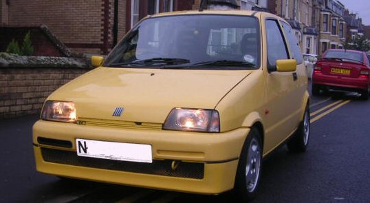

It's very low though, but doesnt touch the arches, probably cos I've got 13" wheels
and this is a big pic of it when it was still on the 185/60/r13 tyres

it might not be sat on them, but its very near - meaning i have little to no suspension travel on the fronts
that top pic looks a lot lower than 40mm mate.. closer to 60!!!
i was measuring mine up the other day, and yours looks a lot lower than i had planned for a 40mm drop....
just cut a bit more off the stops, an u aint gonna get a lot of travel till u are touchin tyre to arch with that sort of distance!

Like he said if you measure from the very centre of the centre cap to the top most part of the arch I think a Standard Cinq is in the region of 340mm, so yours being 280 means thats a 60mm drop (Just like Pete said).
i measured from the centre cap of the wheel, the where the wheel arch starts. the metal, not the lining (mines come away slightly from when it used to rub!)
