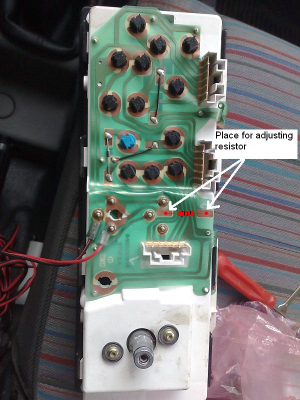

Yes Jangcy, I suppose bechause of that on the back of instrument panel, there is place for adjusting resistor to be soldered in case of diferent value of sender. See attached pic

oh Yes...I found it last time when I was fitting rev counter in to clocks...will send pictures sometimes on weekend...
and in one model I had just wire and in other I had resistor....
also there was about 3-5 liters different between fuel gauges :confused:
oh Yes...I founf it last time when I was fitting rev counter in to clocks...will send pictures sometimes on weekend...
I Agree, suppose - bechause we have Panda - models with 42 lit fuel tank and 32 liters fuel tank, so resistor make correction of pre-resistance of fuel-level sender himselves.
hmm I've got Panda with injection and clocks were from 750 carb...you may be right...there could me some differents...I think plastic tanks are 42 and 35 liters....
