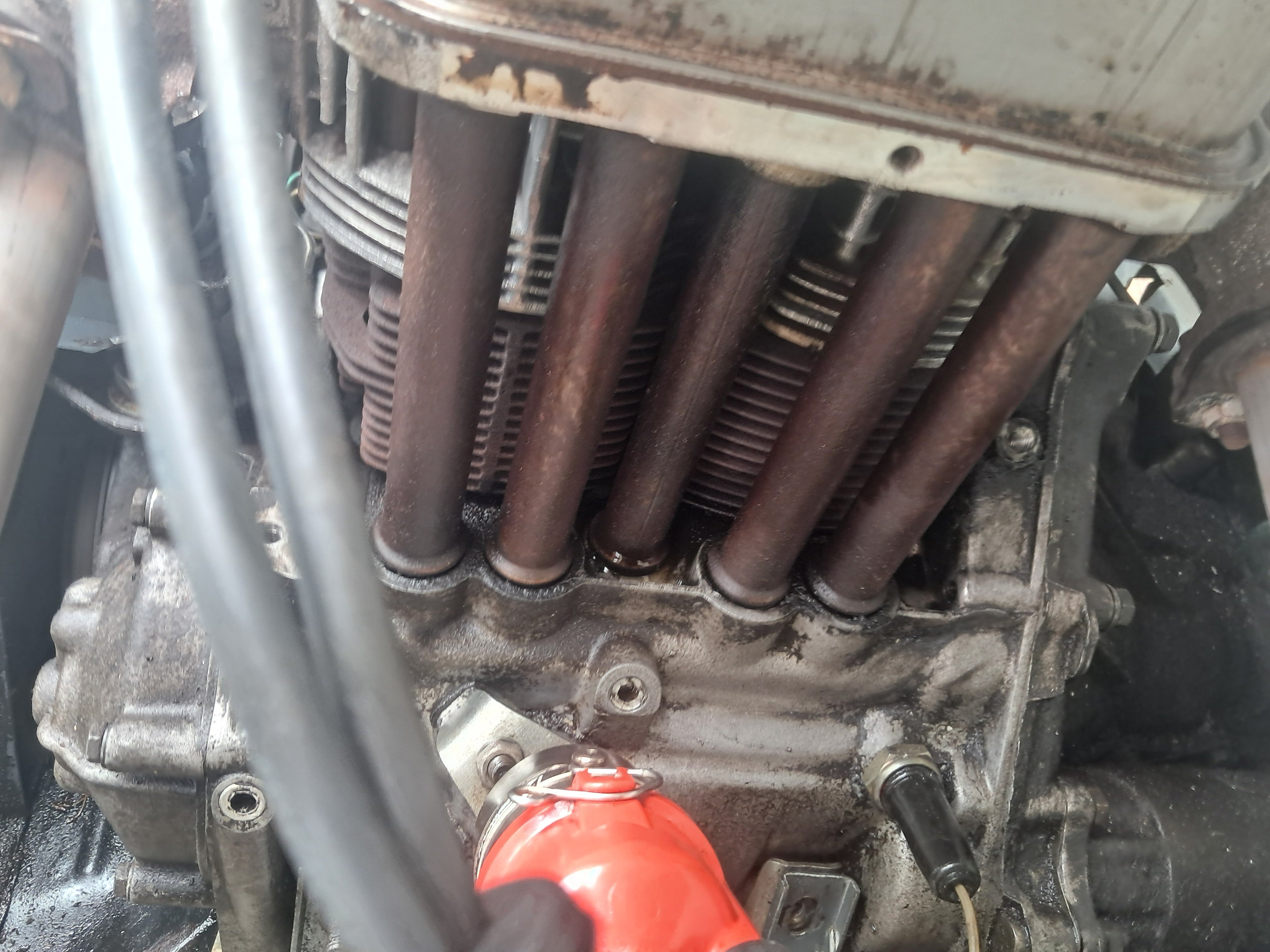

Problems with the clutch "might be fixed" but will update that thread when im sure. Then like every oldtimer we shift to the next issue. An annoying oil leak. This issue started after servicing the engine and replacing the valve cover gasket.
I will replace it soon again, hopefully correct this time. But, does this cover look dented? And how can I make sure I dont overtighten it/pinch the gasket.
- Rens
Another update for the oil problem. After replacing the gasket twice the problem seems to not be fixed. This might indicate a leak at the pushrod tubes sadly. To make sure I removed the thermostat housing.
So.... Is the oil I'm seeing actually pouring out of the engine or is it being blown about by the fan on the other side.
I will try to remove all the oil when the engine is cold again, but that is a hard task using only paper towels.
