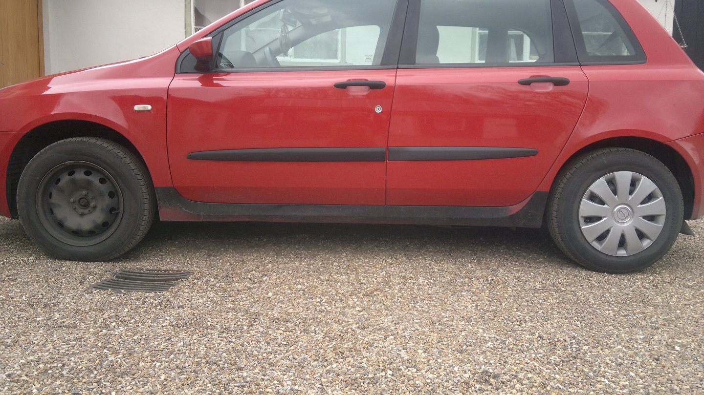

Thanks for your kindness.I still have the old shocks and springs as well.It never really crossed my mind do check if are the same.I will atach a picture to see how my car stand.Thanks again.

Looks like wrong front springs. Bear in mind they will be different for different engines, especially diesel.

BTW looking at the photo it does appear that the front of the car is higher than the rear but the sill is level with the ground.

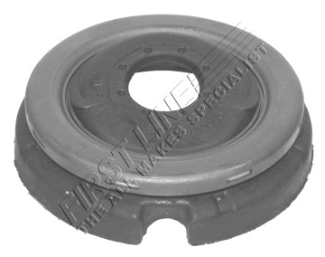

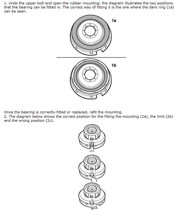

Are you sure you assembled the top mounting parts correctly?
The bearing should clip into a groove on the lower part of the mounting (as in the first picture below). If you didn't clip it fully into the groove, the steering could be tight and may not self centre. It must also be the correct way up. The grey metal part should be to the top (as shown in the top half of the diagram below).
The two rubber parts of the mounting must be aligned as in the lower half of the diagram below.

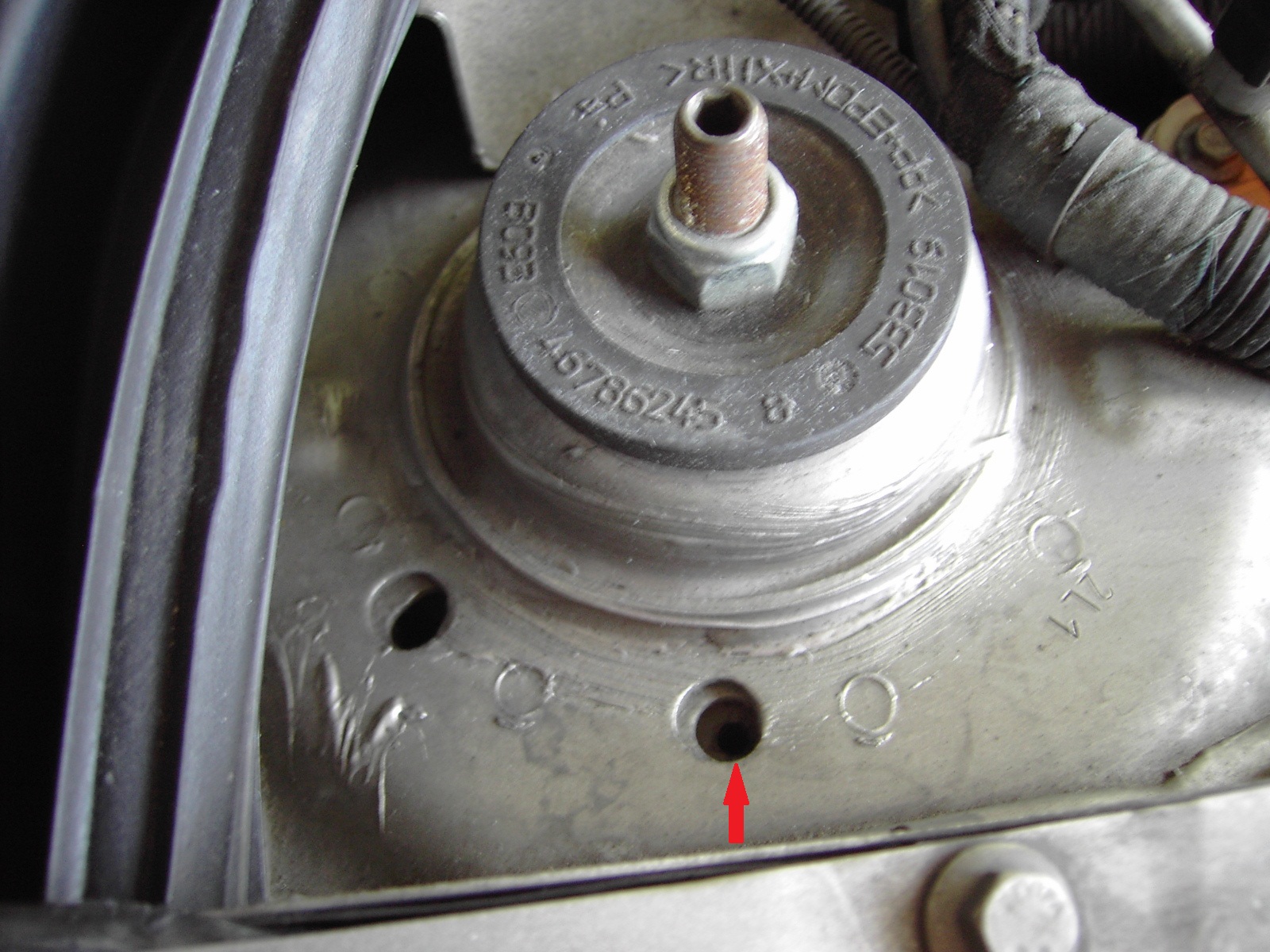

If you look through the hole adjacent to the suspension turret, (as shown in the second picture) you should be able to see the small round hole in the top part of the rubber mounting when the front wheels are at any angle, i.e. straight ahead or turned.

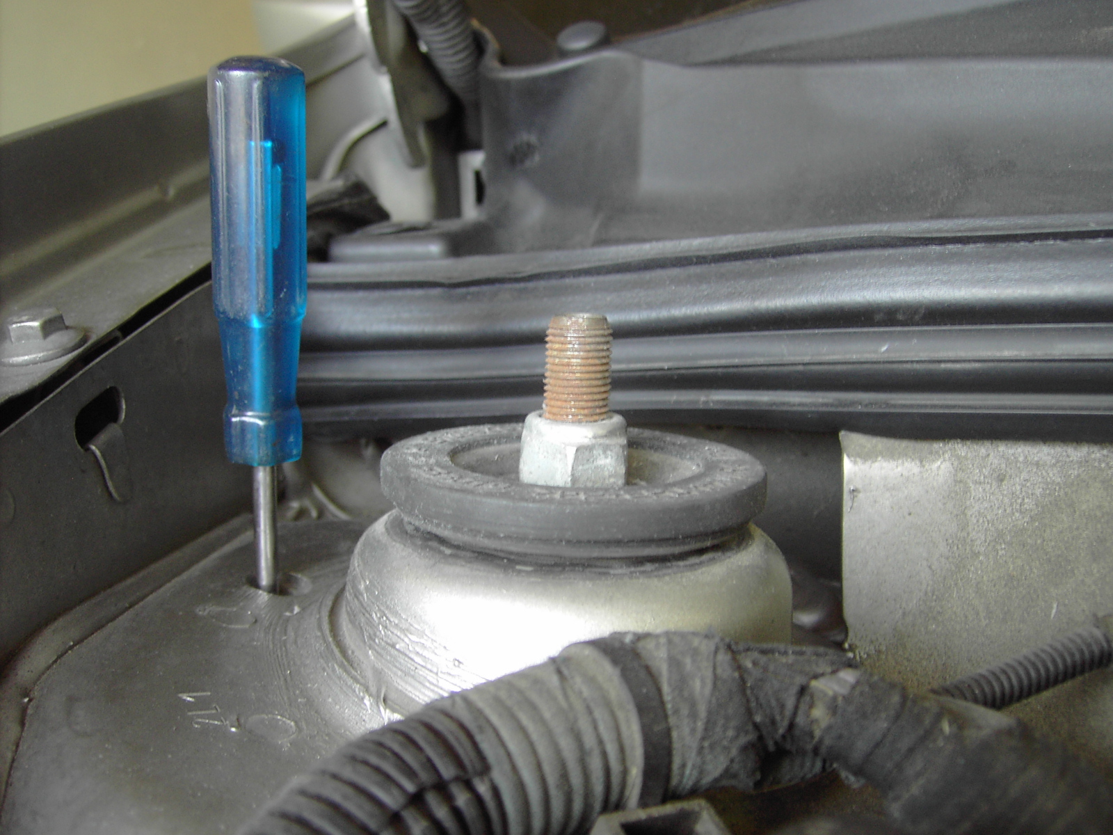

With the front wheels straight ahead, a 4mm diameter rod should pass vertically through the hole in the turret, and the hole in the top part of the mounting, and the cut out in the lower part of the mounting with very little resistance (as shown in the third picture).
