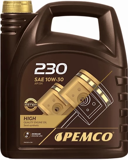

At my previous service I had changed the oil filter and for a while it stopped coming out

Isn't it supposed to be 5w-30?
It'll take 10w-30 longer to warm up and become as viscous as the engine wants.
Personally I'd change the oil, but you could leave it, as only minimal extra wear and tear will be caused between now and the next scheduled oil change.
