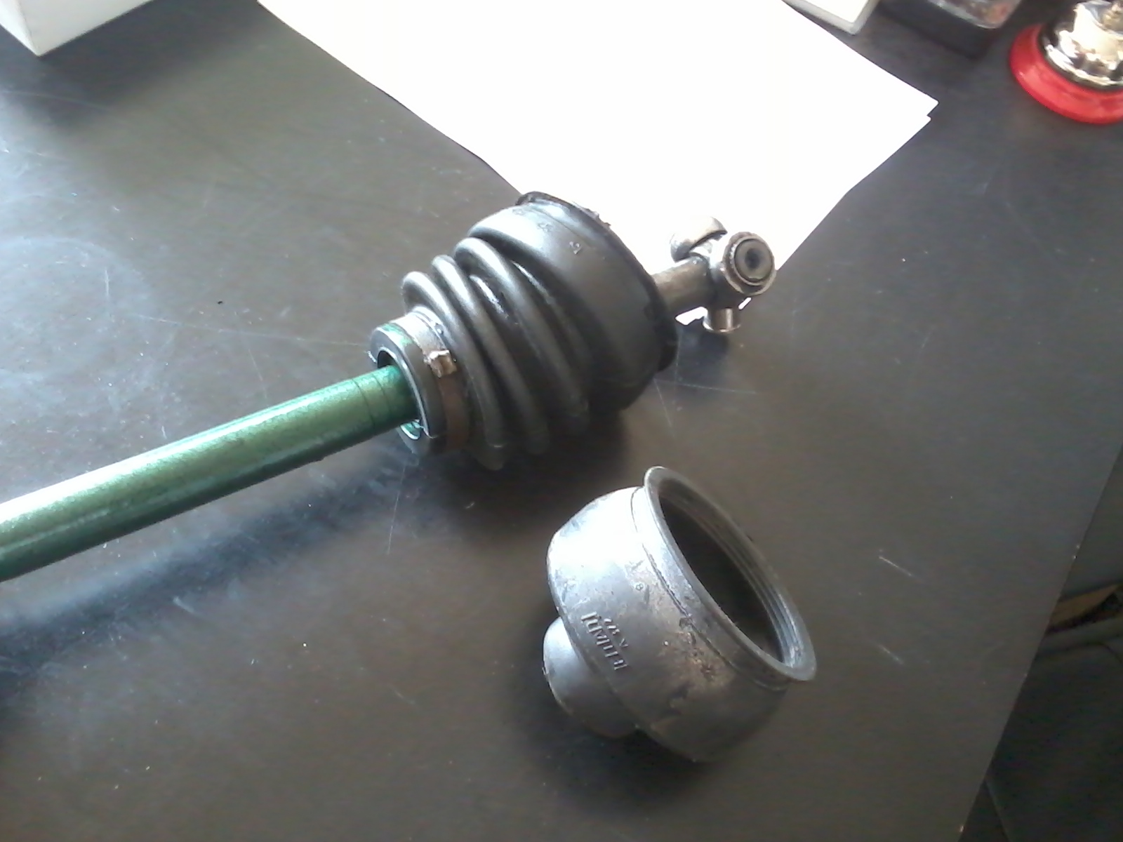

You will have to take the shaft out of the gearbox. It stays in the same place on the shaft, hence it is a press fit, the haynes manual says the bearing should be 123mm from the end of the right hand shaft and 143mm from the end of the left hand shaft.
The way I would do it would be:
1. Slacken off 30mm hub nut with car on the ground.
2. Jack up and remove wheel and brake caliper.
3. Drain gearbox oil
3. Split the bottom ball joint and remove the two bolts holding the hub carrier to the the strut
4. Remove the hub nut completely then lever the suspension arm down so you can lift the ball joint out and remove the hub carrier, leaving the driveshaft in place.
5. Remove the three small bolts that hold the gaitor to the gearbox and then pull the shaft out.
6. Put the shaft in a vice, cut the old gaitor away for better access to the bearing, remove the tripod joint and drift the bearing off the shaft. If it is past it then it might just come off by hand.
7. To put the new bearing on, put the bearing inside the new gaitor before drifting it back on, then put a clip or cable tie round that end.
Can anyone give me a bit of advice? I'm renewing inner and outer gaiters on the right hand d/s. Reading this post tonight I realise I have drifted the bearing too far along the drive shaft. The drive shaft is not yet back in place - that's the good part - but what chance will I have of drifting the bearing back in the other direction 6mm without damaging it or the new boot? Why didn't I read the back part of the Haynes manual BEFORE doing this job...? Could I just risk putting it back together as it is or will it stretch the boot too much?
6mm is not much so I don't think you will have any issues as there is plenty of stretch in the boot, but you should be able to drift it back without damaging it if you are careful.
