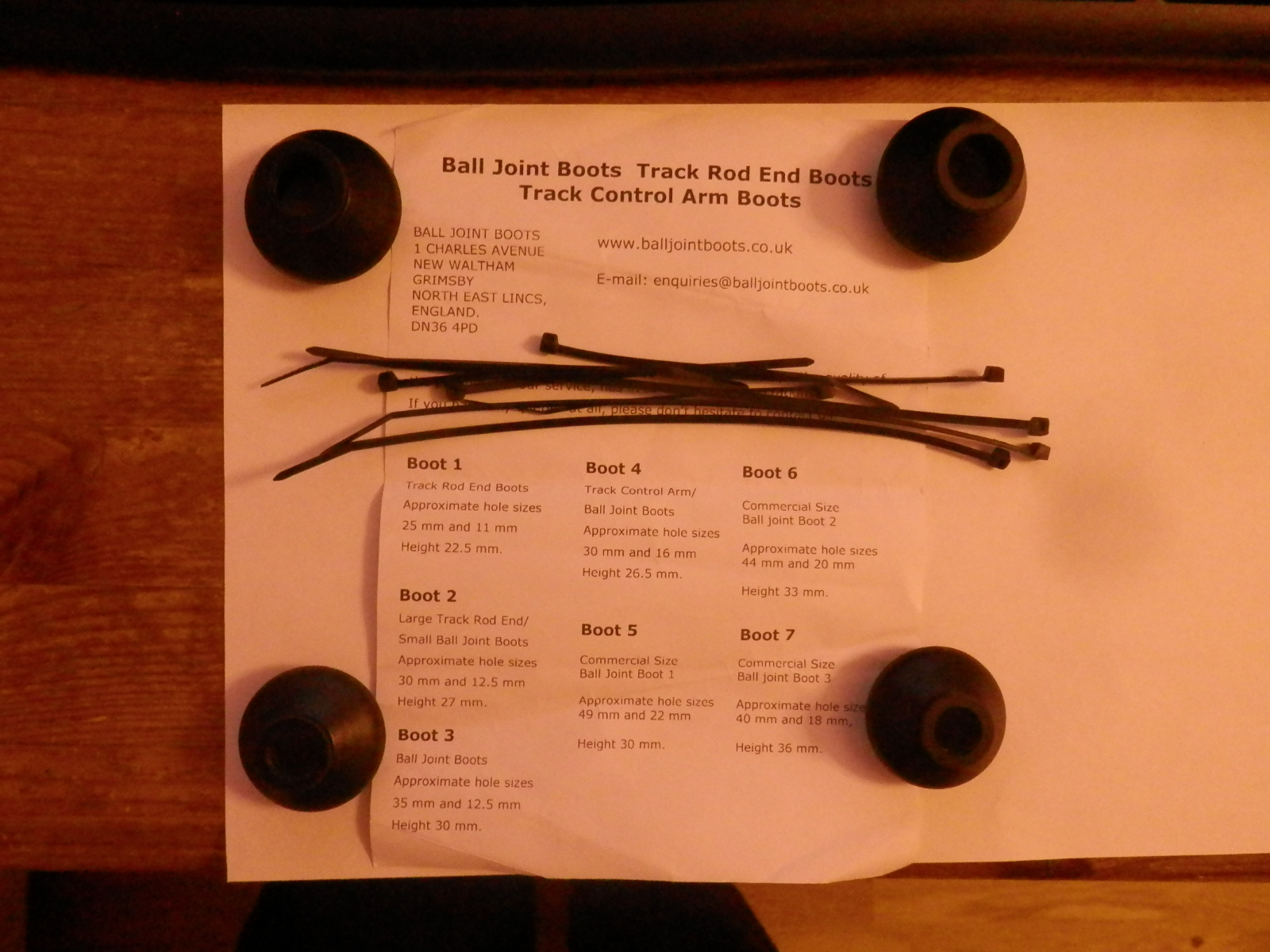

Thank you for the advice. I didn't know you could get replacement ball joint boots as the Haynes manual says you cannot. Looking on eBay it seem that they are universal boots that you get in a kit and just kind of size up the best one and slip it on.
I have boots 1 and 4 (from measuring them today)
I got the boots a few years ago. I cannot recall how I went about specifying my order for those boots. They do look about the right size but I only just opened the packet.

With replacement boots be aware that here in the uk the rain water and road salt can very quickly wreck the joint if the boots split. So it may need replacing anyway, and if the boots have perished on one end of the control arm then the bushings on the other end of the control arm may also be badly perished.
If it’s just torn and it’s happened recently you’d probably get away with a replacement boot/gator on the joint

Thanks, Andy. I just picked up a set of new arms. They were only about £30 each for some ones from FAG (brand). Figured it would just be easier to swap them as I've still got to disconnect the arm from the hub knuckle to swap the boot and that looked just as fiddly.
