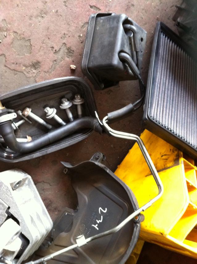

those two metal pipes that go over the engine have got nothing to do with swirl flap mechanism!
they are both connected to a black sealed box - i don't know what that is (some sort of vacuum buffer maybe), and they go back and operate the turbo actuator!
when i was replacing manifold i was cursing fiat for putting that box (pic below) in there because it should/could be mounted somewhere on the front of the engine - to explain it simpler - it goes from vacuum pump via one of those metal pipes all over the engine to the black box that is mounted on the inlet manifold and from the black box via second one of those metal pipes back over the whole engine to the turbo actuator valve
swirl flap mechanism is fully electric driven - no vacuum connections to it

Well that's embarrassing! You're correct in saying that the vacuum pipes don't operate the flaps. The black box is in front of the rod that I thought was controlling the flaps, but it seems that this isn't the case. Can anyone tell me where the actuator is?
The funny thing is that the car runs much better with the vacuum pipes bypassed, but I need to know what they are for.
like i explained in my earlier post they operate turbo actuator, by bypassing that box you got a direct vacuum from the pump straight to turbo actuator valve
Can anyone tell me where the actuator is?.
It is behind and slightly offset from the black box (vacuum tank) your bypassed the hoses on.
Its exact VISIBLE position I can't confirm because it is so tight to the back of the engine block it is not possible, even with a mirror, to view it from the top of the inlet manifold. Definitely a view from below job and I suspect because it is so high up it is also possibly difficult to reach/access from below the car and having to get around streering rack, drive shafts, pipes and cable looms. Blink dumb place to put a component that is likely to fail.
I had a bloody good go at accessing mine form the top of the engine and gave up. Next time I do a service and oil change I'll look again but I'm not looking forward to it. High up, restricted access, etc.
All in all a frigging (n) and :bang: and :devil:'s own job UNLESS somebody has another :idea: idea.
Thank you arti_abarth, I will put the pipes back the right way round asap! I have new silicone hoses so hopefully they will last longer than the originals.
Thanks S130 , I think that must be the rod that I saw previously. I will have another look but, as you said, there isn't much access there!
