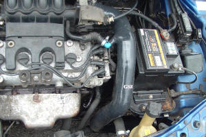

8v induction
The GSR kit positions the filter cone behind the battery, a naturally cold and dry position in the engine bay, giving proven dyno-verified gains. The silicone pipes are shaped to provide optimum airflow to the engine. Available here
16v induction
Filter located low-down in the engine bay where the air is cold, but still dry. Again, proven gains with this kit.

Mike's GSR picture -
The Cinquecento tuning guys say that the intake elbow on top of the throttle body is very restrictive and its one of the first things they junk. However, GSR keep it in place. Yet more stuff to ponder.
