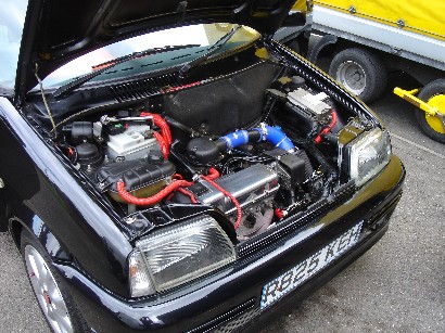

Best way to do it is buy a gsr kit, as it comes with the "bob" (bit that goes on top of the tb,) off an 899 cinq/sei, a silicone hose and a filter that goes on the end.
Or failing that, go down a scrap yard, take a TB cap and seal off an 899, then buy a 65mm-50mm silicone reducer pipe from demon tweeks (or wherever else sells them.) and a 65mm pipe joiner from the same place. Then buy a universal filter to stick on the end. have a look around the galleries for pics, theres plenty on there. heres a few ideas:
this is the GSR kit,
this is how to do it with the 899 cap and some silicone hose!

dont bother using those little max power crappy breather filters :rolleyes: because they vent oil fumes directly to the atmosphere which may cause issues at mot time and oil splatter will come up and out of the filter and down the back of ur engine (n)
your best bet is to tap a hole into the bob and screw in a metal outside hose attachment like on the gsr kits and attach your breather pipe to that, as shown in the pics above (y)
