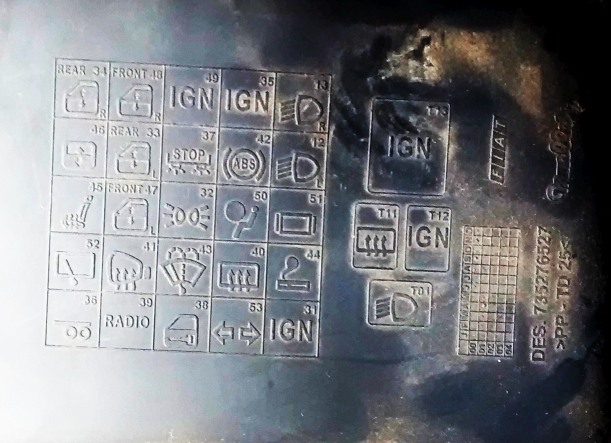

OK, so I took another look while the hazard light were on and followed the "clicking" sound to the fuse box (lower left and side of the dashboard). I put my finger on the large cube (see photo) and the clicking sound kinda seemed to be coming from there, although I also placed my finger on other parts of the fuseboard and could also feel "clicking" (never heard / felt any "beeping" though).
1) I removed the cube but the hazard lights and indicators continued working.
2) So now I wonder if I have to REMOVE the fuseboard and take a look behind it?

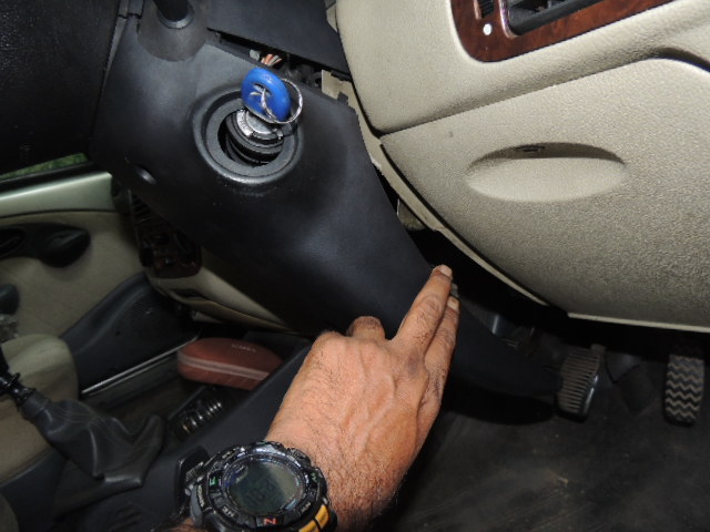

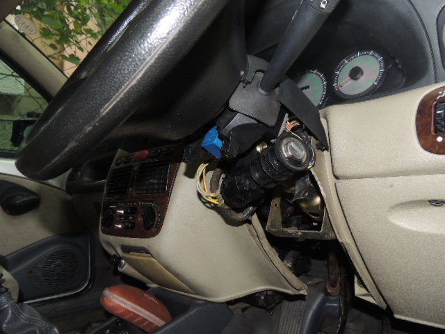

Follow these instructions carefully.
Just feel your way down from the steering to the bottom of the car. This conduit like plastic piece is called a steering cover, lower.

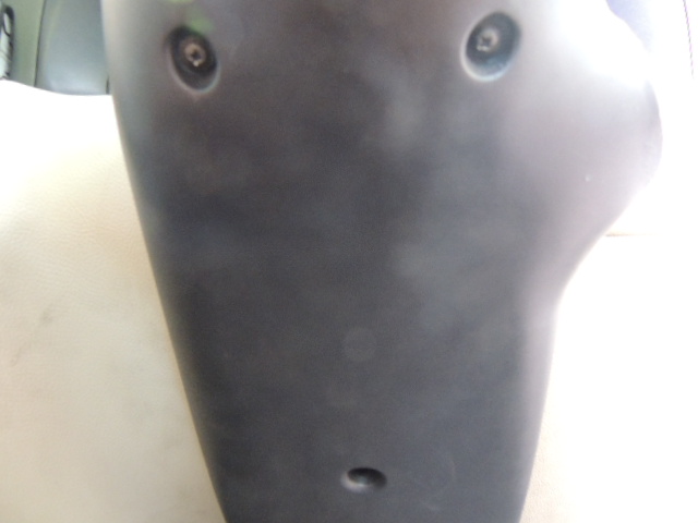

Now if you kneel and look up at this, you'll find there are three screw fasteners holding it to the housing, two towards the top and one on mid bottom. Remove them with a star screw driver and take the cover off.
Now you'll see a blue relay just under the horn assembly that needs to be tickled out. Be careful - there is a clip inside on the left hand side so it comes out with a knack and not brute force. Find the way to do it. Nudging from the right and pulling out is what I think I did. If you break the clip, the relay wont sit firmly the next time you insert it (with a "click"). Don't get scared, try it, and you'll be fine after a bucket of sweat .:)
