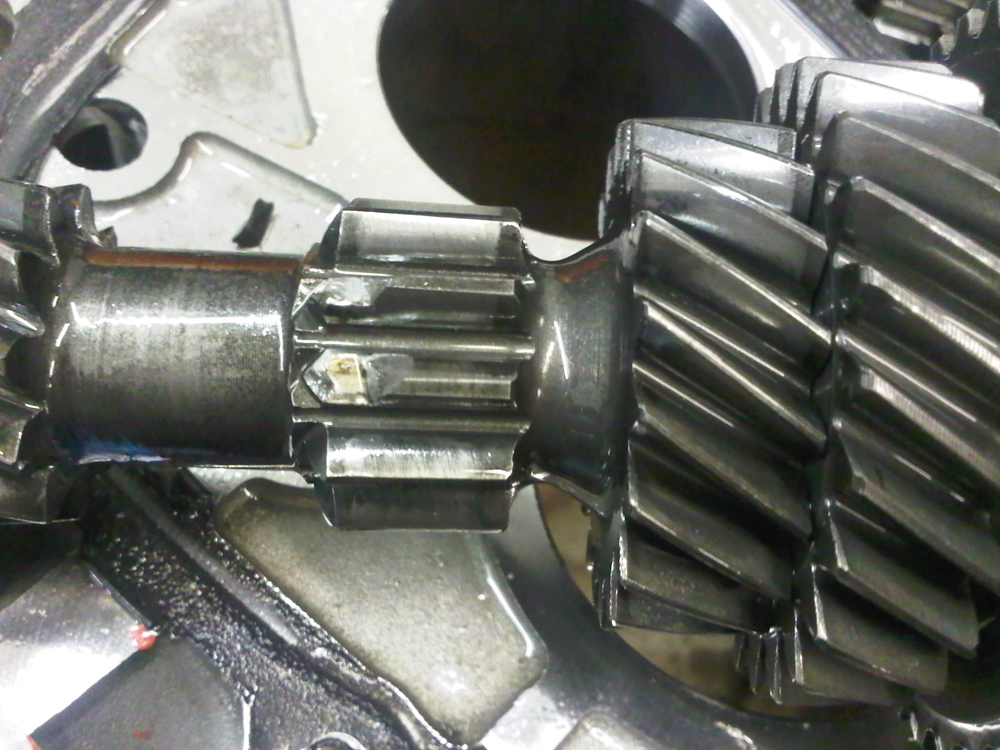

The news from the battle from is . . .ta daa! A broken tooth off reverse gear. Looks a proper mess too! At worst I've seen these go through the gearbox casing. . .

Fiat customer services were as good as their word and called me back today and have emailed the warranty dept to push for a new gearbox to be fitted as soon as possible. Having looked at the pics with all the damage, a repair to the box is not going to be an option. All the damage is within the gearbox and diff and theres a fair bit. (Can always post the pics if anyones interested) I find it hard to imagine that Fiat won't authorise the box replacement as to do the kind of damage thats been done I'd need to be a 9' Neanderthal with a huge left bicep and little knowledge of the clutch!! They promised me a call on Monday. . .
Hopefully I’ll get the car back before Christmas . . . That’s Christmas 2011!!! :ROFLMAO: At least it'll keep the mileage down
Here ya go . . some of the pics are blurred, but this one speaks for itself really

Thanks for the picture. Interesting that 2 teeth have sustained damage, and that one is more deeply chipped than the other.
It looks typical of damage caused by slamming the car into reverse when moving forwards. One possible scenario - this happened during delivery when some ham fisted transporter driver was shunting it about, and the 'bang' you noticed was caused by one of the missing bits jamming elsewhere in the mechanism.
Oh I agree. Heard the 'bang' at approx 30 mph on a main road travelling in 4th.
It's either a manufacturing fault (Unlikely as the quality control on these production lines is pretty good) or as you say some bloody great goon that's caused it. The tooth must have had a hairline crack and as it's come adrift at warp speed taken the other ones with it. When you consider the speed of the gear train when the car is in motion and is also a spinning motion, it's no wonder that damage is so great. Must have been like bullets flying around in there. . .and all the wife wanted was a funky new car . . .LOL.
