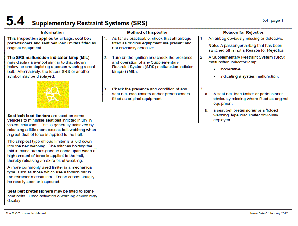

Since January 2012, if a car is fitted with airbags as standard equipment, it will fail an MOT test if that airbag is removed or disabled. Do not fit a Momo style steering wheel without an airbag on a car that is used on a public highway. It will fail an MOT. See capture below...
