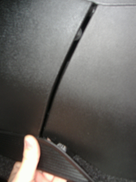

to gain access you first need to remove the trim
put your fingers under the trim near the false vent and pull away
once released along this edge pull the trim towards the back of the car
as the front edge is held in place by a hook which locks into the side of the heater control unit until it comes free

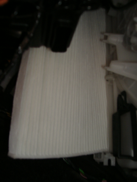

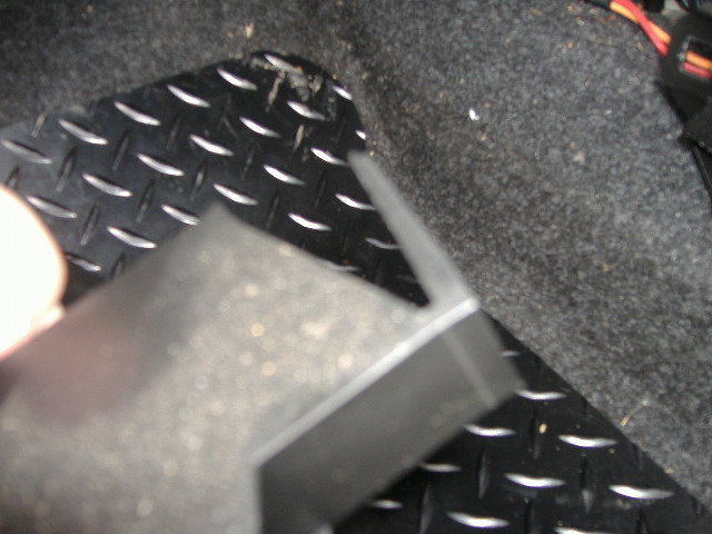

Once the cover is removed remove the old filter (if fitted in the first place) then use a small artists paint brush and a Hoover to remove any debris

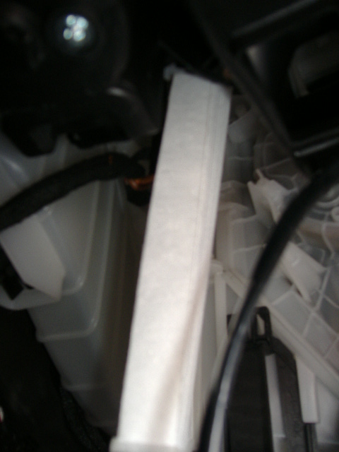

next insert the new filter (i gave mine a light squirt or AutoGlym Auto fresh on the inside of the filter element)
(airflow indiator on the filter needs to point into the car /towards the back of the car)
This is a bit of a pain to get in you need to push the top edge then the bottom bit by bit working alternately

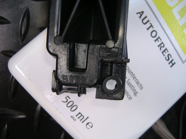

once fully home you need to refit the cover (this has a wrong and a right way)
this is the bottom edge
you need to hook the top on first after pushing the filter slightly further in with one hand whilst locating the top catch (as it expands tight against the cover to make an air tight seal)
next hinge the cover down and clip the lower on (refit the screw if fitted)
next refit the trim by hooking the front hook onto the side of the air box
then reclip the rear section back in place
