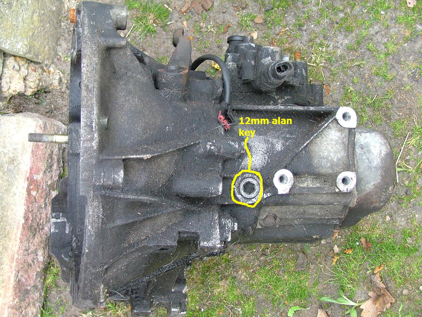

look on front of box you see a plug that needs undoing with a 12mm alan key you fill from there put tray under car, when oil starts to come out of hole stop filling wait till drips stop then its full, replace plug

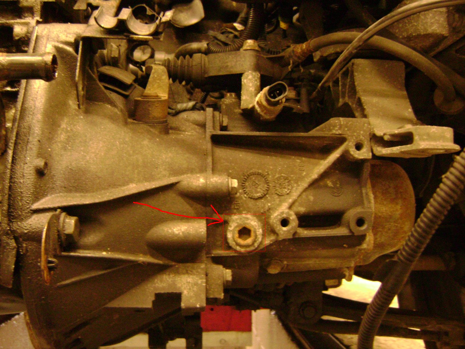

the drain plug is on the bottom of the diff, facing towards the back of the car
