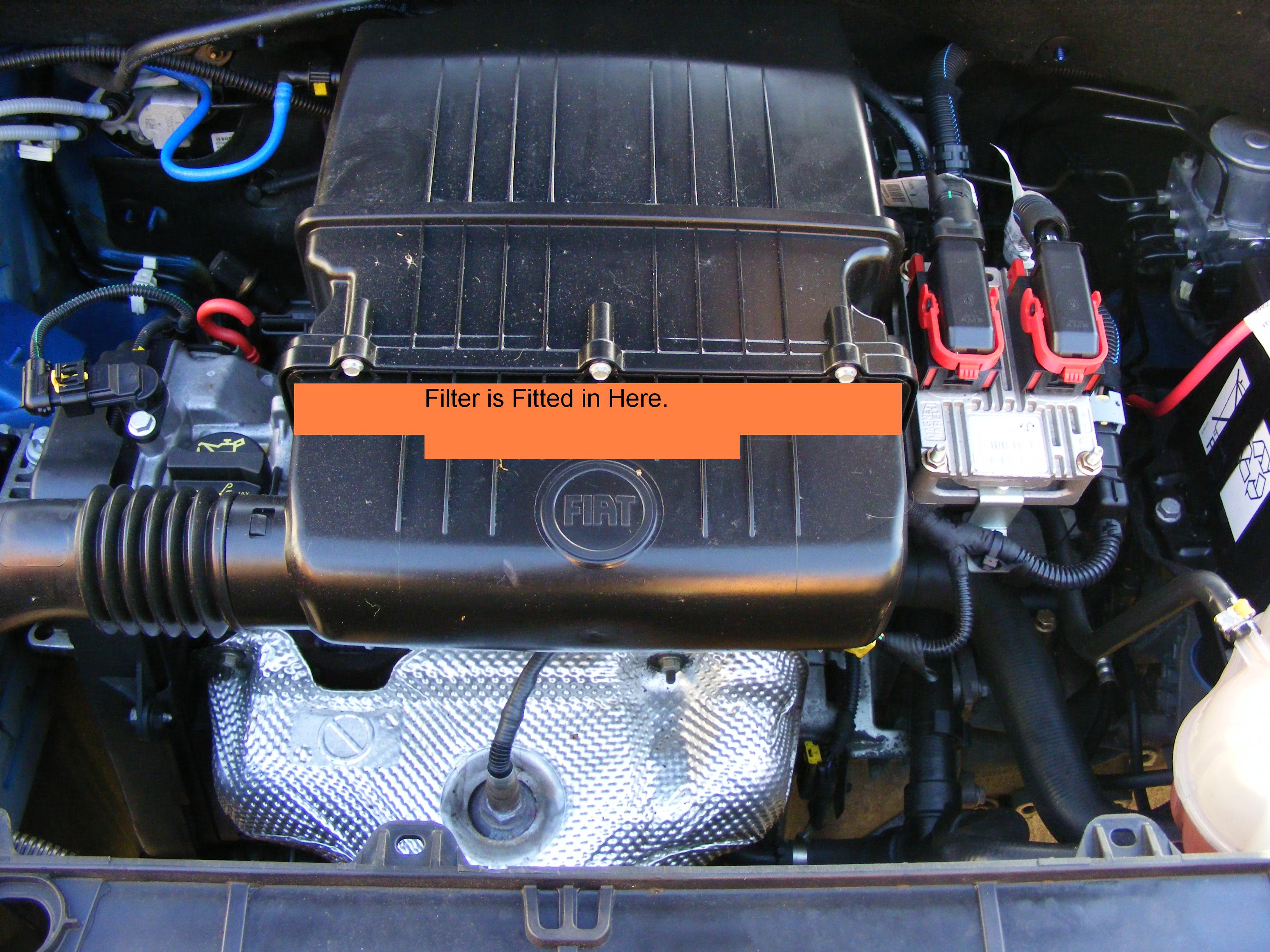

open the bonnet the air filter is housed in the big black box on top of the engine
this is held in place by 6 bolts which have a 7mm head there are 3 along the top and 3 along the bottom
once all 6 are loosened (they stay in the lid so you don't loose them) pull the front cover away and you will be met with this
