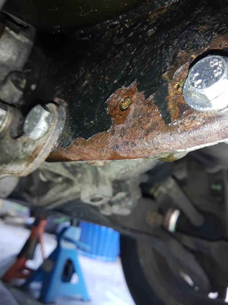

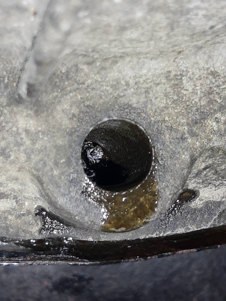

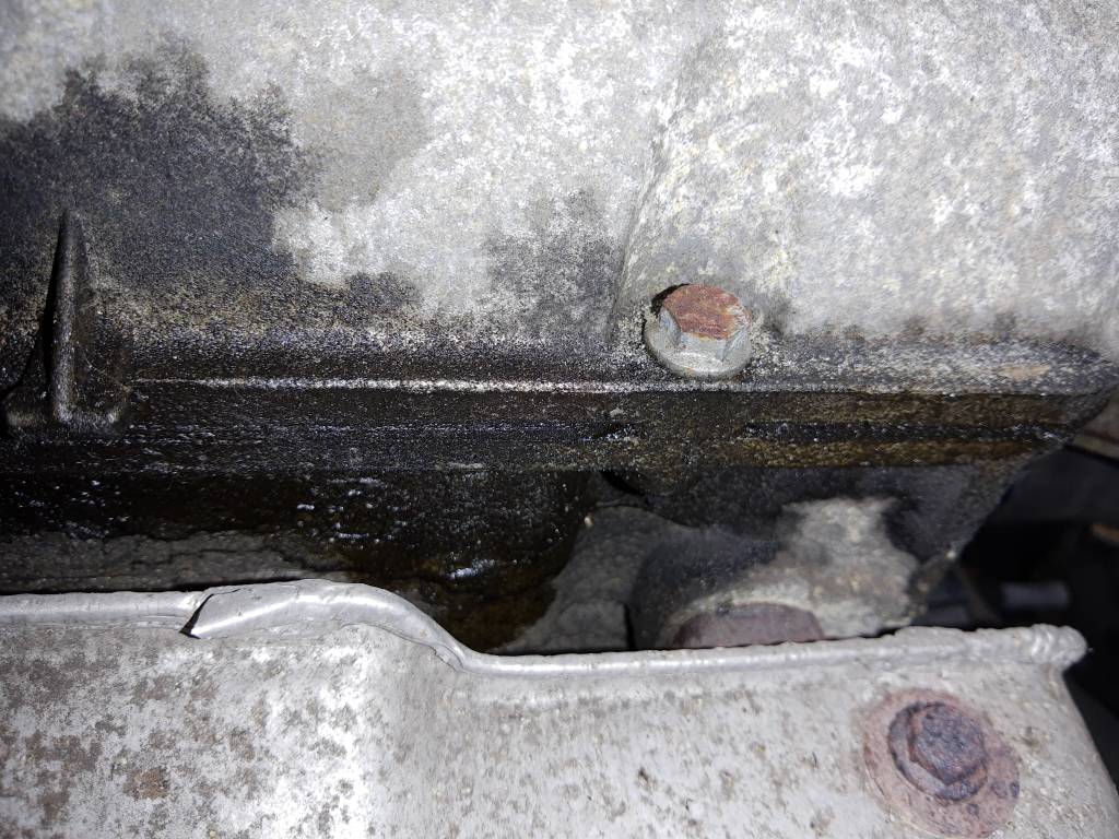

Hi.
Well I found my oil leak.
It's leaking from this hole but may be coming from the crappy looking tin cover thing on the other side (pic 1).
Is this a common thing? Nice easy fix to do on a driveway?
To be fair the sump sealing isn't the finest work ever so could be a comby job.
Cheers
Toby IMG_20200407_110100613.jpegIMG_20200407_110223216.jpegIMG_20200407_112058134.jpeg

Will try the o ring 14463980 on the ignition coil.

But I think your problem is the clutch end crank shaft seal. The only fix for that is separating the gearbox and removing the flywheel. If it gets any worse the clutch will start to slip solving any worries about what needs to be done.

It wont have 'failed' in service :)
So..
Strip and clean.. put the O ring back in.. but with 'instant gasket goo' in and around..
Ive never needed to do more than this ;)

Will change the rocket gasket as that's rubbish and reuse the o ring with some hylomor.

Cinq section has GUIDES .. prise out the tin baffle plate while its off.. catches lots of crud that does :(
And as soon as you refill with oil.. it tries to flush it all back to the sump :eek:
