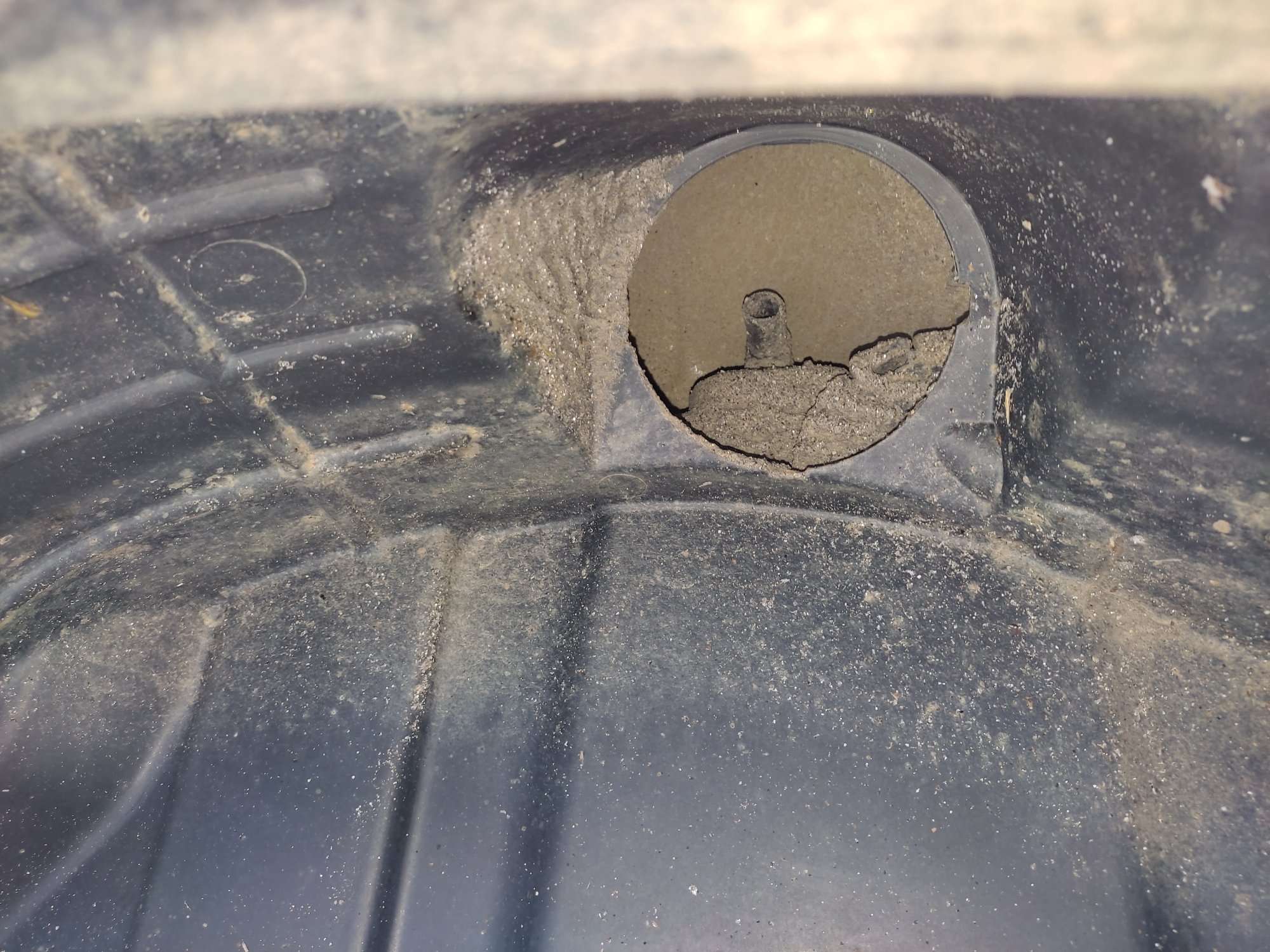

I am considering purchasing a used Panda 4x4 (2019), and I inspected one a few days ago. I noticed a hole in the left rear wheel well (it is not present on the right side). Is something missing from there? Do you have any advice for someone buying his first Fiat Panda 4x4? Is there anything I should particularly watch out for?

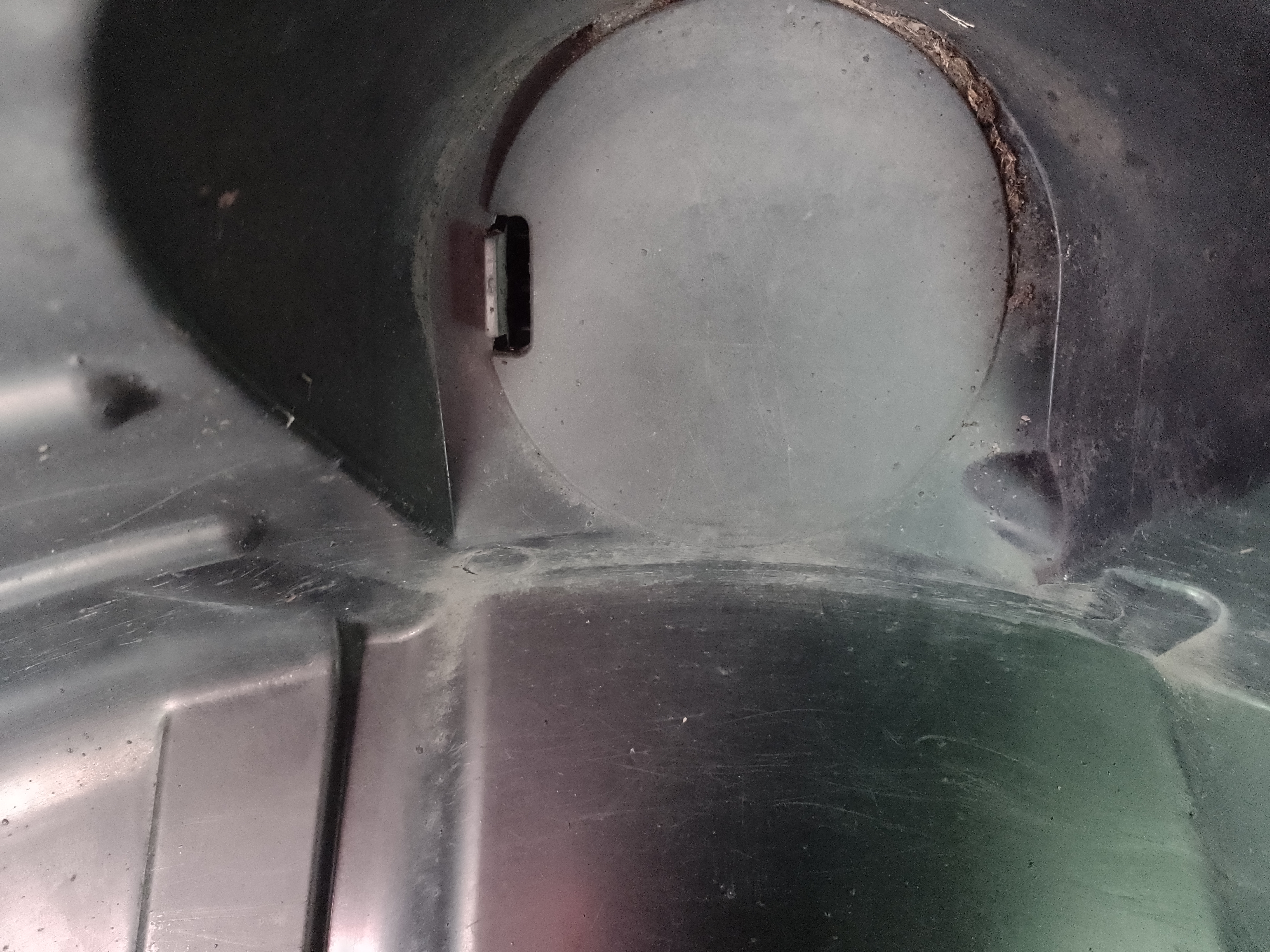

On the normal Panda's it'll be on the driver's side, there is usually a round cap like this on my car
Not too sure what it's for though
I believe it should have a plastic cover over it (just to keep dirt away) , and gives access to part of the fuel tank breather system.
'Drivers side' on a right hand drive car (note original question from Budapest, so passenger side there). Same side as the fuel filler.

Thank you for the quick replies. So does this cap serve only a cosmetic purpose? Can extended use without the cap damage anything important?

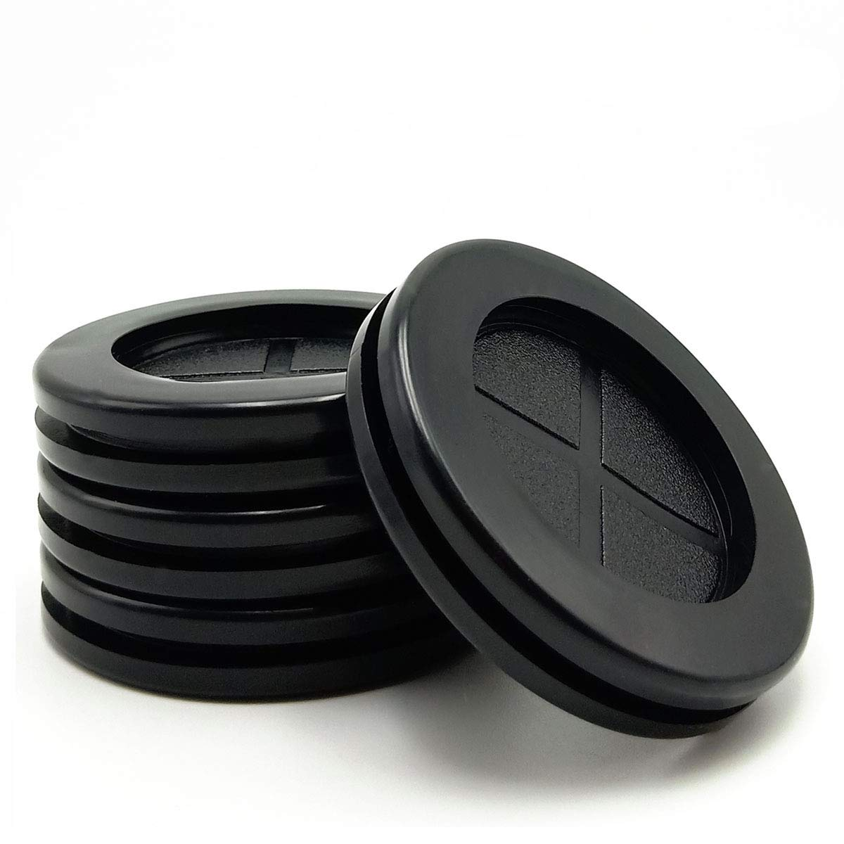

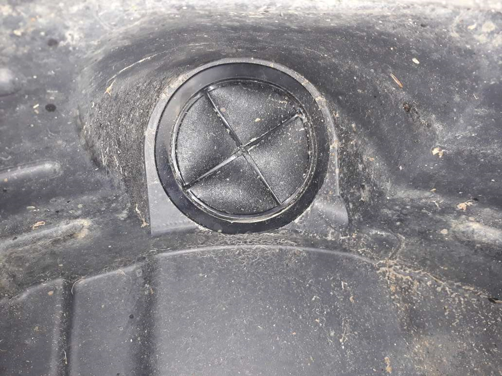

Update: Purchased a 100mm (*110mm outer diameter) rubber grommet typically used for wall/desk cable management for 3.95 EUR, as I could not find the original replacement part (got a 100 EUR quote for the entire wheel arch...). It covers the hole perfectly.
The link for the product is below, but you can probably get if from Ebay too:
Still holding after 500km:
What a brilliant solution to the problem.

I'm not sure which cables you're referring to. There were no cables running through that hole in my 0.9 TA Petrol, 312 4x4 Wild model. If needed, you can easily cut through the grommet with a blade, as it's designed for running cables through.
