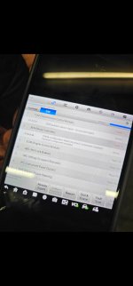

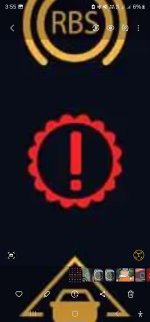

i keep getting the (pictured) red light every time I drive my car, I can't pinpoint what exactly it is that im doing but when the light does show up the gas pedal stops working, it slows me down and while it flashes it says start and stop disconnected refer to the owners manual and then it turns into a yellow triangle and it's gone the next time I turn the car on. I've been to two mechanics now and one just found the error code, deleted it and said that's it. when the light came back I went to the second mechanic and was told its fine to drive on but that it means there's something wrong with the transmission. I don't know what to do, I dont know what it is and I dont feel safe driving. I've been told that it could be something with the gearbox sensor, the battery, the earth straps, or a voltage drop. please help! thank you

I believe the stop/start will deactivate if the battery voltage drops below a certain voltage (what that is I don’t know) and maybe that triggers the warning light you’re seeing? The same can happen with the electric power steering which can also deactivate (steering becomes very heavy) if the battery voltage drops. Your car is 8 years old now - is the battery the same age? If so it might be worth investigating this as a possible (or contributory) cause.

OK, just searched the Feb 2016 Owners Manual and p47 shows your warning sign + text explanation. Seems you need advice from someone who’s familiar with and understands not just these cars but also the Dualogic transmission - you don’t live in the south of England by any chance…?

Omg thank you! I tried to find this in the manual but had no luck! I'm in Sheffield, probably not the south but I've always been bad at geography 🥲

That warning light is telling you the DualLogic (semi automatic) Gearbox is faulty - and that's probably not a battery issue.
It could be low fluid in the auto-changer system, but those gearboxes do seem to be fragile and very expensive to repair once broken. (sorry). Fiat stopped making them a few years back, owing to poor reliability I suspect.
The error code you posted says its just a sensor thats the problem, getting just that sensor fixed may solve the problem. I think you should do this before giving up on the car.
