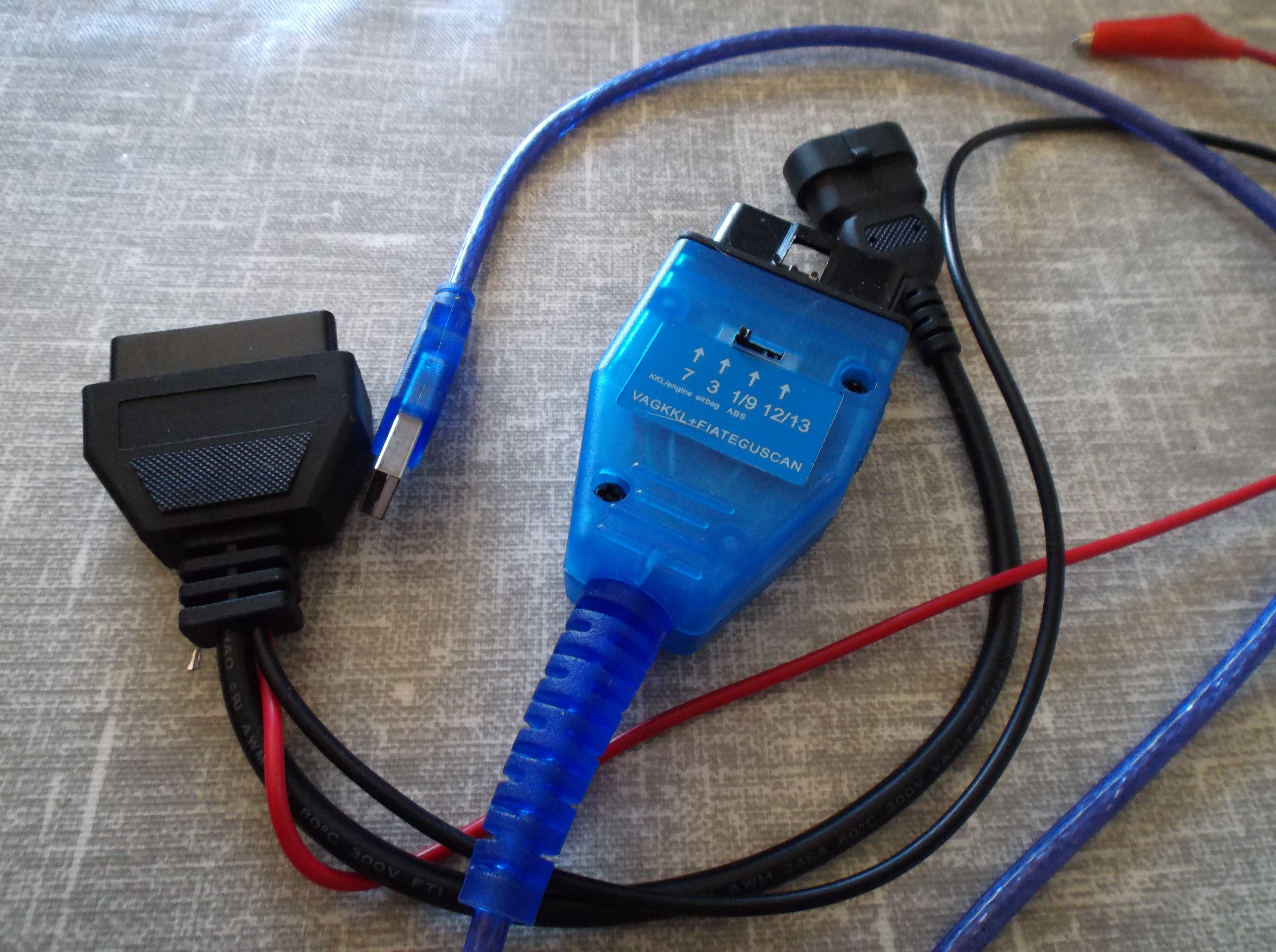

Hi,
This is driving me nuts, I have bought leads to connect to my 2001 2.8 Ducato, Downloaded the Multiecuscan software but all I'm getting is "Can't connect to ECU, check your leads or port settings" I want to turn off the injector light which came on after I knocked out a fuse in the fuse box, van is driving perfectly. picture of leads attached, any ideas on what's wrong? Even changed to a Windows 7 laptop as I was told ecuscan doesn't like Windows 10. Pic of leads attached,

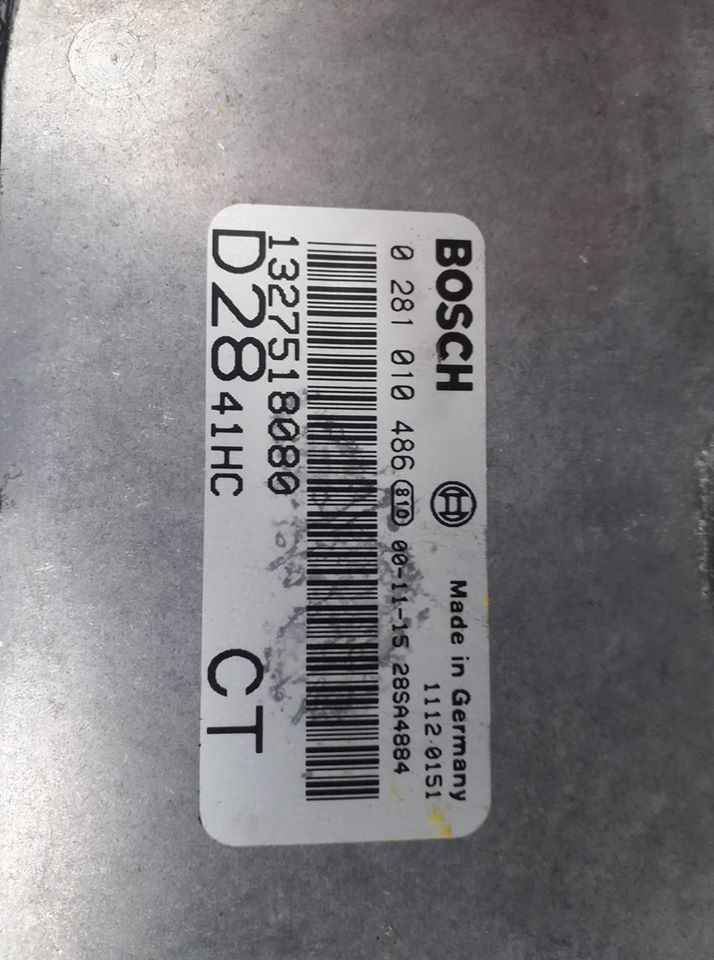

Still nothing, I made up a fly lead with a proper OBD connection as I thought it may be the connection was wrong on the 3 pin adapter, Tried all the suggestions on various posts here, Multiecuscan lists a Bosch EDC 15C7 CF3 for the 2.8 JTD, the ECU in the van is as in the pic, could this be my problem? It's really nuts at this stage! Any help please?

Are you sure you have the correct plug in the bag to connect to?
Also are you sure you got the power connected to the adaptor Which I think you need for the 3 pin cable?
Yes, defintely got the right 3 pin connector, the one with only 2 wires, a centre Black and the other red/white, Yes I have + to the 3 pin adapter. I even made up a new lead in case the connections were bad, The ECU fitted is not the one that comes up on the Multiecuscan list for th 2.8JTD Ducato, I'm wondering if this is the problem.
If MES is connecting but doesn't recognise the ECU, it will state "Invalid ISO code". If you aren't even getting that message, it still suggests a communication problem between MES and the vehicle.
I can only suggest working through pages 19-23 of the MES user guide in detail whilst using the Scan for Interfaces and Test functions in the Settings menu box.
It's saying can't connect to ECU, the one listed on the MES site for Ducato injection is totally different to the one thats in my van! Could this be the problem? I'll try those pages, thanks.
